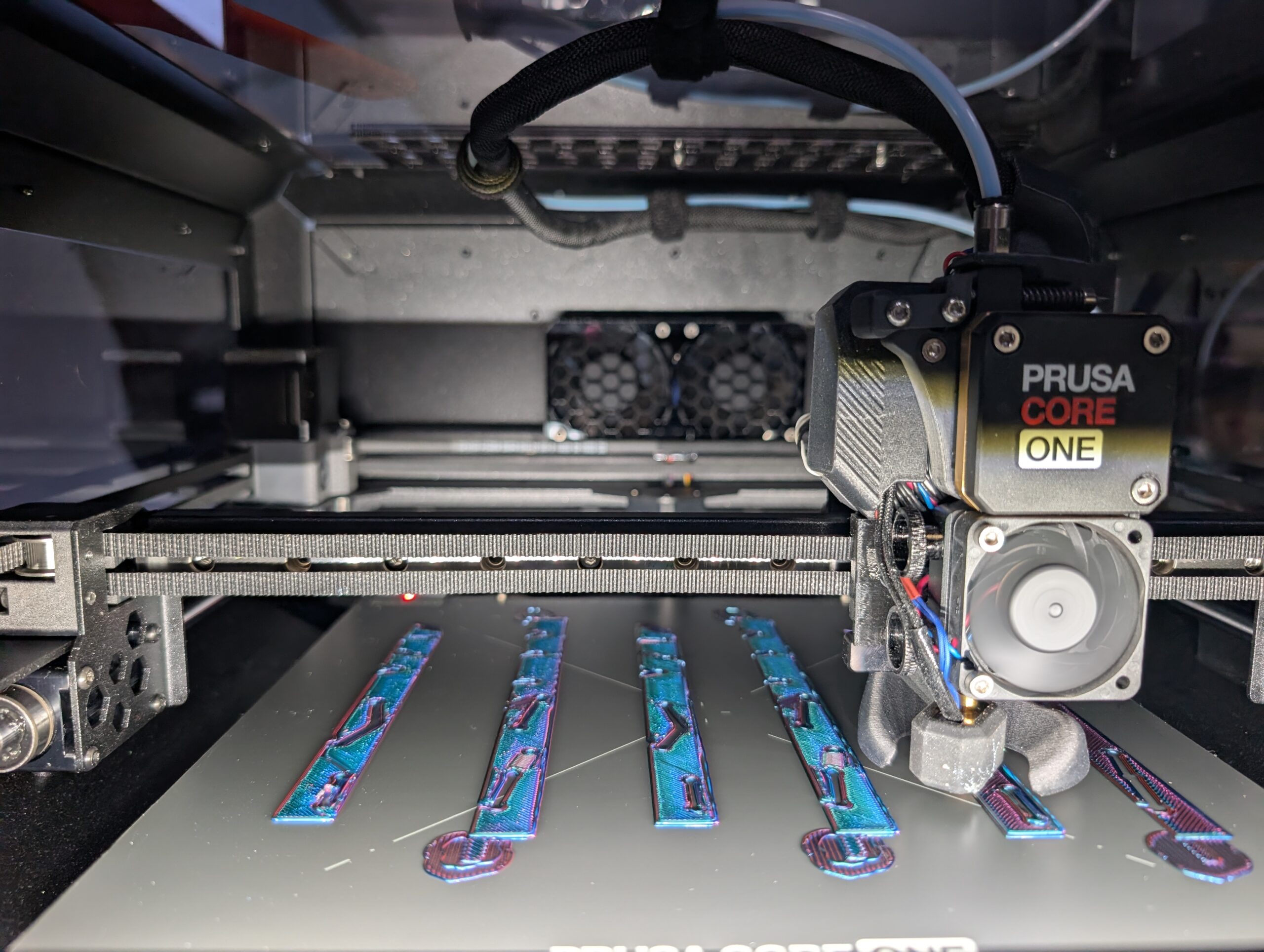

Firmware: 6.3.5-alpha+10514. Layer shift I am having layer shift. It is happening over and over again. I have had the printer running just fine for the past few weeks and all of a sudden im getting layer shift. Not at the same layer either. I have tightened the belts and ran a test print and that came out just fine. Then I change the filament to my specialty filament and run and sure enough i get a layer shift.
Is there any way for me to find out which was the last layer printed and start remove the shift and restart from a specific layer ?
How do you turn on crash detection? It doesnt seem to be showing or i cant find it.
Single material, .4 nozzle .25 layer height. PLA Silk and dont see any warping. NEED HELP fixing please

Is the layer shift always happening in the same direction as in the photo? Wondering if the umbilical cable is sagging and getting between the print head and the X motor housing?

didn't even think of that i will definitely keep an eye out for that. I also saw that I was running 215C on the silk PLA. And on my MK4S I am running it at 225C with no problem. I cleaned the nozzle with a needle and upped the temp and so far so good. But then again the tall print I moved to the MK4 and on the Core maybe one inch in height. So I will keep an eye on it and see. Thank you for the input.

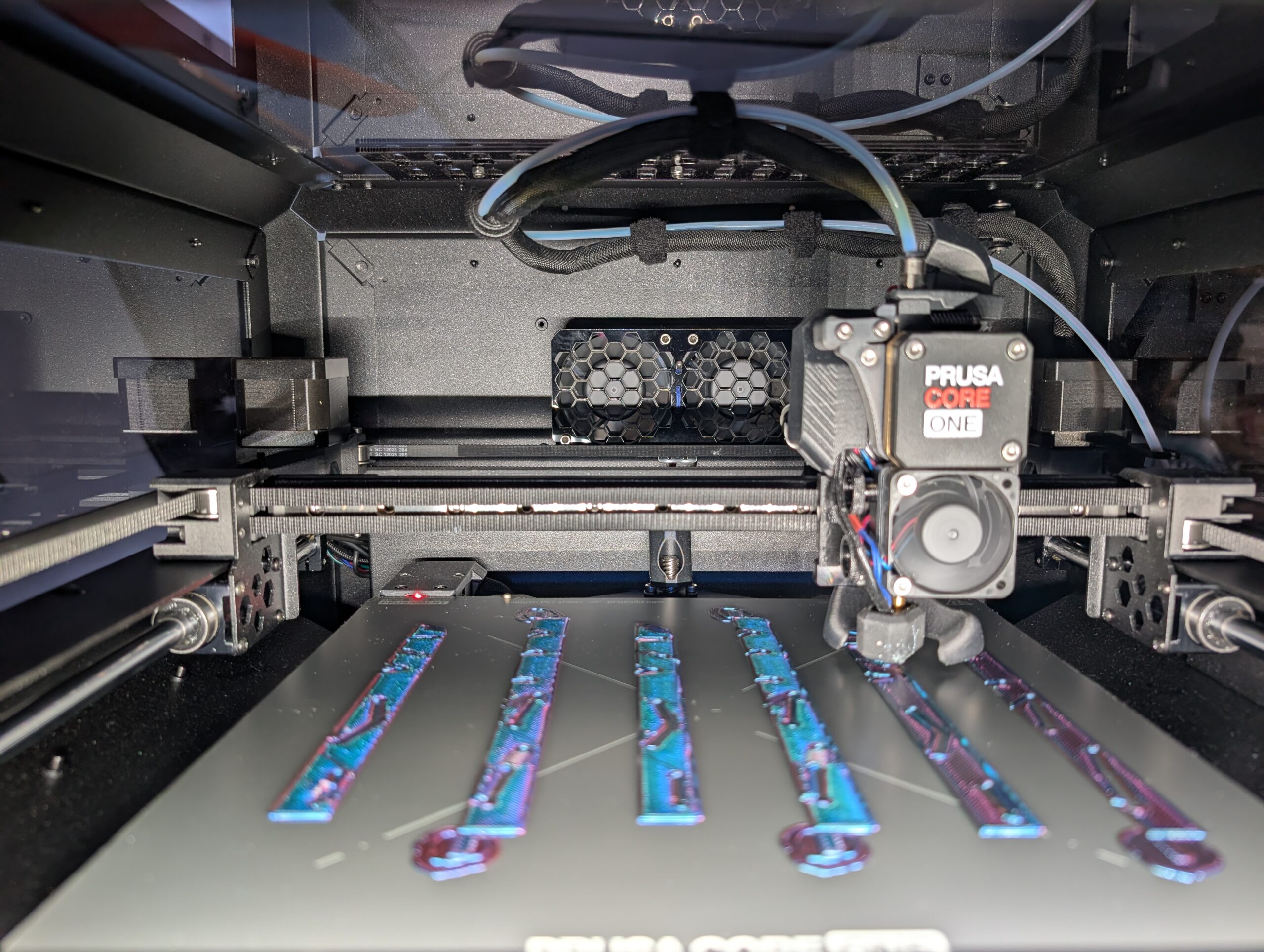

take a look at those pictures, do you think its riding to low ? i think it looks fine but i dont have anything to reference to.
