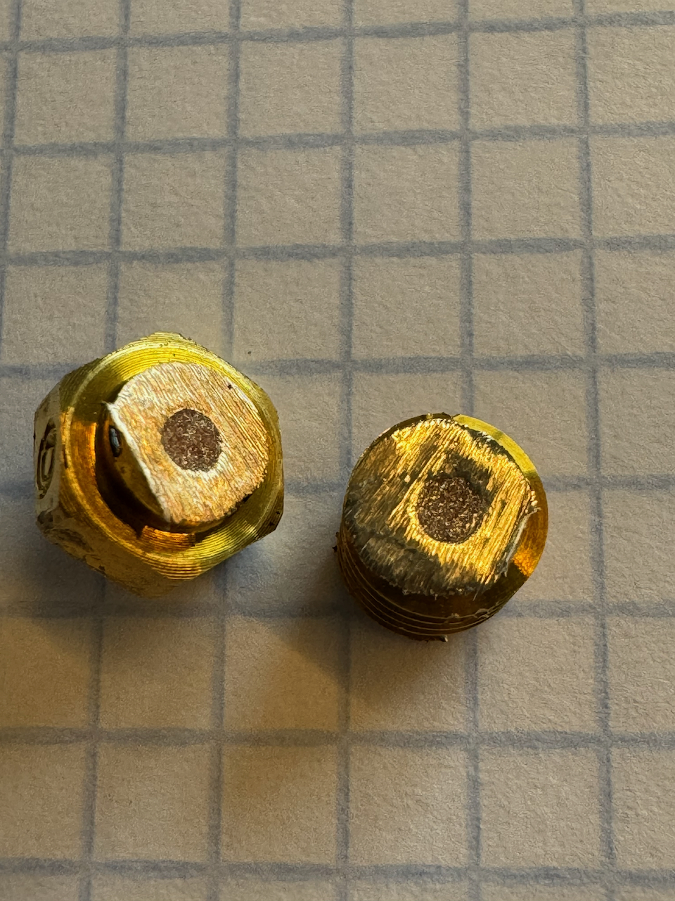

I ran into the problem of a fully clogged 0.4mm HF nozzle on the Prusa CORE One also several times now. Never had that problem on the previous Prusa Printers nor on the XL. Each previous method like cold plug, unload filament > heat to 260°C for 10 minutes, or putting a needle into the nozzle helped.
Possible root-causes:
  1. I experienced that this problem happened after prints that had quite a lot of retractions. That might be a root-cause, also heard that others run into a clogged nozzle on the CO after such prints.
  2. The clogging might also occur if the printer is not cooled down properly after a print i.e. if you turn-off the printer while the nozzle is not cooled down to at least 70°C. That might lead to molten filament creaping upwards  into the HF nozzle part that is not heated by the heater block itself. If that happens the molten filament further upward will never get molten again because of the not existing heater there

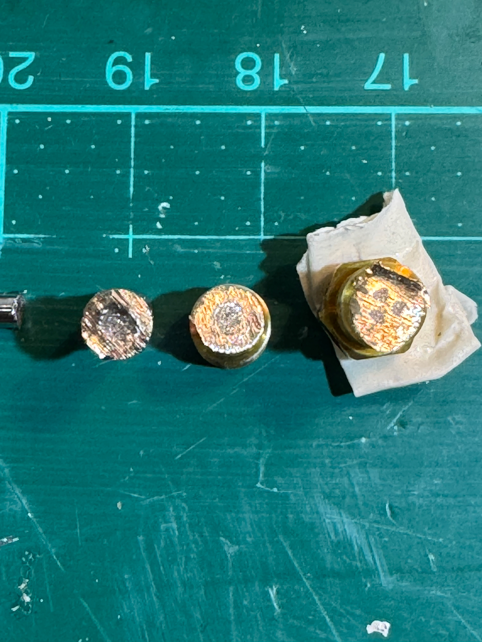

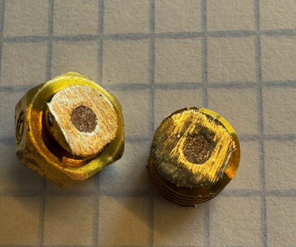

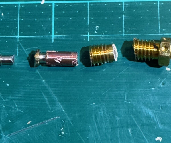

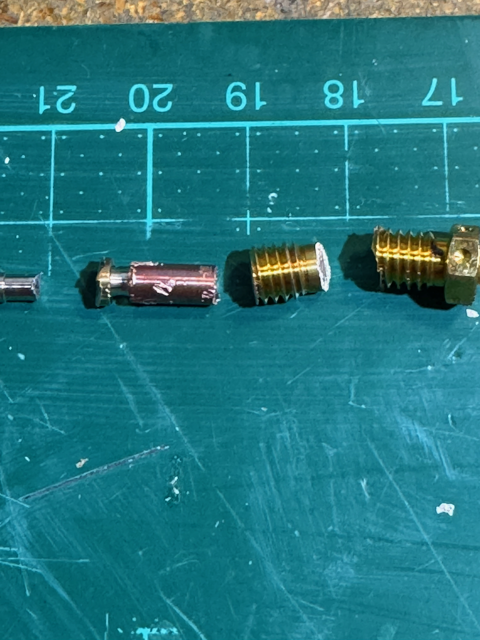

To proof or fix possible root-cause 2) with heat creap of filament upwards, I removed the nozzle. I realized that the clogging was in the brass section below the copper part of the nozzle. Then I heated the whole nozzle manually with a hot gun and tried to pull out any filament residue with a thin drill or by pushing filament into the HF nozzle from top down. Both methods were not successful. Also pushing filament downward towards the nozzle end did not work.
To understand where the clog is I saw the nozzle into various slices. See the pictures attached. Very interesting is that there is a extremely hard clog in the brass that shines metallic but not in colors that I did use before (white and orange). It is very odd and I am clueless where this is coming from.
Any other experiences or ideas from the experts here what happened / where this unsolvable clog is coming from?

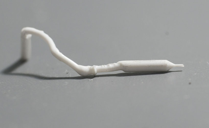

There's a fast fix to this issue:  ditch your HF nozzles and replace them with regular nozzles.
With a regular nozzle a good cold pull shows the conical shape of the nozzle ending with a cylindrical tip corresponding to the diameter (Click to expand the photo below ).  On HF nozzles cold pulls are meaningless because the filament is split into several strands and you can't see the tip of the nozzle, so you never know if the inside is really free from residues.
