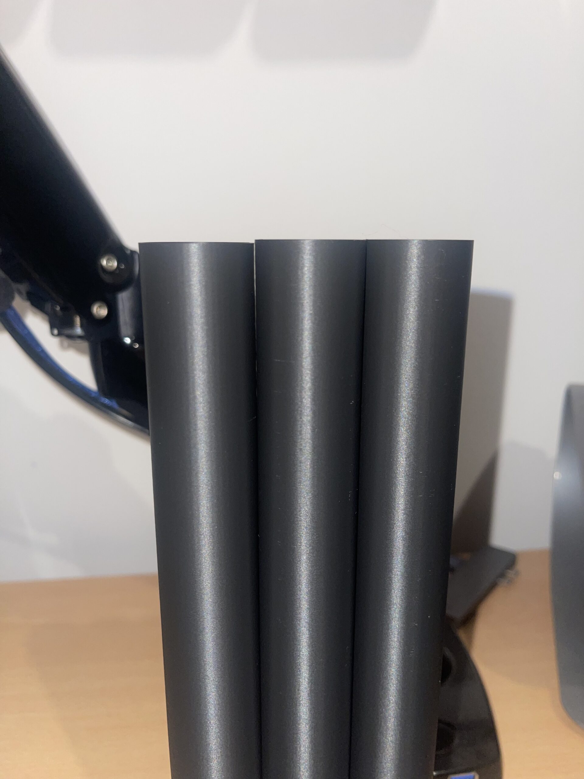

That's my situation I think. I printed 3 250mm cylinders close to the lead screws:
Left is bang on 250mm, rear (centre cylinder in picture) and right are 251mm.
So I guess if you printed the same cylinders you'd have all 3 at 251mm?
If the Z  dimensional accuracy was absolutely critical on a large part, where would you compensate for that?
Opublikowany : 22/02/2026 8:24 am
RE: Different Z lead screw travel between MK4S upgrade screws and Core One kit — 2 mm mismatch
Posted by: @gb160
Yes, that's the result I would expect.
Unfortunately PrusaSlicer does not offer global scaling corrections in the printer settings, which would be the right place to correct for this. So I would have to apply the correction in the print-specific settings (object scale factors in the lower right of the plater view; "unlock" to enable independent factors in X/Y/Z). Not ideal, but at least I can correct the height for critical parts, in contrast to the skew created by the original, differing screws.

Mine was a full kit also, batch one , and I'm 100% affected.
And I too made a tool similar to yours which locks onto all the threads on all the rods, so I instantly dismissed this as an approach....because as I said, I know I'm affected.
Spirit levels dont lie.
The only tool that I could see that would be effective would be a long precisely machined nut covering a good percentage of the entire rod, I'd say 50% of it to be sure. Any drift in tolerance of the leadscrew would result in binding when spinning the nut on. Of course this is out of the reach of the average user, but should be well within reach of the largest 3d printer manufacturer in Europe.
The easiest way for the average user who doesn't want to go down the route of tracing/counting pixels etc would be the 3 cylinder test....just make sure you have a ruler with mm markings to hand.
My 3MF is attached (I think)
All cylinders should be of equal height if your 3 lead screws have matching pitch , all cylinders should be equal and 250mm if your 3 lead screws have matching pitch and are within tolerance.
Calibrate z before running test, and remove any shims or anything else that some people have installed.
I honestly believe that many people have this issue and aren't even aware.
Opublikowany : 22/02/2026 2:30 pm
