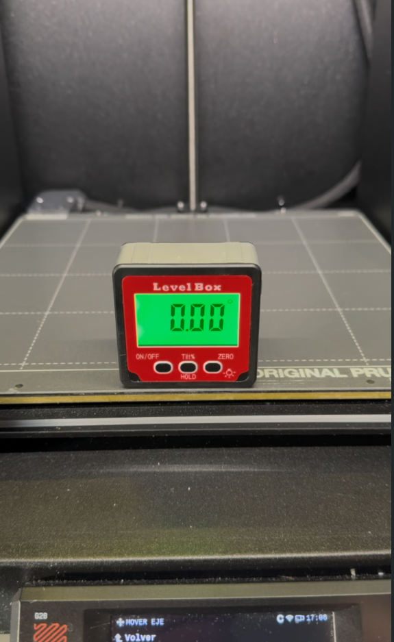

My Core One comes from a MK4S upgrade kit, and I’ve found a mechanical mismatch in the Z axis.
The two lead screws reused from the MK4S rotate exactly the same number of turns as the new lead screw included in the Core One kit, but their trapezoidal nuts move about 2 mm less over the full travel.
To compensate, I had to add a 2 mm spacer at the lower left Z calibration stop so the bed is level near the top of the travel.However, as the bed moves down, the tilt appears progressively, reaching about 2 mm out of level near Z = 0 on the MK4S screw side.
Small prints are fine, but tall prints show increasing layer issues as Z increases.This suggests a different effective pitch or cumulative tolerance between screws.
I’m attaching two photos of a bubble level showing the bed level at the start and at the end of the travel.
Has anyone else seen differences in lead screw pitch or effective travel between MK4S and Core One screws?

RE: Different Z lead screw travel between MK4S upgrade screws and Core One kit — 2 mm mismatch
Oh yes... Here's the original thread about this. The link goes to the post where @pavel-brych has identified the root cause.
Prusa support will send you a replacement lead screw or two, but it takes some back & forth to convince them. Your pictures of the spirit level will be helpful; that's a demonstration they have asked me to provide (in a video, showing the change while the bed is travelling upwards).

Calipers are very suitable in terms of accuracy, but tricky to use here because it is so easy to miscount the threads. And depending on the size of the calipers it may be difficult to fit them in. A nice measuring method has been proposed later in that thread:
Move the bed all the way up, cut strips of paper a tad shorter than the free length of the lead screws and ~ 5 cm wide. Fold a paper around each lead screw and secure it in place, e.g with paper clips from behind. Then copy the thread pattern onto the paper by rubbing with the side of a pencil -- like we used to copy coins as kids.
This will give a distortion-free picture of each lead screw's thread. (More accurate that photos.) You can either measure them manually, after counting off groups of 10 turns of the thread. Or the fancy version, put all strips next to each other on a flatbed scanner, scan them and measure the picture in your favorite imaging software.

The spirit level test is not very sensitive, but it gives you a first idea. You will need to check sideways and front-to-back changes to figure out which screw is off. Personally I prefer the direct measurement of the screw pitches.
You will typically have two identical screws and one with a different pitch. Problem is that Prusa only has one part number; they can't send you screws with a specific pitch.
They sent me one replacement at first, and of course it turned out to have the exact pitch of the odd one out I already had -- so I now had two of each pitch. I contacted support again, asking for one more, which I expected to match either one pair or the other. But that time round, they insisted on sending me three new screws, all taken from the same shelf.

Hi everyone,
Following the discussion about the skewed XY plane, I have performed measurements with a digital inclinometer to quantify the error.
The results are consistent with a lead screw pitch mismatch: I measured a 0.35° slope difference between the top (Z-max) and the bottom (Z=0) of the travel.
For those wondering how this translates to linear distance, here is the math based on the Prusa Core One's bed width (approx. 320 mm between support points):
Error=tan(0.35∘)×320 mm≈1.95 mm
This 1.95 mm discrepancy over the 275 mm travel confirms a ~0.7% lead error. This is not a mechanical assembly issue or a software calibration problem; it is a physical hardware defect where the lead screws have different effective pitches.
I have already contacted Prusa Support with this data. Given that this seems to be a batch issue with the MK4S to Core One upgrade kits, I strongly recommend everyone experiencing "Z-groaning" or layer shifts in tall prints to perform this check.

I don't expect it to cause groaning movement or layer shifts, but dimensional errors of large prints. Unfortunately the problem is not limited to conversion kits, but has also been seen in full kirs and even factory-built printers.

I respectfully disagree that this only affects dimensional accuracy. In a system where the bed moves away from the nozzle, a pitch discrepancy creates a dynamic skew.
The Mesh Bed Leveling (MBL) is performed at the top, but that map becomes invalid as the bed descends and the plane tilts. This leads to inconsistent nozzle-to-layer distance, affecting extrusion quality and layer bonding in tall prints.
Furthermore, this geometry conflict creates significant lateral tension between the rigid linear rails and the tilting bed, which is a primary cause of Z-axis groaning and premature wear on the POM nuts and bearings. It’s not just about the final part being 2mm off; it’s about the mechanical integrity of the printer during the entire process.
