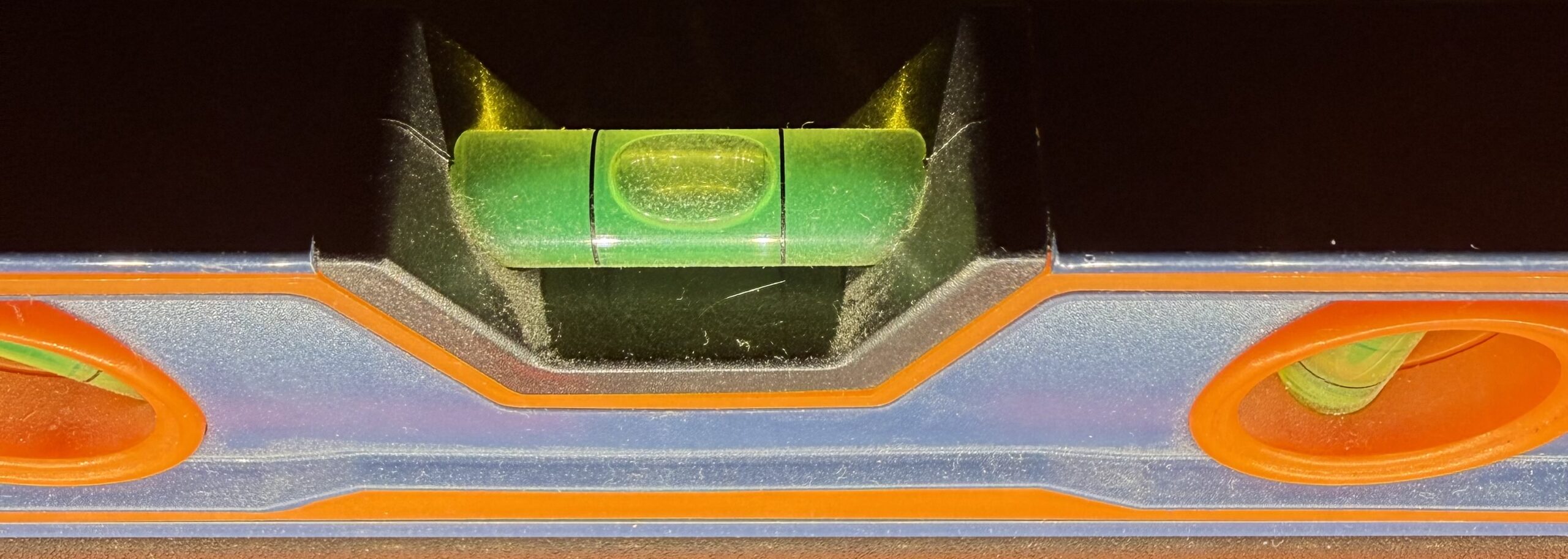

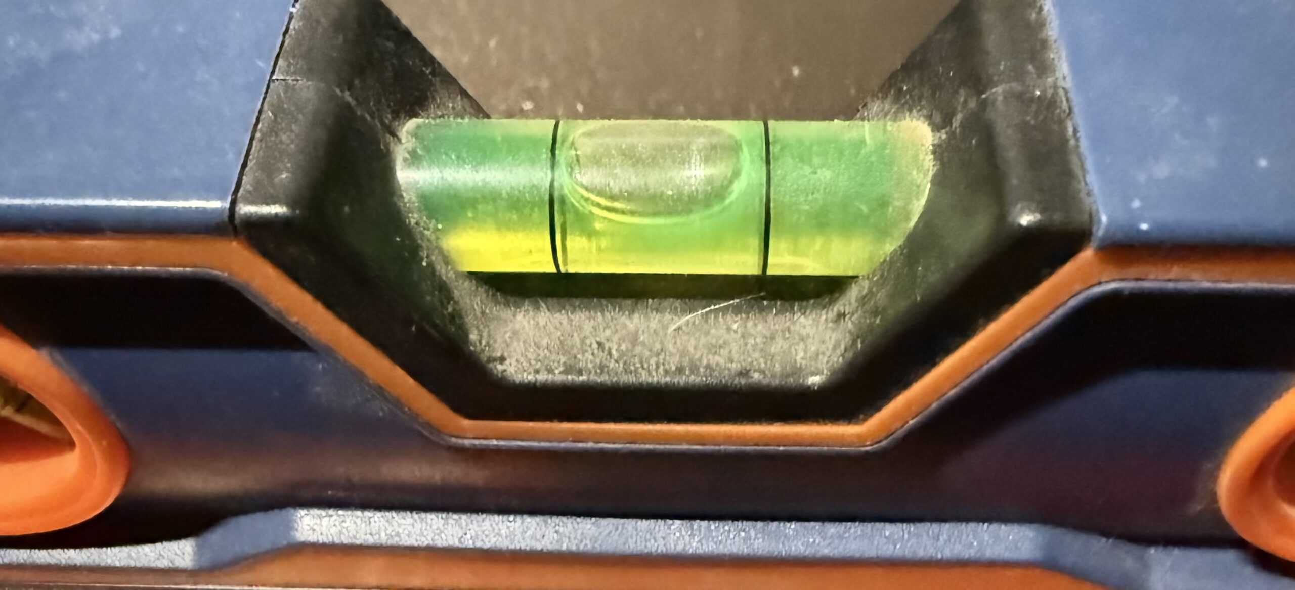

My Core One comes from a MK4S upgrade kit, and I’ve found a mechanical mismatch in the Z axis.
The two lead screws reused from the MK4S rotate exactly the same number of turns as the new lead screw included in the Core One kit, but their trapezoidal nuts move about 2 mm less over the full travel.
To compensate, I had to add a 2 mm spacer at the lower left Z calibration stop so the bed is level near the top of the travel.However, as the bed moves down, the tilt appears progressively, reaching about 2 mm out of level near Z = 0 on the MK4S screw side.
Small prints are fine, but tall prints show increasing layer issues as Z increases.This suggests a different effective pitch or cumulative tolerance between screws.
I’m attaching two photos of a bubble level showing the bed level at the start and at the end of the travel.
Has anyone else seen differences in lead screw pitch or effective travel between MK4S and Core One screws?

Use the display to raise Z to around 50-60 mm and take your measurements.
The comment in the image, "gap will increase as you go higher", is important. There may also be a fixed left vs. right difference due to tolerances in the frame and chassis. To separate it from the effect of unmatched thread pitch, I would do this measurement twice, at two different heights of the bed, say 10 mm and 110 mm below the nozzle. Then the change in the left vs. right discrepancy over 100 mm travel can be determined.

Mine is definitely affected also.
My initial spirit level test is showing almost identical tilt to your images.

Yeah I went a bought a £10 Magnusson this morning, and thats 0.5mm/m
I've been onto support, and the guy was able to confirm what the spirit level showed, through pictures and a video.
I'm waiting for him to get confirmation regarding sending a replacement out...I really cant see how they can dispute it or offer another solution, the spirit level 'evidence' is pretty conclusive.
My main fear is that they'll send out one with the same pitch as my 'odd one out'. I'll cross that bridge if I have to.
So my understanding is that the leadscrew that is out of tolerance (front right in my case) is making the bed travel slightly further than it should compared to the other 2 motors, which in turn causes the tilt?

Following the discussion about the skewed XY plane, I have performed measurements with a digital inclinometer to quantify the error.
The results are consistent with a lead screw pitch mismatch: I measured a 0.35° slope difference between the top (Z-max) and the bottom (Z=0) of the travel.
For those wondering how this translates to linear distance, here is the math based on the Prusa Core One's bed width (approx. 320 mm between support points):
Error=tan(0.35∘)×320 mm≈1.95 mm
This 1.95 mm discrepancy over the 275 mm travel confirms a ~0.7% lead error. This is not a mechanical assembly issue or a software calibration problem; it is a physical hardware defect where the lead screws have different effective pitches.
I have already contacted Prusa Support with this data. Given that this seems to be a batch issue with the MK4S to Core One upgrade kits, I strongly recommend everyone experiencing "Z-groaning" or layer shifts in tall prints to perform this check.
