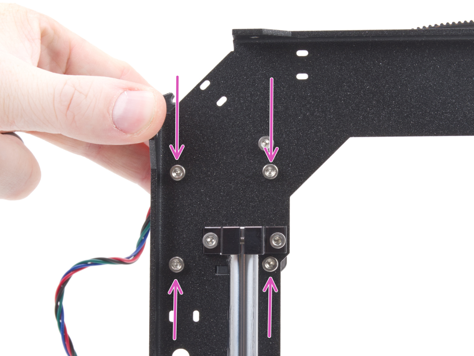

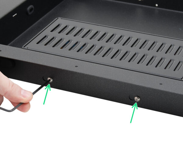

I'm happy to share pictures. I actually meant to take some while I had it apart but completely forgot in my haste to get to testing. I've got a busy next couple of days coming up so it might be a few days before I can pull it apart again. Those plastic rivets are a huge pain in the butt.
For what its worth, I didn't mess with the screws visible on the top of the stepper. I used the mounting screws on the bottom of the stepper. There's four M3x35 screws that hold the stepper, face down, onto the printed motor mount. Here's a picture from the assembly guide that shows the ones I'm talking about:
I removed both side panels so I could get access to the screws shown above towards the rear of the Core One. When the gantry is installed in the Core One these screws are facing down. I removed one screw, slotted it through the hole my old MK4S heatbed cable and reinstalled it in the hole I removed it from.
I connected the other end of the cable to either the key-hole screws holding the power supply to the back cover, shown above. On the other side I used the key-hole screws holding the xBuddy box in. These screws are only visible with the side panels off because they're hidden behind the rear angled corners. I didn't muck about with the existing chassis grounding cable or connectors.
I know all that doesn't make a lot of sense without pictures of it. Ill try to get some taken soon.

Here's three pictures of how I handled grounding the stepper housings on my Core One.
This is the X-axis stepper motor on the left side of the printer when looking at it from the front. The camera is looking up from below with the left side panel removed. You can see the plastic top panel in the background. The green arrow shows which screw I removed and attached the old heatbed cable to. I used that cable because it has ring terminals on both ends. I reused the same screw and there was enough length to still secure the stepper motor even with the ring terminal on it.
This is one of the xBuddy box mounting screws, also on the left side. This is the other end of the above mentioned cable. Again I reused the screw here and still had plenty of length left over to secure the xBuddy box.
This picture shows an overview of both of the above photos. The stepper motor and the xBuddy box with the wire connected between. There's a decent amount of spare cable here so I shoved the excess through the hole with all the other cables you see there. When I was all done I verified continuity between the stepper motor and the chassis ground using my multimeter. I repeated this procedure on the right side to ground the y-motor stepper housing. It looks basically the same so I didn't take any pictures of that side.
Again, this isn't the only way to ground the stepper motor housings. You could (in theory) simply remove the screw shown in the first picture, sand off, or somehow remove the powder coat from the gantry down to the bare metal and reinstall the screw. That should be enough. A toothed washer might also work if tightened enough.
