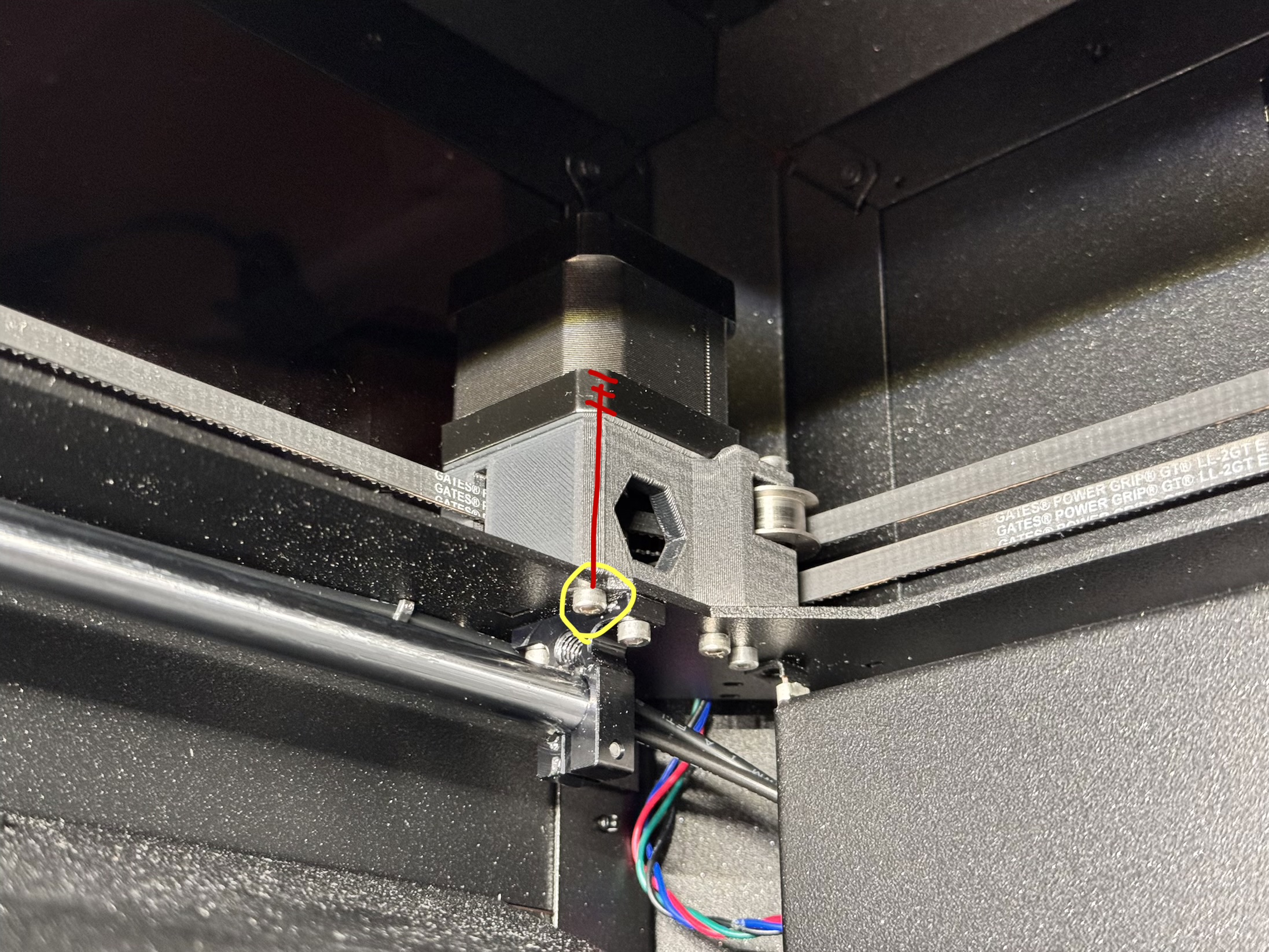

nforester
(@nforester)
RE: Core One crash/restart
Sure.
I have used this screw , it goes up all the way to motor (marked with yellow).  Removed a bit of powder coating under screwhead. If you have a multimeter then I would check Y axis also.

Tim
 Tim
(@tim-21)
The fix is installing inside star washers on two screws, one on each motor. All that grounding the earlier post talks about is not needed. The Extruder carraige is already properly grounded. So all that needs to be done is to ensure the X and Y motor cases and connected to that frame.  The issue is the powder coat paint is thick, and it's common for it to insulate the motors. Arcs happen, and the printer resets.
This is my left motor. I did the same to the easiest to access screw on the right motor.
Posted : 29/11/2025 6:20 am

This is an interesting thread and whoever identified the fix needs a shout out of recognition, it was good work.
Having looked at what is going on, the fix works because it is stopping charge build up in the stepper motor, rubber belts are well known for charging materials up through the triboelectric effect and is serious risk in bulk material handling. In the Core One I believe the ungrounded stepper is creating a capacitor between the body and the mounting chassis with the plastic spacer acting as a dielectric. The fix basically shorts out the capacitor preventing it holding charge.
For me, powder coat, paint, etc over mounting holes isn't surprising, it just isn't on the radar of the mechanical engineers as masking off these areas just costs money and adds complexity so the stepper motor grounding is just pot luck, it may happen it may not.
The link between long x-y transitions and the reboot issue but not happening with short transitions is because the longer transitions are able to generate more charge, I think the coupling path for this is down through the stepper motor into the driver. The motor rotor and chassis are one electrical part, this gets charged and basically sparks over to the board inside the motor and down the cabling into the controller causing the reboot. I can imagine if Prusa haven't already fixed this, the Core One L will suffer this problem but on a bigger scale.
