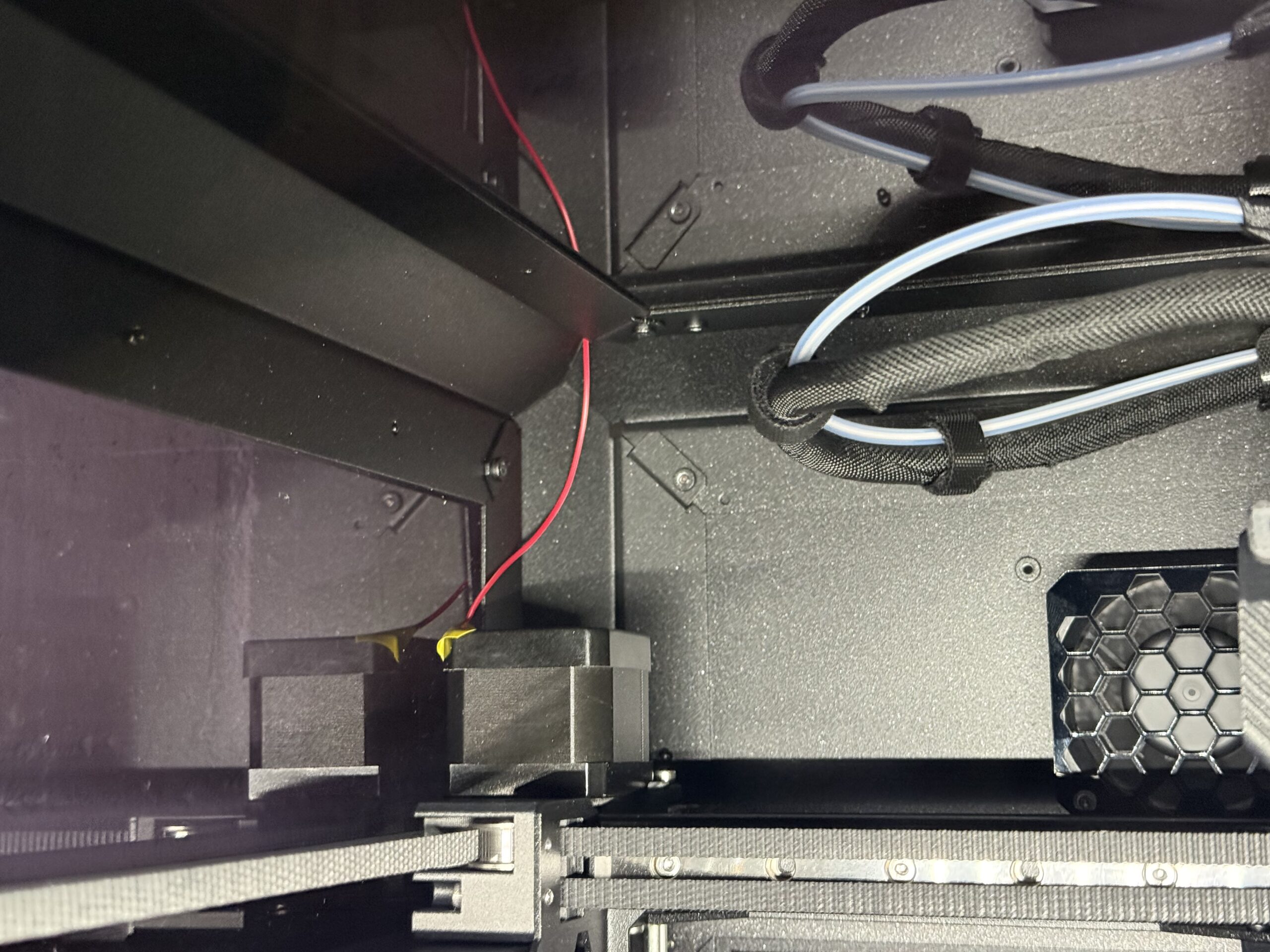

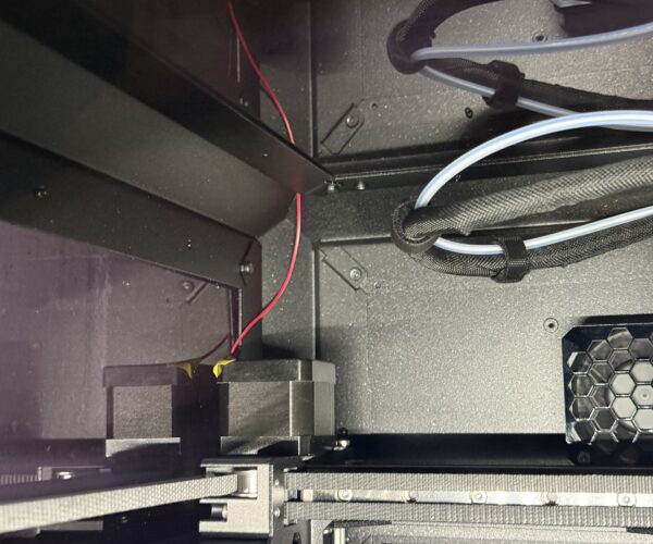

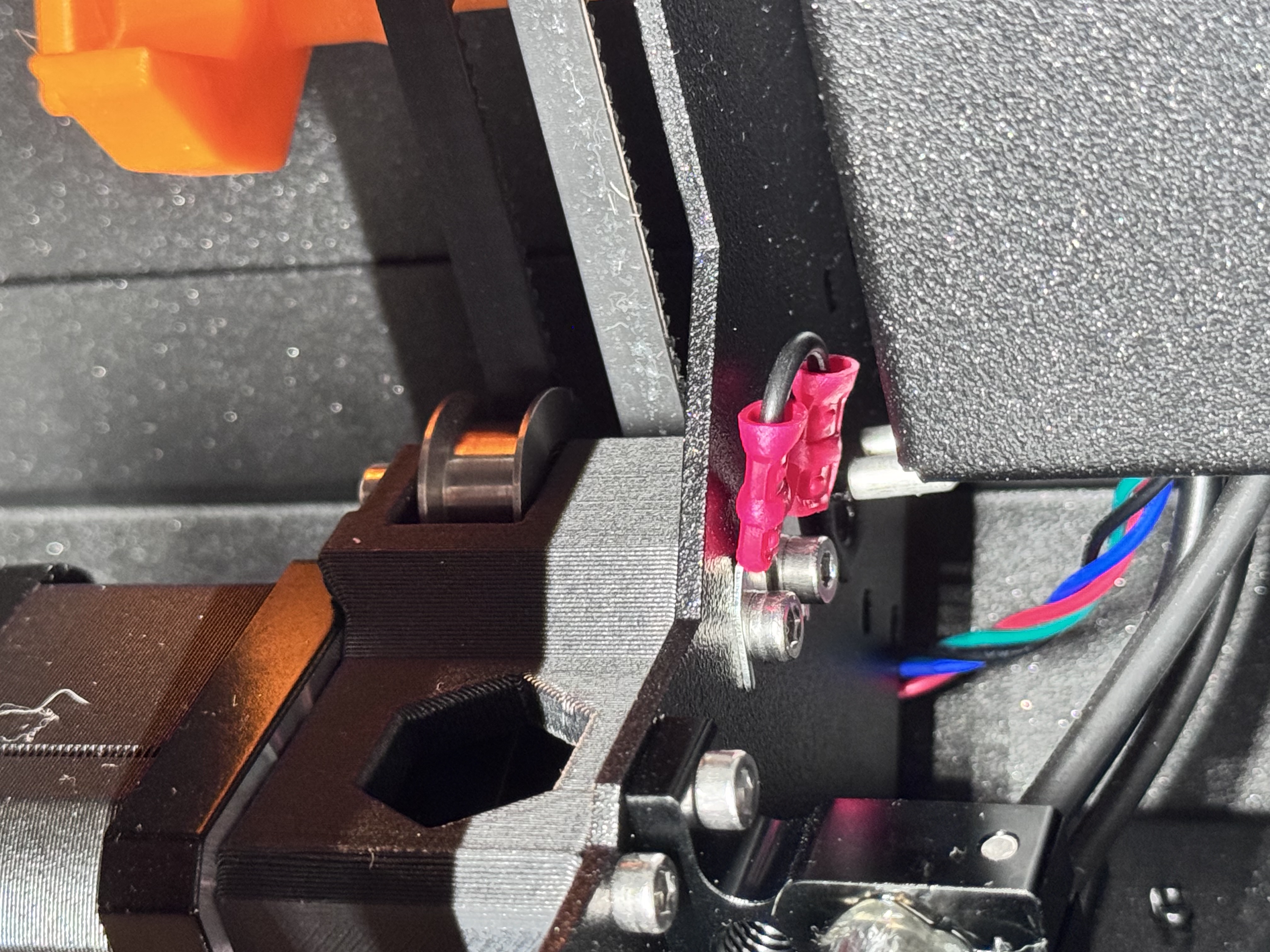

Thought I'd share my version of the fix.
Firstly, I haven't actually had any reboots (that I noticed). But I confirmed with a multimeter in continuity test mode (it beeps when there's continuity which is very convenient) that my left XY motor wasn't grounded. The right XY and three Z motors were all grounded. So I figured I should pre-emptively ground my motor.
I wanted a quick fix so decided to use spade connectors - these allow you to just loosen a screw and slide in the connector without having to completely remove the screw. My spades were bigger than M3 but fit under the screw heads well enough. The thickest wire I could find is still a bit thin but stranded coper at least, and I checked continuity once crimped before installing. I found 2 screws at the back right of the motor - one that connects to the motor and one that is grounded. Hence I was able to make my grounding wire short, neat, and easy to install.

Indeed a nice, clean solution for those that do not want to scratch away a little of the coating. Even if this works for you (tested with multimeter) I wonder if the "grounded" screw is so by design or simply because, when inserted, it randomly scraped the coating from the thread thus making a connection with the frame. In the latter case it would not work for everybody...
Posted : 31/10/2025 12:43 pm
That screw just behind the four motor mounting screws goes through a through-hole in the CoreXY frame and is screwed into the plastic mounting block for the motor. So you can't rely on it making contact with the CoreCY frame: Just like with the four motor screws, it will only do so if there is a gap in the powder coating inside the through-holes and the screw touches the frame in that spot.
For a reliable (i.e. available in all printers) ground connection one would need a screw which is actually screwed into the grounded CoreXY frame, preferably with a self-cutting thread. But I don't think there is any nearby. So the ground lug near the left-hand motor is the best connection point for a jumper cable. Or just scrape off some powder coating under a motor monting screw, which is still my personal preference.
Posted : 31/10/2025 1:34 pm

Thanks @chmax that's important feedback. There are some clear pictures of those holes in the assembly manual, and indeed the "ground" screw I chose goes through an unthreaded hole which appears to be powder coated. As you say not a good choice for others to follow! The Y bar ends do screw into threaded holes so they're better (just checked mine and they are grounded) but a they're an awkward shape and I'd worry about clearance. So any of the other threaded holes people have already suggested would be best.
Looking at those picture both left and right motors seem to use unthreaded holes so I wondered why most people seem to only have issues with the left... but looking through the thread I did see someone have an an ungrounded right motor too. A star washer and powdercoat scrape on both seems like the most robust solution; I may go back and do that at some point I just don't have any star washers and the scraping seems awkward. I'll wait 'til I upgrade/service something else in there.
Good news though is all these screws are under tension from the core-XY belts so if someone's motor is already grounded that's unlikely to change.
Posted : 31/10/2025 2:19 pm
