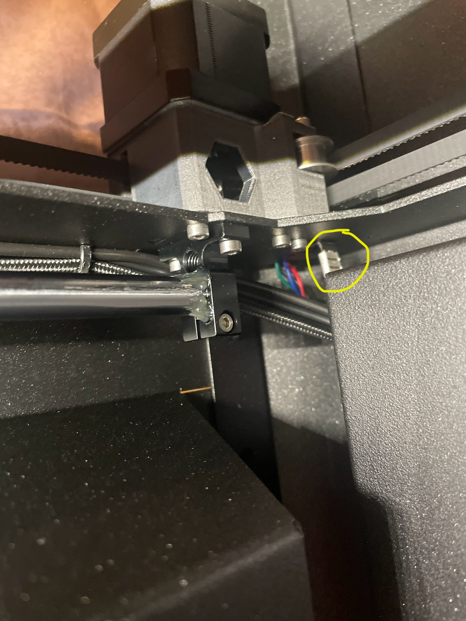

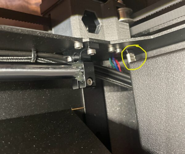

Michaël
(@michael-42)
RE: Core One crash/restart
Hello,
I have a question about grounding.
Do you think it would be safe to connect a wire from this screw to the cable shown in the circle on the photo, in order to improve the ground?
Or is it a bad idea and could cause damage?
Thanks a lot for your advice!
Publié : 16/09/2025 8:48 am

Michaël
(@michael-42)
I scratched the paint and checked with a multimeter, everything looked fine. But guess what – when I thought it was fixed, it actually wasn’t.
The printer still crashes. So I wasn’t as lucky as you, and I’ll have to send it back.

Tim
 Tim
(@tim-21)
Membre
Posted by: @mmmachnik
Was in the middle of a print and the Core One just started crashing every couple minutes. Contacted support and the guy wanted to critique material temperature settings and using MMU for single color prints. Irrelevant!  If the printer turns out then the temperature seemed adequate. It also seems very stupid to have to manually load filament through the MMU when printing single color when I can just paint in the slicer.  it prints without issue. When questioned about how those things would cause the printer to crash he had no answer. I wasn’t touching the printer so static discharge seems unlikely. It seems gcode related. It hasn’t done it on any other file before or since. Prusa Claims to have GREAT support but twice now they have been useless.
There are issues related to certain Slicer settings: one that has been problematic is Avoid Crossing Perimeters. If this is checked, the printer may make abrupt moves that cause layer shifts. Another issue has to do with Arc Fit being set on or off. Seems that can also cause abrupt head moves.  These don't appear to be what you are dealing with.
The ESD is most likely belt related, static builds up during long diagonal moves, and the goal with grounding the motor cases is to provide a short path for the charge building up on the belts through the motor bearings to the chassis back to the Earth at the power supply.  You can check your printer by measuring for continuity between the top of the X and Y motor cases (any unpainted area, or sometimes the motor shaft), to the spade lug in the back left corner underneath the extruder frame. If this resistance is higher than a few ohms, you are probably subject to this anomaly.
I never had the issue until I printed the sample Rocket Engine ... and it failed every time within the first centimeter. Added the lock washers to X and Y, and the next print finished without incident.

Tim
 Tim
(@tim-21)
Membre
This is the front most accessible screw on the left motor of my printer, do the same for the right hand motor. This can be done without removing anything. Just be sure you scrape the paint away under the lock washer.  I used a flat pilot drill and had to remove side covers for vertical access, but an Exacto knife with a chisel blade would work just as well. A few have reported success just placing the washers, without scraping off paint.
Parts required are two 3mm Internal Star washers. External stars might work, but internals are more likely to pierce the paint.
Since you have a part known to excite the problem, the fix is immediate and appears to be permanent. You'll be able to test for success instantly.
