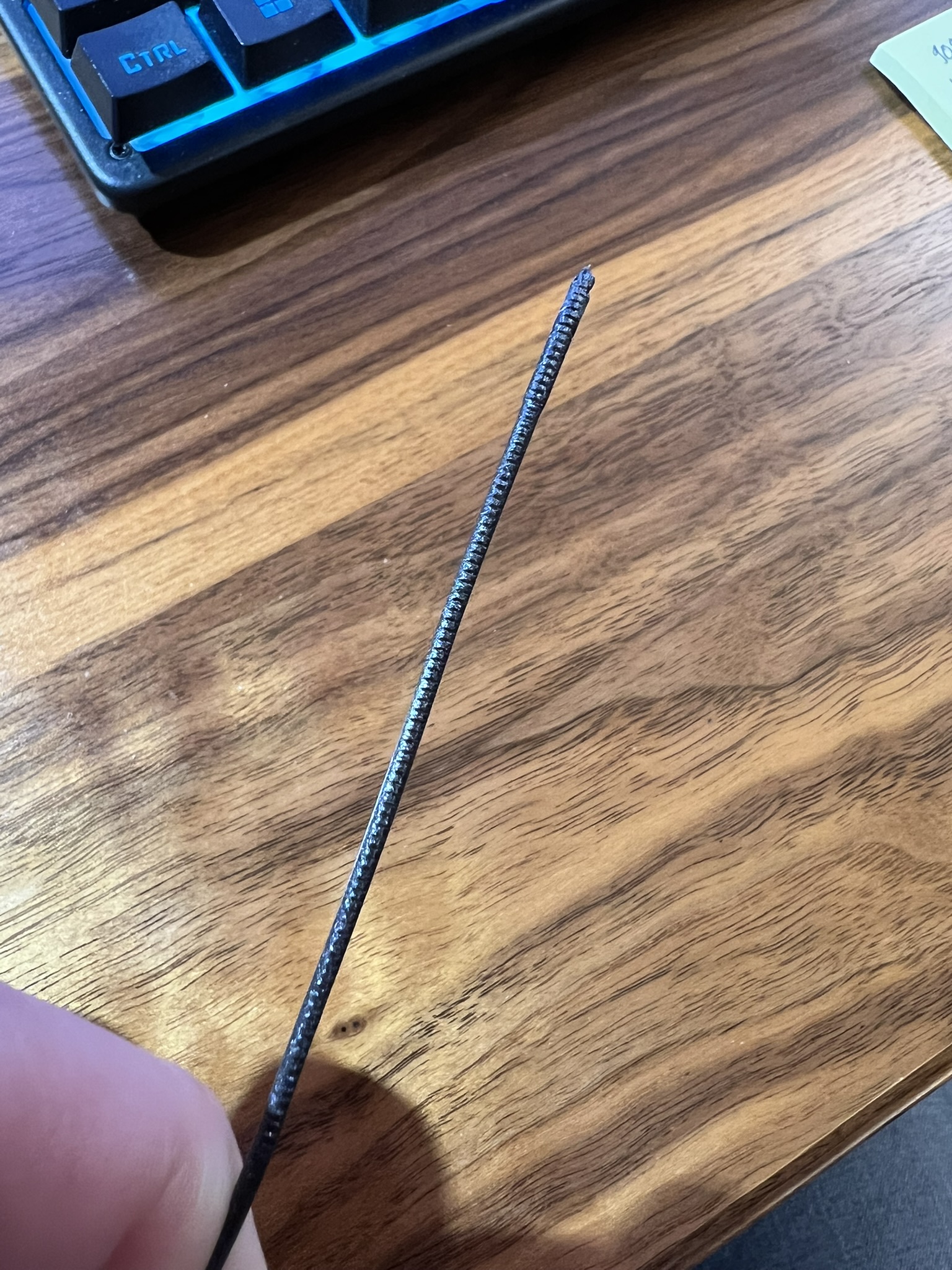

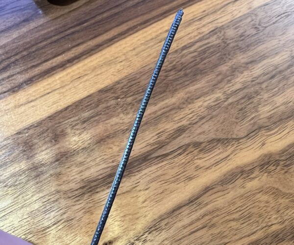

The last four PLA prints I've tried (I've only printed PLA so far) near the end I start hearing a clicking coming from the extruder (gears I assume) and the PLA stops extruding. The filament spool spins freely so it's not getting hung up there. I purge the nozzle and then unload the PLA and notice some ridges on the PLA where it was in the extruder. I clip off the end and try again and it gets most of the way through a 30 minute print and the clicking starts again and stops extruding. This is my first 3D printer so I'm new to tuning the machine. I tried increasing the idler tension screws, but the problem still occurs. The first 10 hours of printing worked just fine. Any suggestions on what I can look at next?

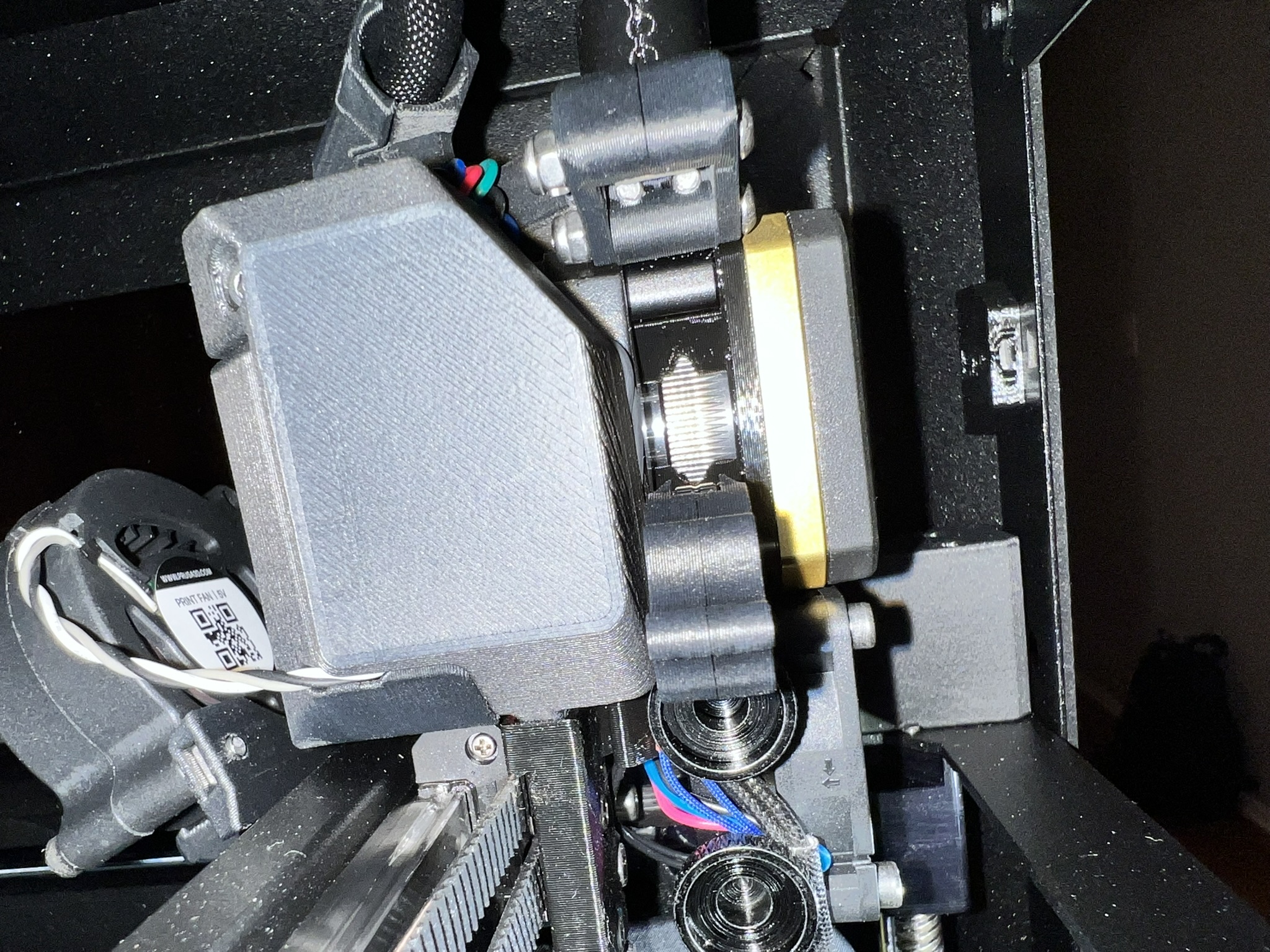

An update: I tried again and the prints are failing pretty reliably at about the 7/32" height (that's when the clicking starts) which is just under the finishing height of 1/4". I've set the print layers to 0.15mm and infill to 20%. Below are pictures of the extruder (as far as I know, looks fine) and the filament after unloading after the clicking starts and extrusion ends. I don't know if the ridges I see on it are normal or a sign of slipping. And I recording a few seconds of the clicking shown in the video.

Are you using high flow printer profile in the PrusaSlicer? The default 0.4mm CHT brass nozzle is high flow. If you don't use HF profile, you may have these issues.

As a sanity check, are your chamber fans running and is the ventilation grill opened? I had similar issues when I willingly turned the chamber fans off to minimize noise. That leads to heat creep which can lead to a clogger extruder with PLA.

A little advice after experiencing clicks and "partial clogging":
Default Screen at the Core One -> Settings -> User Interface -> Footer -> Item 5 -> Select "Heatbreak".
This will show the heatbreak temperature in the bottom line of the Core One at all times.
For me, with the vent open, door closed, printing an extra squashed first layer (Z = -0.04 in Prusa Slicer), the heatbreak temp. creeped up to 39°C and the backpressure on the nozzle became too high for the extruder gear.
Solution: Prusa Slicer -> expert mode -> settings -> filament -> Custom G-code:
Change "M142 S36 ; set heatbreak target temp" to "M142 S32 ; set heatbreak target temp".
My heatbreak fan was only running at 70%, so there was some headroom to cool it more.
I also slightly opened the door for the first layer, dropping the heatbreak temperature to 34°C, no clicking at all.

Yes, exactly. It's just flow resistance vs extruder grip at higher heatbreak temperatures, which can become critical, when the heatbreak doesn't get enough/cold enough air flow.
I looked into the details, because although I could hear some clicking every few seconds, the filament was still flowing and the clicking stopped, when starting the second layer.
In my case, I manually caused this by using a negative Z-Offset, but it might be an issue for some with the Core One even with standard settings.
