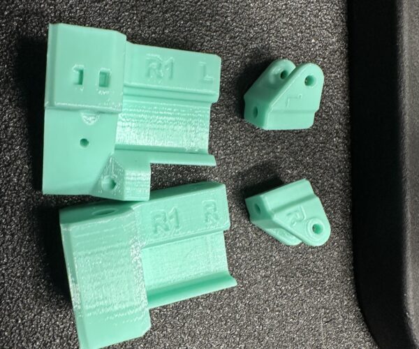

for me, i overtightened when i was assembling my kit and the tensioners also seized up. I ended up printing out those very parts in petg while waiting for replacements to arrive. I ended up taking two of the mounting screws to use for tensioning and used two other non-prusa m3x30 screws i had laying around for mounting.
btw if you dont want to wait, im still using those petg parts and its been working fine. of course i have not printed anything beyond pla and petg yet so cant comment on its functionality with abs or other higher temp filaments.

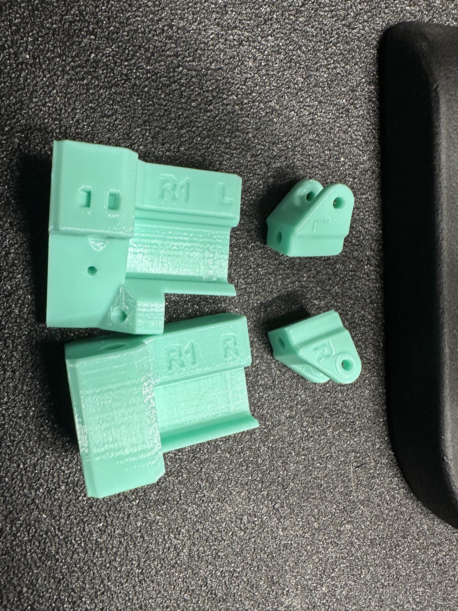

pics below for reference. I actually printed three more sets just in case. i can send a set to you it you want? i printed them with something like 70% infill and 7 walls to be safe lol

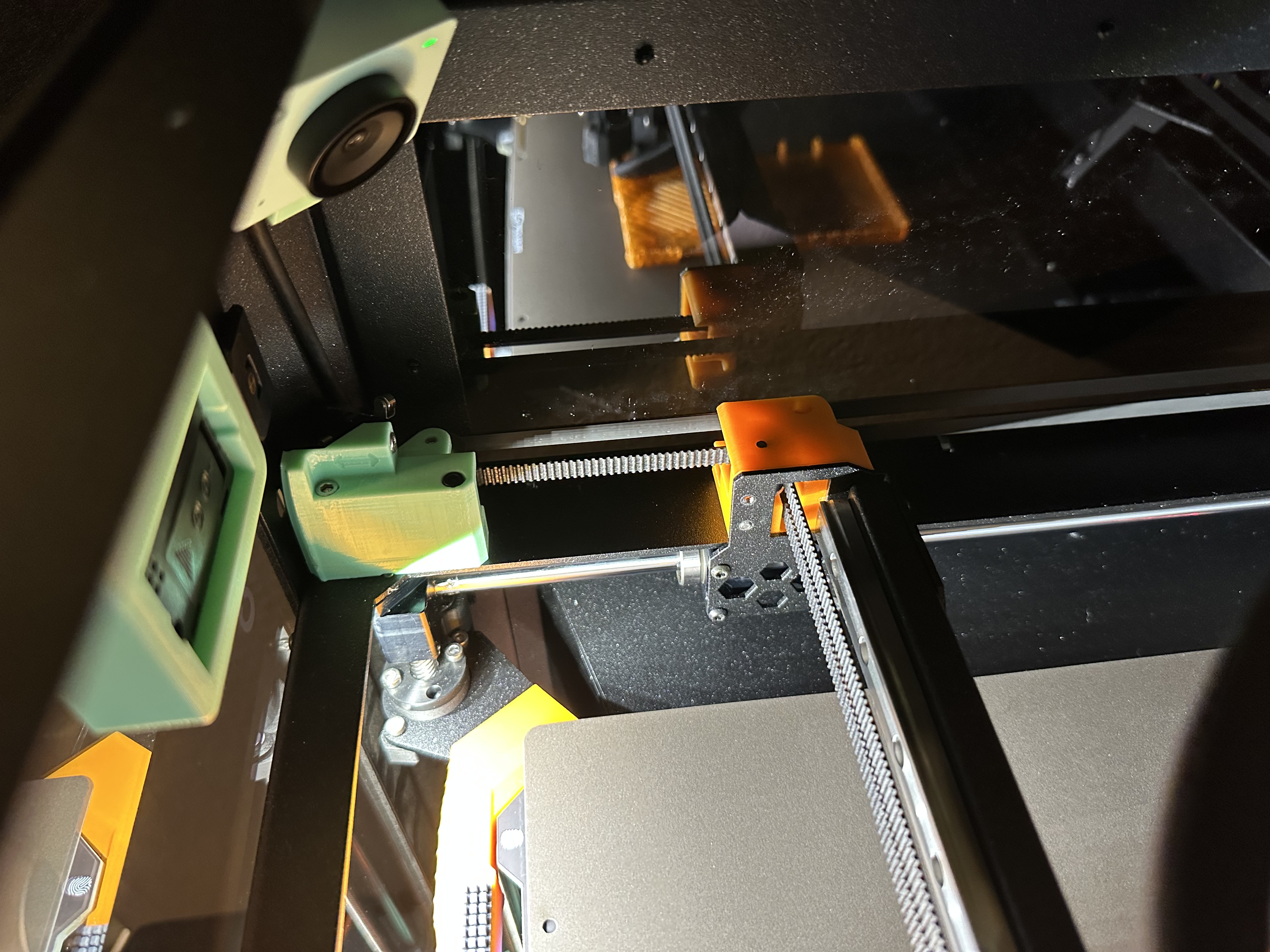

The screw looks like this from forcing the rotation to remove the nut. It was fine when I assembled it, and worked fine to initially tune the belt tension.

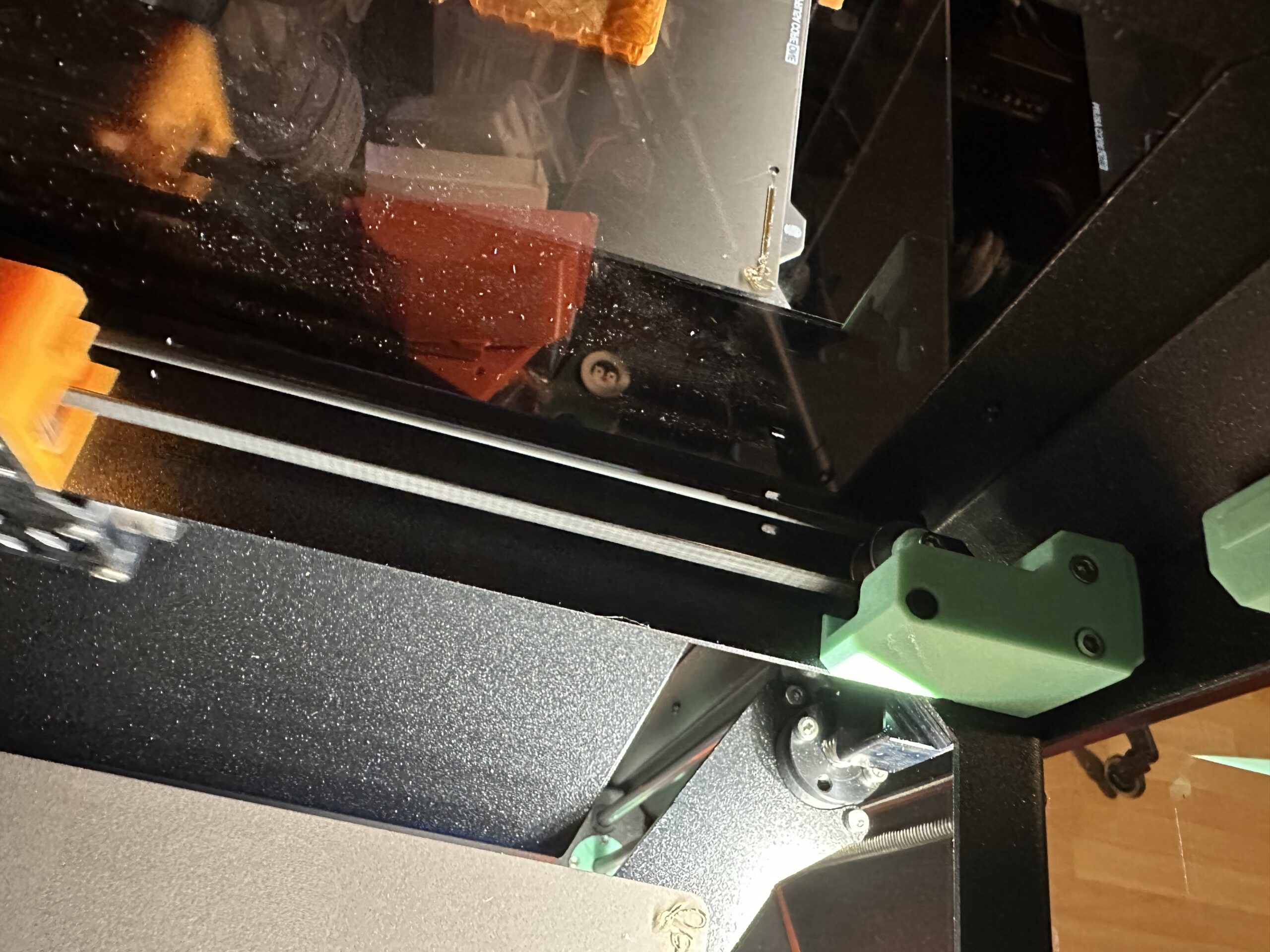

The belts are mostly still in place. I had to remove the top of the frame and the front left corner frame rail to access the left-side tensioner screws because the door-switch blocks access to one of the screws from above and had to also be removed. Sort of like when all you need is that one spark plug, but getting to it means removing the alternator, which means removing air filter box, which means removing the 12v battery- lol!

You can pretty much replace in-place. The only tricky bit is the door sensor if you’ve finished assembly like I did. Just needs patience and many small turns of the allen wrench in a tight space though. The only thing to keep in mind is that you have to screw the actual idler pully to its holder with the belt looped through but that is very easy to do.
