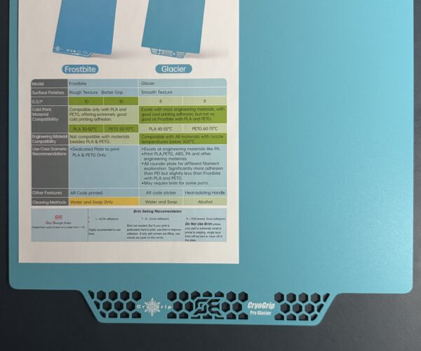

Picked up one Cryogrip Glacier from Amazon after reading the sale campaign here 🙂
Unfortunately I got quite disappointed, couldn't even get PETG to stick at all.
Nozzle cleaning procedure was almost a never ending story, it did twice as many cleaning attempts than usually.
During the bed leveling sequence it made these extra checks for every point, it's like these small grains are at different height.
Only done one try so far.
I have no problem with Prusa powder-coated spring steel sheet.

This is how it looked.
The surface feels a bit like very fine sandpaper.
After the first try I cleaned it again with hot water and washing up liquid but it behaved the same again.
Ill take a chance with the one you linked to earlier in the thread, Ill use this one to serve drinks on at the next party.
Gert

Posted by: @gertl
Interesting, My plate feels the same (like fine sandpaper). Maybe you just happened to get one with a manufacturing defect? Don't know how Amazon works in Europe but in the US they are very accommodating when it comes to returns and exchange.
Posted : 03/03/2026 6:17 pm
GertL
(@gertl)
RE: The Cryogrip Pro Glacier plate is an excellent cheaper alternative to the Satin plate with one minor caveat on the Core One
Looked from where I'm ordered, it was from your link in this thread.Im puzzled.
I'll ship it back and ask for refund and reorder.

as an FYI, it seems that the plates have changed to some extent and that I’m finding they now make a smooth plate as opposed to a textured plate from before… And the ones I had the best use out of were their textured plates, which seemed to be a different generation or build than the current plates.
Posted : 03/03/2026 6:33 pm
Posted by: @gbmaryland
There are the Glacier and the Frostbite with the later specifically for PLA and PETG. I noticed that now they have a series of orange plates which I've been meaning to look into. I think they might be the same, just not teal.
