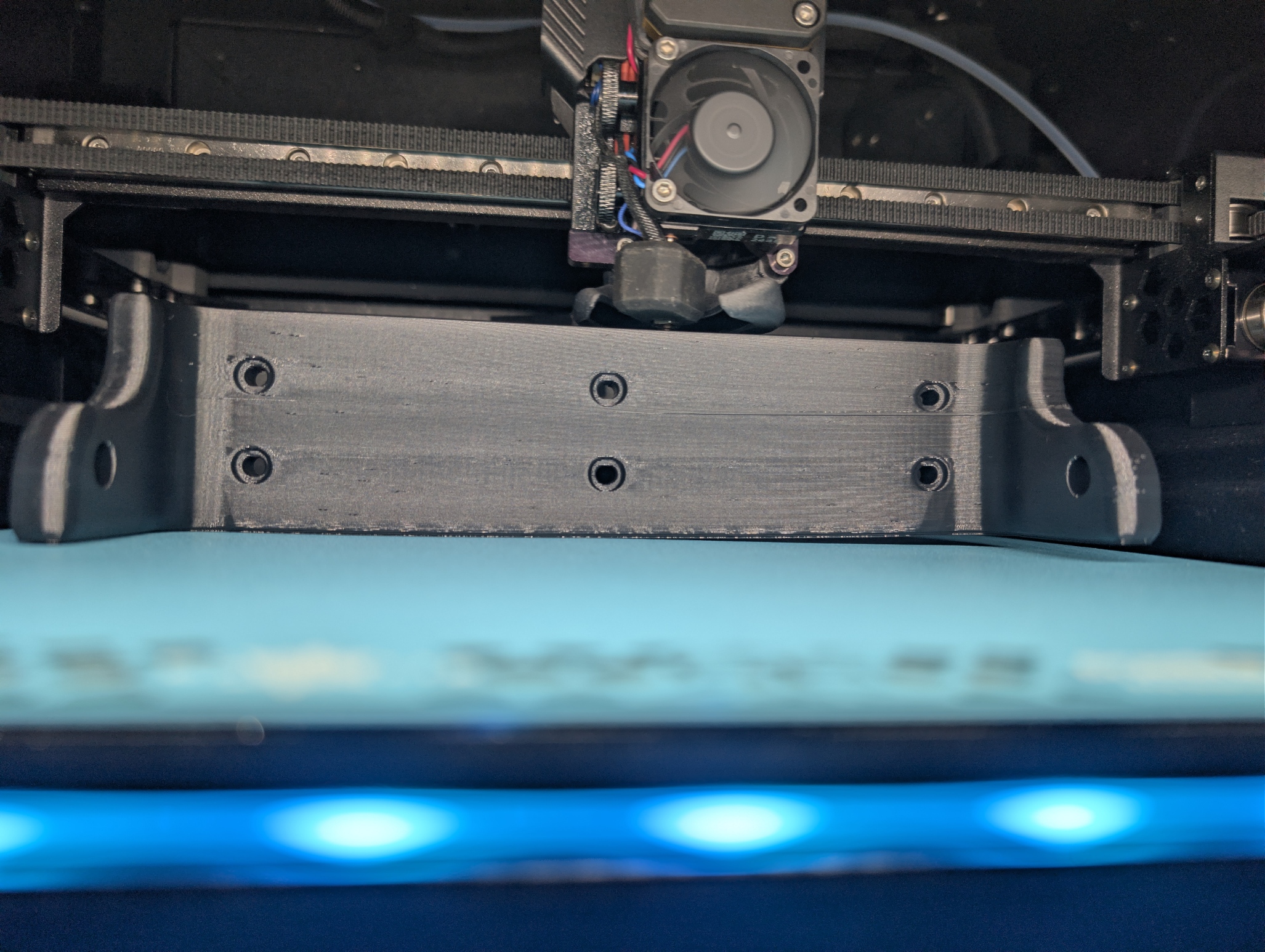

Another failed print!, Started of good but lifted as the print progressed.
OK the cryogrip is good in that it allows PC Blend to print and detach nicely, but you need a brim, trust me you need a brim. The good bit is that it detaches nicely and you don't need any paste or grip solution etc to print, but you will need a brim.
I was lucky I think that I was using a diamondback nozzle as it melted the previous layer as it was rising up and continued without skipping a beat (0.6 nozzle, fast maximum layer height. Never mind the cost, you want to get a diamondback nozzle in 0.4 and 0.6, well worth the money, obxidian sucks in comparison, I have both now).
This is a few times now where PCblend has detached and each time I haven't used a brim.
Cleaned with IPA before printing.

Themenstarter answered:
Posted by: @chocki
PC Blend and a print that large requires a different approach and a different build surface. The CryoGrip is the wrong surface. Also a brim is not going to help here. Even if you did get the part to stick to the sheet it will bend the sheet like a potato chip and pull it off the print bed.
I use a Garolite G10 surface on a rigid steel backing and Vision Miner Nano Polymer adhesive. I also have my own profiles for PC Blend that are tuned specifically for large rectangular parts to reduce warping. A basic setup is to use 4-5 perimeters and 12% Gyroid infill. Even on a very rigid plate, I've had a PC Blend part warp the plate. Also, the build plate needs to be kept high temp and the chamber temperature as well needs to be > 55°. It's also import to move the print away from the center and closer to the back of the printer where there is less of thermal gradient.
Also do not use the stock profiles for a large functional print. You need to run your own calibrations. For example, Prusa PC Blend XY shrinkage is set for 0.18% whereas I've measured it to 0.59%. That 0.41% difference doesn't seem like much but on a 250mm part that equates to ~1.3mm which is enough to throw screw holes out of alignment.
I've attached the profile I use for PC Blend and a Diamondback 0.6mm nozzle
Veröffentlicht : 21/02/2026 7:22 pm

Chocki
(@chocki)
RE: The Cryogrip Pro Glacier plate is an excellent cheaper alternative to the Satin plate with one minor caveat on the Core One
Thanks for the profile, I will test it later.
Meanwhile, I changed the design and gave it a brim which gave me a successful print.
