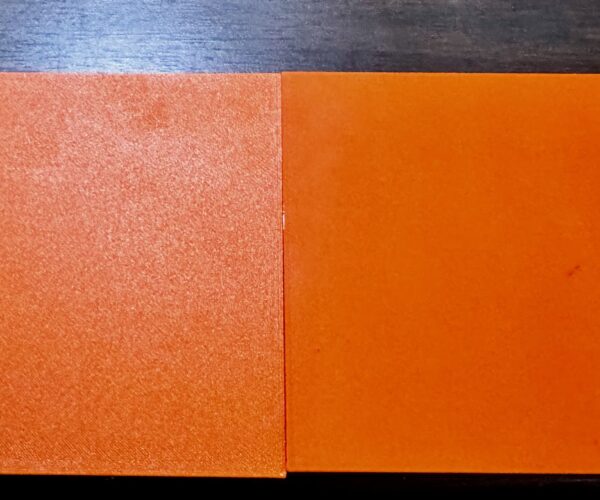

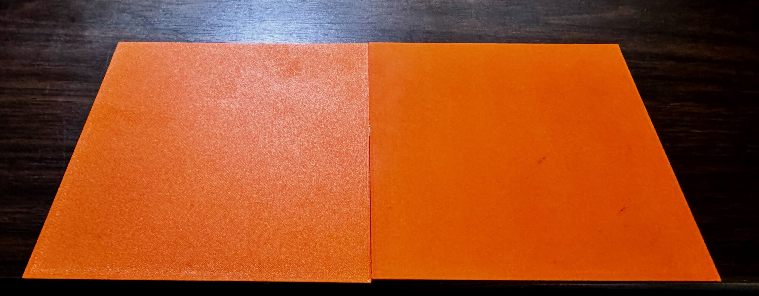

What does the first layer appearance look like with these? any chance of a close up?
Is it closer to Prusa Satin or Smooth plate appearance ?
Sorry for the questions/demands 😂 Its the one thing I really like about the satin plate is the first layer appearance. I find for PETG adhesion on the satin plate is very good, but for certain matte PLA I find adhesion can be an issue, especially for big/tall prints.

Interesting question though. It's definitely more of a satin plate in appearance. I do a comparison print later, one on each plate.

My only criticism of the Cryo plate is that it gives a grainy finish. Somewhere between a smooth and textured plate. Personally though I like it. But if you want a super-smooth finish for aesthetic  reasons then I suppose Satin or PEI smooth still has it's place. For me, don't really care. I did a comparison left is Cryo and right is Satin with Prusament PETG:
