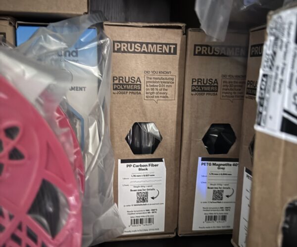

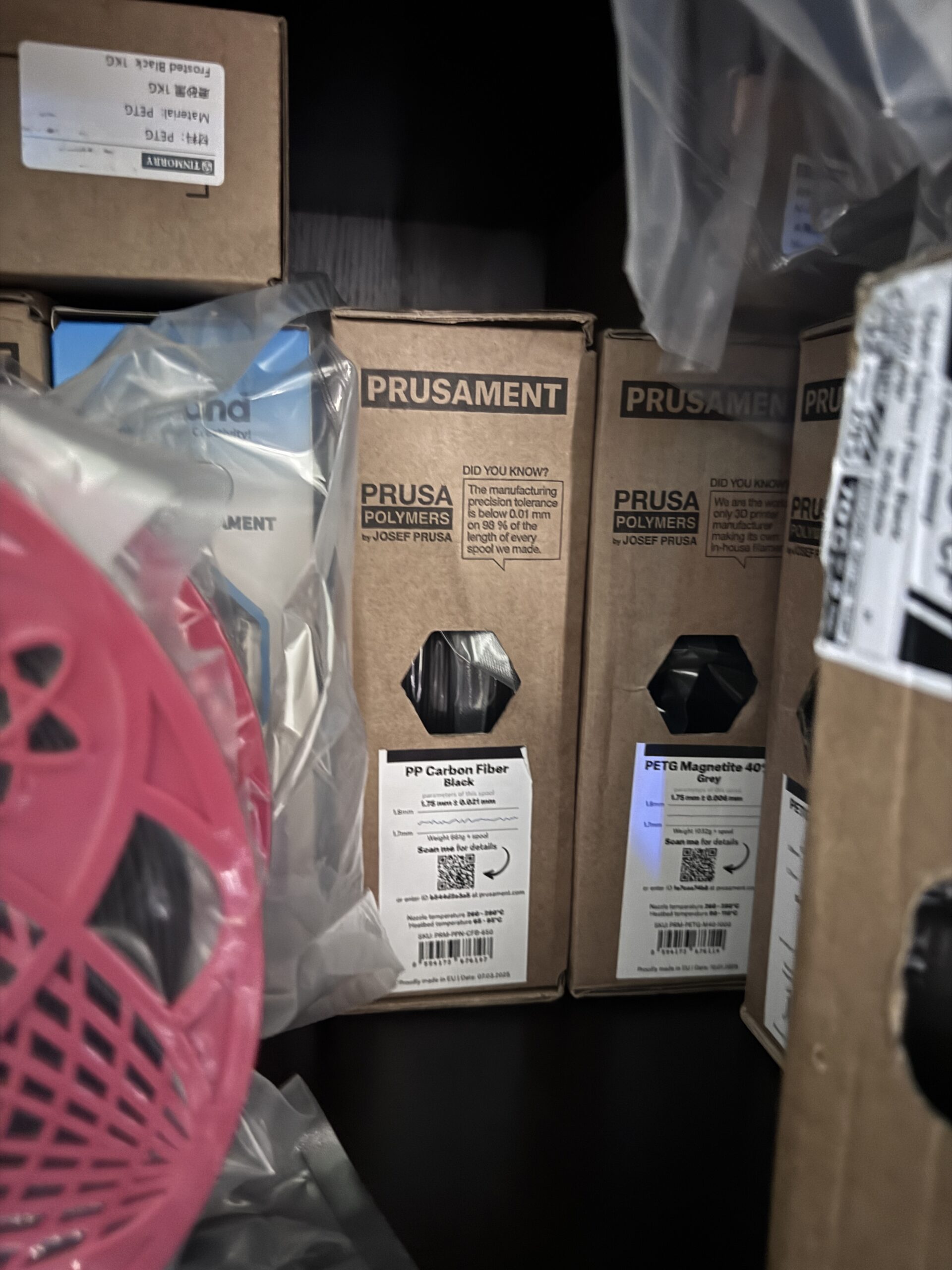

RE: The Cryogrip Pro Glacier plate is an excellent cheaper alternative to the Satin plate with one minor caveat on the Core One
Posted by: @hyiger
For fun, will try PP-CF. If that sticks to the plate and doesn't warp off it then I will pack up all of my Prusa sheets and move them to the closet
Challenge Accepted:
Showing off filament
