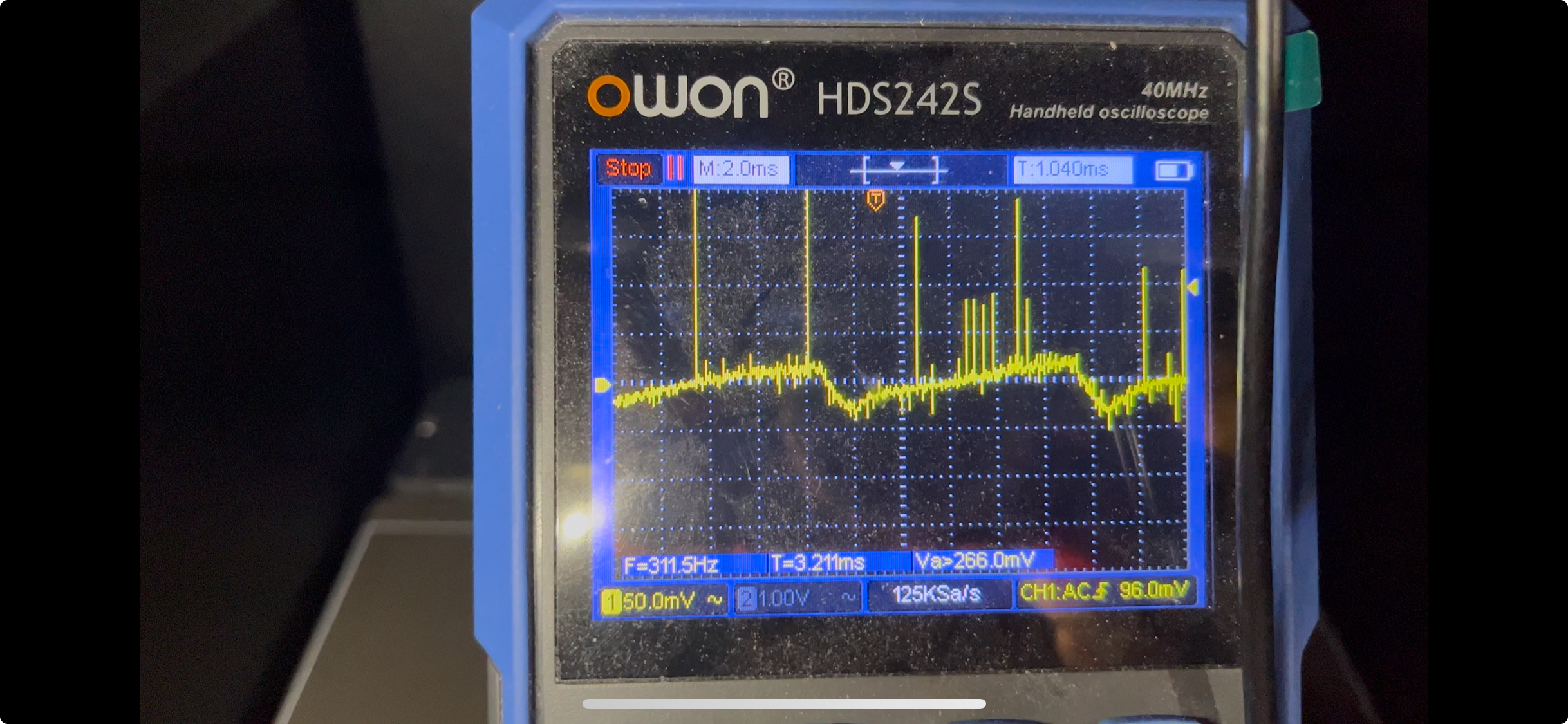

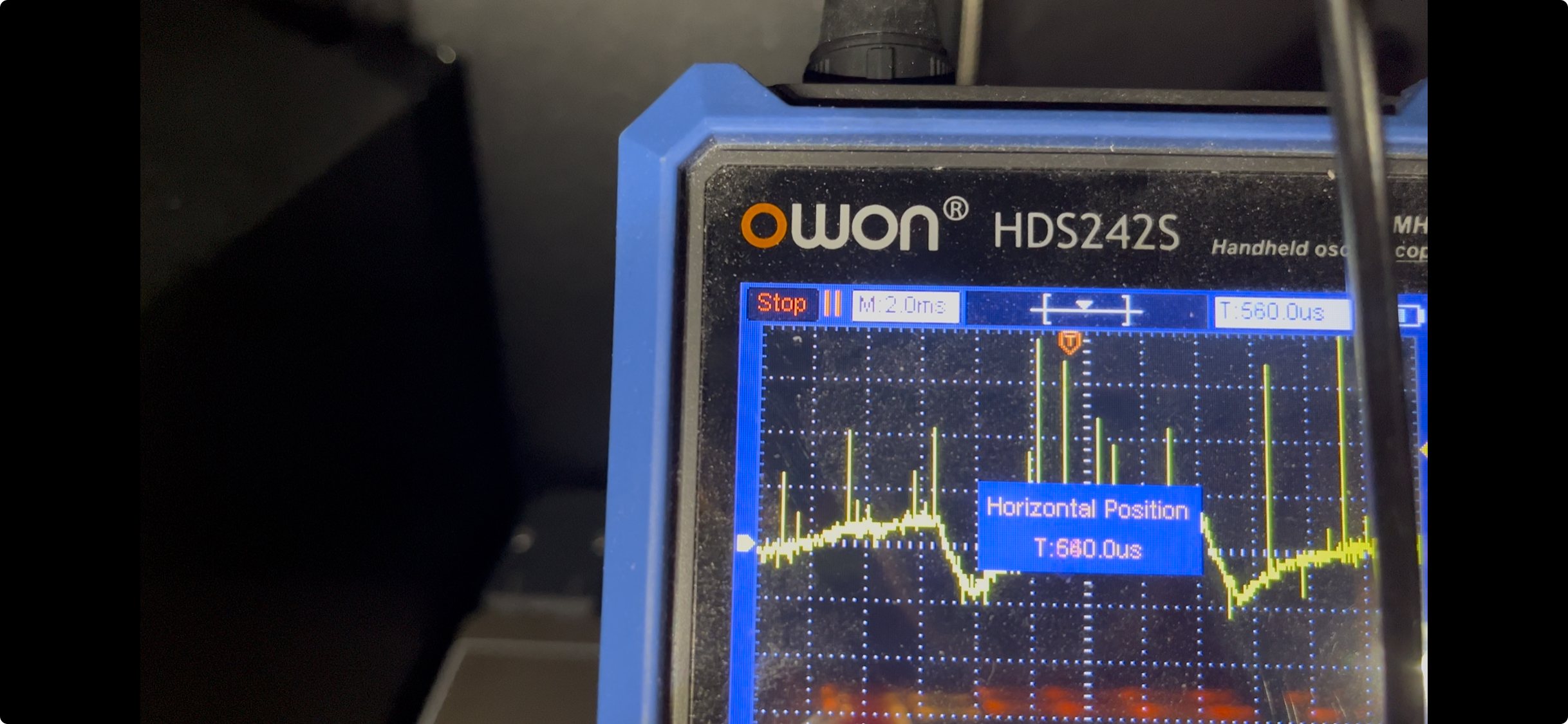

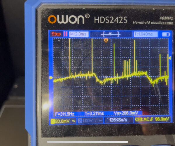

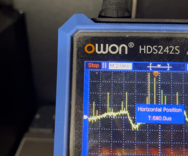

so I was curious to see how the belt tuning actually works and what is going on with the strobe light and the vibration frequency. I have a small hand-held oscilloscope and a photoresistor lying around. I put together something very simply, a USB-C charger that "powers" the photoresistor and I measured the voltage in AC mode across the photoresistor. When I shine light onto the photoresistor, the voltage drops and I adjusted the measurement range on my oscilloscope to get some readings.
After installing the new firmware, I made a video with me trying the manual belt tuning and measuring the frequency of the strobe light. Turns out, that the strobe light is not at the frequency of the vibration (=the frequency that the head vibrates to excite the belts, so that they start to swing/vibrate as well), but it is a bit out of "tune" at 100/90Hz vibration, I measured 104/92Hz strobe light (see the two screenshots attached, sorry for the bad quality, I was holding my phone filming while taking the measurements).
So I believe it works this way: the vibration is exciting the belt and when it hits the resonance frequency of the belt (which is the roughly the frequency it swings when you strobe the belt) the belt swings with the largest amplitude (I think this is what they mean with "sharp regular peaks"). Since the movement is actually to fast for the eye, the out-of-tune strobe light will cause the eye to see the movement at the frequency of the beats (i.e. the difference between the vibration frequency and the strobe light frequency), so a few Hz, so that you can follow the "slow" movement/vibration of the belt.
I will try to upload the video, if you are interested. In end I also complete the belt tuning procedure, although the values that I measured are quite ok, so I did not do/had to do any adjustments of the belt tension.
