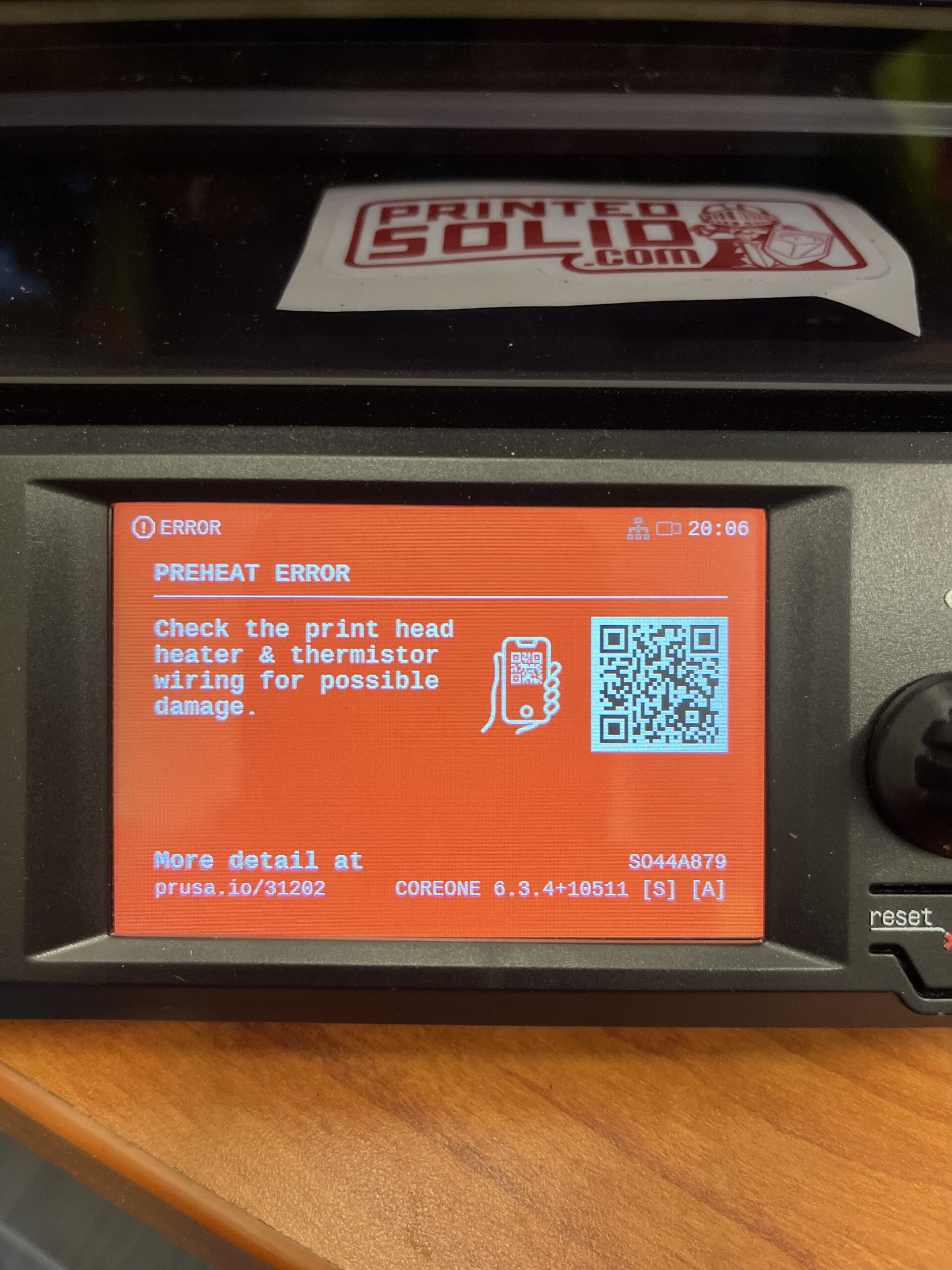

MBlack
(@mblack)
RE: Post Upgrade
Ok we have got the program to take but now will not heat the nozzle.  Have replaced most of these parts but no change. IMG_4941
Opublikowany : 09/09/2025 7:48 pm
Posted by: @mblack
Would check that the love board cables are plugged into the correct sockets. The thermistor cable plugs into the top most white socket outlined in green here. And ensure the black heater cable is plugged into the black socket above it. You can get cheap replacement on Amazon which work fine. For example: 24V 40W Heater Cartridge 104NT 100K Thermistor
This post was modified 8 mins temu by hyiger
Opublikowany : 09/09/2025 10:44 pm
