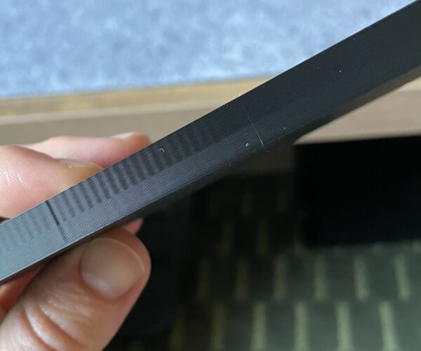

                        <description><![CDATA[I did both accelerometer-based tuning but I still see VFA when printing pcblend with .15 structural setting. I think some VFA is always going to be present on structural profile on this prin...]]></description>

                        <description><![CDATA[I was very careful in making sure that throughout the upgrade all rods and motors were straight and parallel (@jürgen thanks for the idea of loosening the holders and adjusting); I had to as...]]></description>
                        <content:encoded><![CDATA[<p>I was very careful in making sure that throughout the upgrade all rods and motors were straight and parallel (@jürgen thanks for the idea of loosening the holders and adjusting); I had to ask support to replace one of the big bearings as it didn't move smoothly at all. I was possibly lucky, but my printer didn't have a skew. Slowly tensioning both belts did it for me: no squeaks, no strange sounds, etc etc  no crazy banging (just the minimum 7) unless the belts get loose again, then I just retension them and all is ok.</p><p>I did both accelerometer-based tuning but I still see VFA when printing pcblend with .15 structural setting.</p><blockquote data-userid="591430" data-postid="761650" data-mention="newprinter"><div class="wpforo-post-quote-author"><strong> Posted by: @newprinter </strong></div><p>Are you all just eyeballing this or are you squaring it some other way?</p><blockquote data-userid="576590" data-postid="761642" data-mention="jurgen-7"><div class="wpforo-post-quote-author"><strong> Posted by: @jurgen-7 </strong></div><blockquote data-userid="512637" data-postid="761639" data-mention="gb160"><div class="wpforo-post-quote-author"><strong>Posted by: @gb160 </strong></div><p>Side note, I think rather than these brackets actually bending, some aren't perfectly square to begin with. I don't think the forces the printer is putting on them is enough to bend steel.</p></blockquote><p>Agree. I measured mine before installing them, and they were certainly off by a degree or two.</p><p>The material is quite soft; the brackets are easily bent while holding them with two fingers. But I agree that plastic deformation during printing seems unlikely. Some elastic deformation is another matter, as witnessed by the fact that unequal belt tension can easily "adjust" the gantry. </p></blockquote><p> </p></blockquote><p> </p>]]></content:encoded>

                        <description><![CDATA[I assume there is no general rule, but how often do you tighten the belts?Depending on the accelerations/decelerations and overall moved meters of the head, its hard to judge imo.As this is ...]]></description>
                        <content:encoded><![CDATA[<p>I assume there is no general rule, but how often do you tighten the belts?<br />Depending on the accelerations/decelerations and overall moved meters of the head, its hard to judge imo.</p><p>As this is my 1st printer, i fiddle with it every 2 weeks or so to check, and always find that the tuning has changed slightly, is that normal if used almost daily?</p>]]></content:encoded>

                        <description><![CDATA[Agree, it’s not bending due to normal activity on the printer. it’s more bending from handling or already bent when received. I do question the possibility that excessive uneven tensioning o...]]></description>
                        <content:encoded><![CDATA[<p>Agree, it’s not bending due to normal activity on the printer. it’s more bending from handling or already bent when received. I do question the possibility that excessive uneven tensioning of the belts could result in permanent deformation, a question of whether the plastic tensioners would snap before that level of force could be applied really. </p>
<div class="wpforo-post-quote-author"><strong> Posted by: @gb160 </strong></div>
<blockquote data-userid="0" data-postid="761638" data-mention="">
<p>These are the reasons the recommendation is to attempt to return the L brackets to 90degrees by bending. This is really the only consistent way of suggesting a fix to customers without having to ship out new brackets… which could just bend again if belts are tightened inconsistently. The flaw is in how easily those brackets bend.</p>
</blockquote>
<p>You're absolutely right but I think we're wasting our time here. There's an old saying 'You can lead a horse to water, but you can't make it drink' </p>
