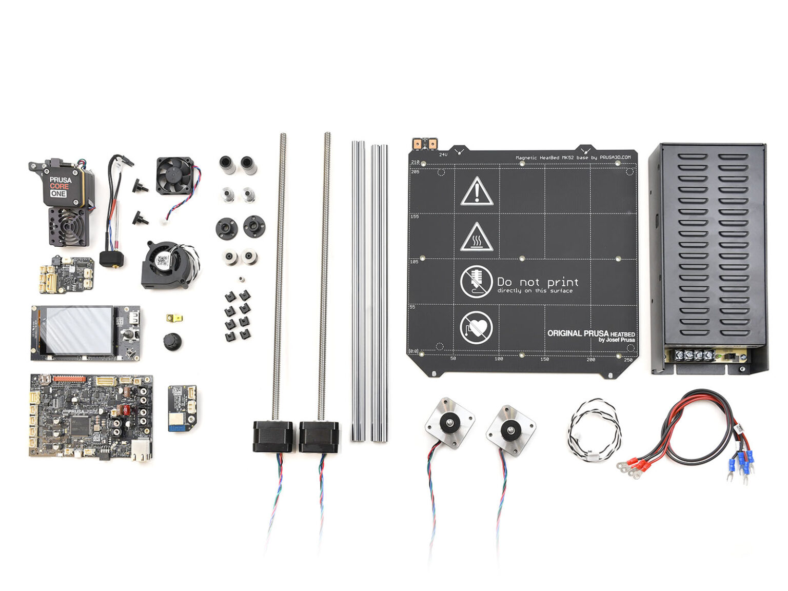

Reused MK4S Parts

I‘m wondering if I need to modifiy the nextruder of my MK4S with MMU3, or if i can leave it as it is.

RE: MK4S to Core One Conversion Manual.
You can print as usual without MMU3. Just needed to be disabled on menu 🙂
Looking through the manual super quickly, it looks like you don't need to do anything to the extruder minus remove the fans and cage.  Everything else stays the same.  What I do not know is how the cable feeds to the buddy board.
There is no mention of what to do about Nextruders that have already had MMU3 modifications.  Should they be reverted to stock or used as is?  I think the differences are: baseplate, idler arm, latch, filament sensor.
My admittedly vague recollection is that both the MK4S conversion and the MMU3 conversion modified the Nextruder using the same parts -- so if you have an MK4S with or without an MMU3, you should be all set. (This could probably be confirmed by looking at the documentation for the MK4S and MMU3.)
Posted by: @largriff
I actually already removed my MMU3 prior to receiving the Core One as I wanted to move it across, but I'm not so sure now. Thinking of keeping the Core One single colour and putting the MMU3 back on the MK4s!
Anyways, in your situation I would leave the plate as its a 'harder wearing' one anyways, but would remove the idler and replace with the original filament sensor (spring/magnet/ball) configuration. It only takes a few minutes and could rule out any possible issues later. If I weren't filming my build to create the video guide I would have stuck the plate and o-ring that comes with the MMU3 kit into my Core One Nextruder TBH - personally I think this should be a standard part.
