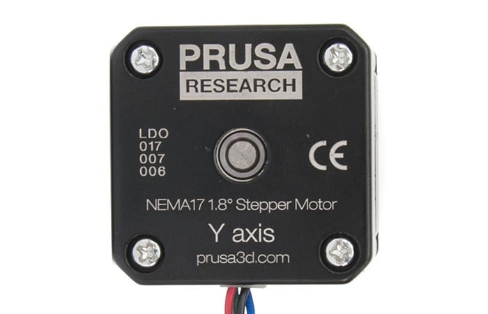

So i have very bad vibrations/resonance during some moves of the gantry during printing. Im pretty sure, the vibrations are coming from my back right x/y motor.
According to this video, Nathan/Ston-3D, creator of the Nextruder, said that Prusa switched from LDO made motors to some other manufacturer.
Im wondering, if those of us with noisy printers just are victims of bad QA from the motor manufacturer and if changing out the motors would maybe help with the noise. Do you think there is any chance that Prusa support might replace bad-performing motors as part of warranty?

Someone on Reddit seems to have proven that it was his X axis motor that produces resonance noises by unpluging X or Y motor one after the other. When unpluging X motor while printing (without filament) the resonance stopped.
I'm wondering if it's a common issue or if everybody is affected by this issue/bad motor... or if it's possible to have a printer with both good motors.

Going by photos I see on the internet, the LDO motors are labelled with the LDO brand. (In small print, besides the larger Prusa logo.) I don't see that on the stepper motors which came with my kit.
That does not rule out the possibility that Prusa may still have sourced motors from LDO after implementing the new QR-coded prints, without the LDO designation, of course. But I am not sure whether they ever sourced 0.9° motors from LDO or whether that design change coincided with a supplier change?

Yeah, there's no sign of LDO branding on my CORE One motors.  But the same goes for the motors on my MK4 and MK4S.  The MK4S started life as a MK3S+, I'll have to dig out the motors that I removed from the 3S+ to check, but I don't recall ever seeing LDO branding on them - could be wrong though.

That's my experience as well.  My Prusa branded motors (assembled MK4, and MK3->MK4 upgrade kit) do not have LDO on them.
I was one of the people who got the "free" 3.9 upgrade after the delayed release of the 3.5.  And I wanted to just go ahead and order .9 steppers since they weren't yet available from Prusa as parts.  So I found some LDO's with similar specs on Printed Solid and ordered them. They ran in my MK4 -> MK4S for many months.  No noticeable difference from my Prusa assembled MK4.  Also did something similar at work (two MK4s, one with these motors, one with Prusa steppers) - no noticeable difference.  Now they're in my CORE One conversion kit printer.
Result?  Much louder than my Prusa brand motors in my Assembled CORE One. 😀  And the pre-release phase stepping fails on them (not sure if it's some difference it detects vs. the Prusa motors, or if it's just because the calibration is still in alpha so it's just still buggy).
Just an anecdote, getting seemingly less desirable performance from my actual LDO branded motors 😉

Some motors are defective and Prusa should take more care about the motors checking... It's not a 300€ printer...
I contacted the support team for a X motor replacement because this one was so hard to turn by hand and created lot of bad vibrations.
After 3 days of "fight", they finally sent to me a new X motor.
I let you see the result:
Before: https://www.youtube.com/shorts/kEIA9auzH8Q
After: https://www.youtube.com/shorts/JOt_KkPB_lw
And the remaining vibrations went aways by increasing the belt tension (85hz to 105hz).
