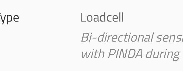

I am so glad I did not preorder this.  I just noticed that it uses a Pinda probe.  That is a huge step back in technology.
I have seen several comments that the production version for the Core One will use a load cell. (Based on statements apparently made in the live stream, which I did not watch.)

Also confirmed by Prusa employee on Reddit (nozzle tapping with load cell).

from the pre-order page at BT
Publié : 19/11/2025 11:55 pm

Thanks.  Still glad I waited.
