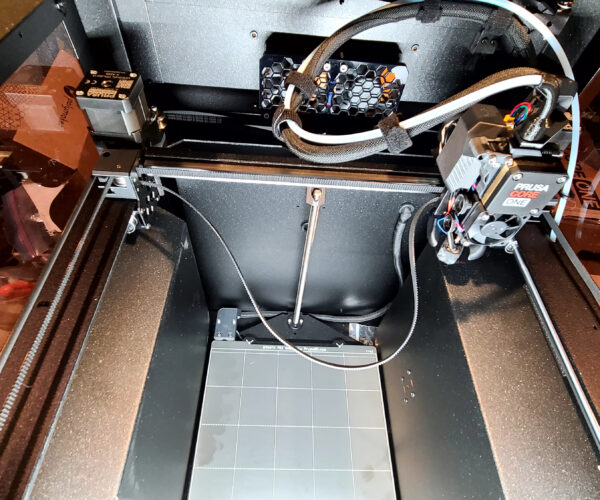

yes same length. built it back up and ran calibration test. Belt has NOT slipped however, it will not pass y axis calibration. No warning, just not passing.

Y calibration is failing because either the belt tension is uneven and the gantry is skewed or the filament sensor cable is in the way. If you move it manually along the Y axis, does it move freely? Make sure there is nothing snagging. If not, then completely loosen the belts and then follow this guide exactly: Adjusting belt tension especially the section on "Quick Gantry Alignment"

And you're not listening to advice again! Aligning the portal to the right angle and correctly setting the belt tension must be done before you try to do any calibrations! Align the portal and set the belt tension before you do anything else! The procedure has already been described here by my predecessors. By the way, you can move the upper left belt back two notches so that the end of the belt does not protrude under the metal carrier. Otherwise, the belts are installed correctly and cannot slip.
Opublikowany : 20/02/2026 8:22 am
RE: Help me get my core one printing! *assembly issue
@soulbladeofdawn -- in the photos which show the state after you attach the mounting plate to the X bearing, I can see the ends of the upper belt on the left and right side. (Short ends of the smooth back side of the belt sticking out beyond the mounting plate.) But I cannot see the corresponding ends of the lower belt. Are these still inserted deeply enough, such that several teeth can interlock with the incoming belt? Or did they slip out while you were positioning the mounting plate?
Opublikowany : 20/02/2026 9:00 am

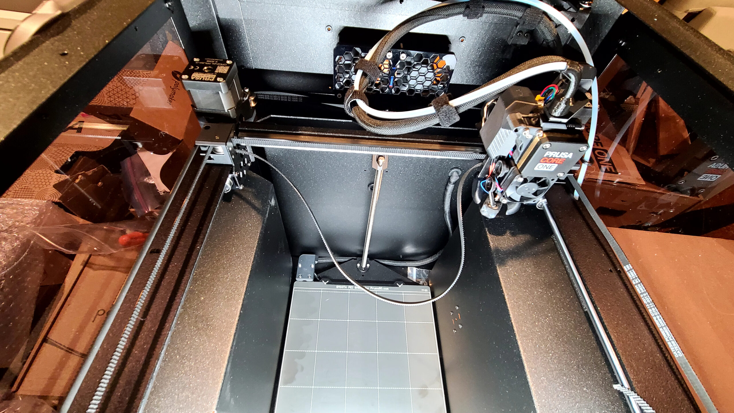

Still not printing. Spent the entire weekend working with support. Support seems to think it is due to belt not being the exact same number of notches on the belt. Some progress has been made, as the belt seems to not be slipping out of the holder anymore. Y axis still consistently fails.
I have a busy life, so weekends are pretty much the only times i have to work on the printer, and even those weekends are often busy. So far the plan is to work on it this Sunday.
I saw a long post on here that looks similar to my issues so going to see if their solution works for me too.

hint on belts: It is trivially easy to attach them to the head in exactly the position you intend if you take out the tensioning pulley temporarily so the belt is slack.
Opublikowany : 26/02/2026 6:15 pm
Posted by: @soulbladeofdawn
[...] Support seems to think it is due to belt not being the exact same number of notches on the belt.
[...] Y axis still consistently fails.
It is not important that the same number of teeth is clamped on each of the belt ends. As long as the belts don't slip out, and you can adjust the tensions to the target values, that part is fine.
I take it that you have adjusted the gantry and tensioned the belts following this guide, right? It is important that you first (without any belt tension) ensure that the X gantry touches the left and right front end stops at the same time. Then tension the belts, but always do it symmetrically. Then use the stroboscopic belt tuning wizard in firmware 6.4.0 which will walk you through the fine-tuning.
If the Y axis calibration fails: With the motors powered off, does the gantry move smoothly along the whole Y axis when you push it by hand? One of the most common (and unexpected) issues is that the cable to the filament sensor on the right side panel is bending inwards a bit and obstructing the movement of the linear bearing along the Y rod.
Opublikowany : 26/02/2026 6:54 pm

I am making sure there are exactly the same regardless.
"It is important that you first (without any belt tension) ensure that the X gantry touches the left and right front end stops at the same time. "
Some questions: when there is no tension the belt wheels on the tensioners hold the gantry back a bit, so if I push the gantry forward it gets stopped by the wheel. If I add a bit of pressure, it will still hit the tension assembly. Is this normal or does it suggest something is wrong? When there is tension and the wheel is pulled back, this issue goes away since the wheel moves deeper into the assembly.
"If the Y axis calibration fails: With the motors powered off, does the gantry move smoothly along the whole Y axis when you push it by hand? One of the most common (and unexpected) issues is that the cable to the filament sensor on the right side panel is bending inwards a bit and obstructing the movement of the linear bearing along the Y rod.  "
it moves fairly smoothly with a tiny amount of resistance (which feels normal to me).
Finally: a question- is it possible to run the built in printer tension wizard without having first attached the nextruder etc.? I am speaking of just the belts attached to the belt holder. I think ensuring belts are properly set up would be much easeir if I could dial them in BEFORE attaching everything that I would need to remove.
