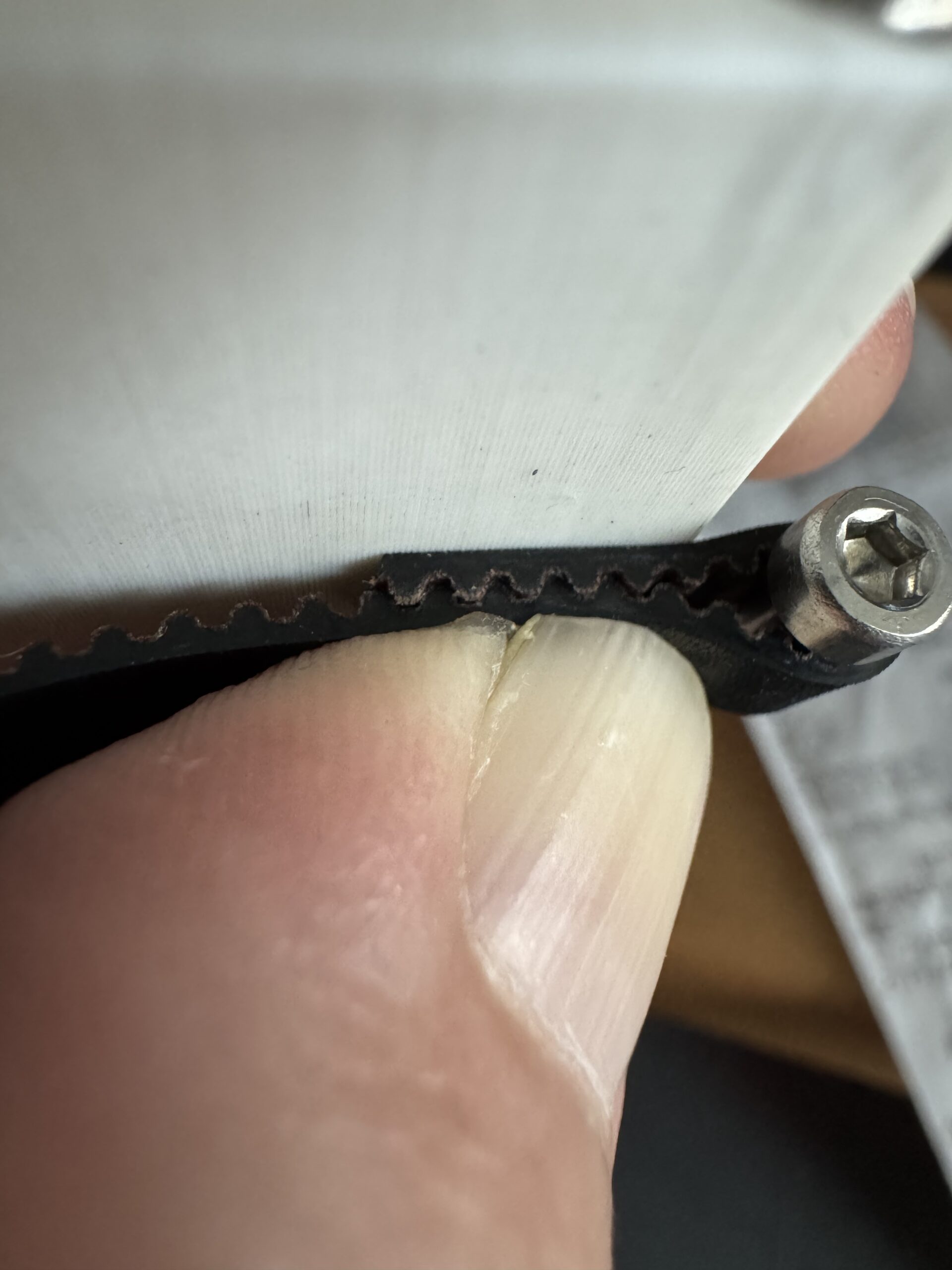

Etadriver
(@etadriver)
RE: Help me get my core one printing! *assembly issue
Only as example. You see the interlocked teeth.
Posted : 17/02/2026 12:04 pm

norskman
(@norskman)
RE: Help me get my core one printing! *assembly issue - try this simple method!
This is the only part of the upgrade from my MK4S to CoreOne that was not good. I had the same problem the belts kept slipping out.
Here is how I did it.
Slacken off the left and right screws that tighten the belts completely.
You can even open them out so the blocks fall out.
Now the belts are totally slack, but thereaded through the puleys still, its time to put the belt ends in place. With no tension on the belts this part is simple. Please see the manual for how to thread the belts there.
Then put the blocks left and right back. Tighten the belts manually till they feel about right.
Now the belt end won't come out of the block anymore
You can then run the new belt tightening procedure. This stroboscope software for the belts is pure genius. It works.
Not sure why Prusa di not use this method. Once I did this, it took a few minutes to get the belts set up correctly.
Posted : 18/02/2026 10:56 am

Etadriver
(@etadriver)
Is that a shadow or is it broken?
Posted : 18/02/2026 4:40 pm
