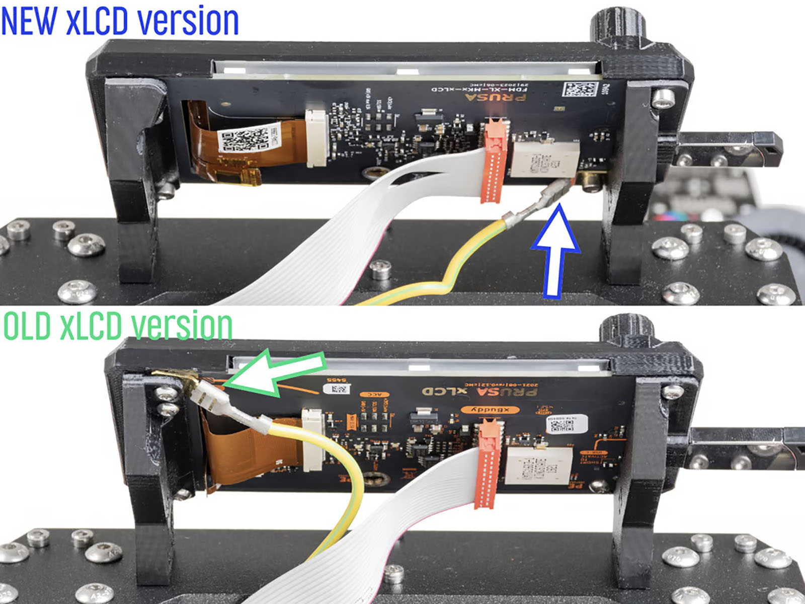

Also, you will need to choose the correct option when purchasing, depending upon whether you have the newer or older xLCD:

@iftibashir, if I may kindly correct your otherwise more than exact post: the display difference in the upgrade kit is gone. The new cover fits the old display quite well so, even prusa discontinued the 2 versions of the upgrade kit.
Even the instructions in the assembly guide now reflect only the new one.

Ah, good to know! I was looking at this page in the build guide that still refers to the xLCD version.......although I did wonder why there wa sonly one version available on the actual purchase page! That explains why!! Thanks!

the "old style display" kit was the "normal kit" with just the old-style, 3d printed, cover added to it. When I went through my upgrade with old-style display, I did mount the new cover directly as I found out that it was fitting nicely. The only "minus" of the new molded cover is that a few pixels in the rightmost column of the display are covered. My coreone has been running for months now and I've never had any functional issues related to the few covered pixels.
Given how much nicer the molded cover looks compared to the old one, it is not surprising at all that Prusa consolidated the offering.
