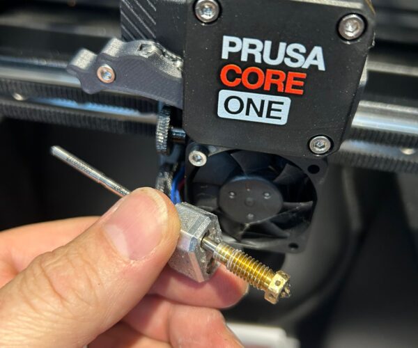

I've stripped the threads on the heaterbock - don't ask!
Can i just replace the heatblock or do I need a whole new assembly?

https://www.prusa3d.com/product/nextruder-heaterblock/

Replace the block and the nozzle. Temp sensor and heater cartridge can be reused.
