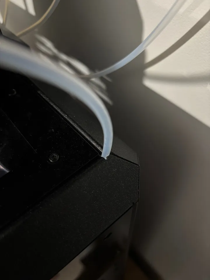

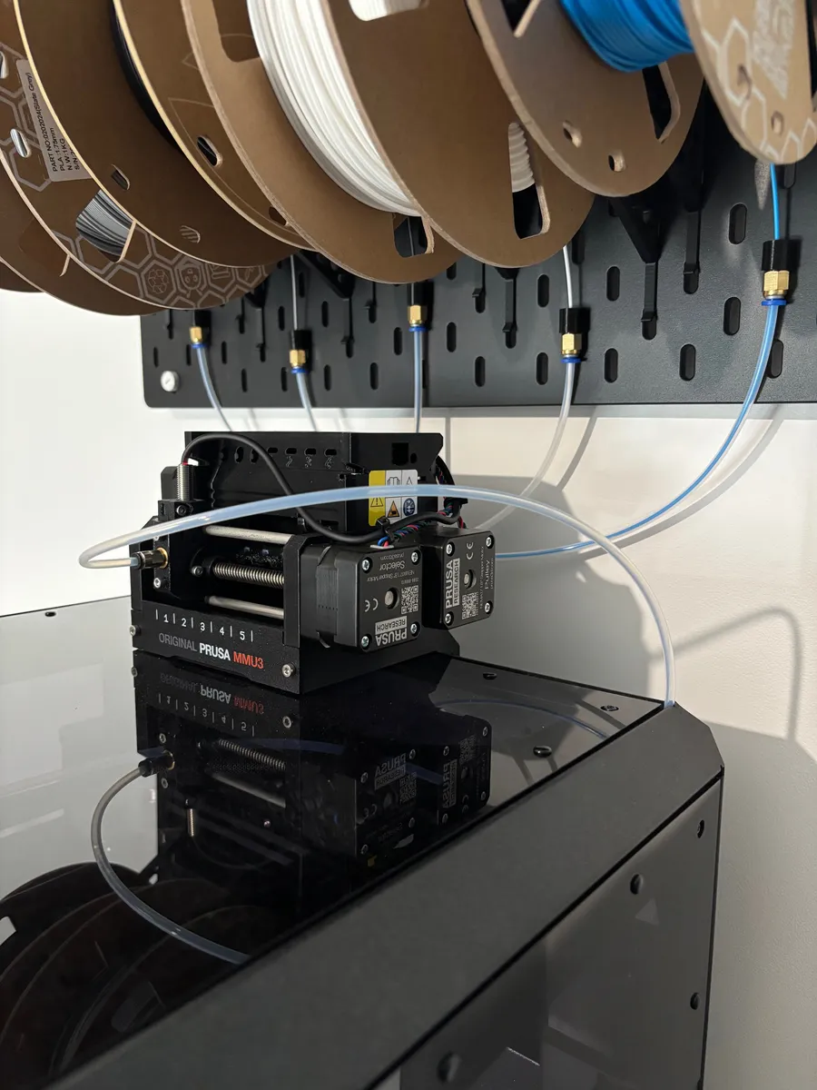

Thats looks decent!
So feeds into printer from where?
Posted by: @p1r4m4x
More simple without glass cut. 🙂
Posted : 27/06/2025 10:50 am
David R. Campbell
(@david-r-campbell)
Looks like they snuck it in through the back right corner.  @p1r4m4x what did you use for a mount?

P1R4M4X
(@p1r4m4x)
RE: Core One MMU - Next Gen Solution
Yes i used the pliers to slightly bend a bit the right corner and it follow the original swing arm path.
I made this MMU mount, you can find it there: https://www.printables.com/model/1334245-mmu3-holder-for-core-one
I like the fact that it doesn't distort the Core One.

I have limited vertical room above my CORE One.  With your mount what is the total vertical height above the machine?
Posted by: @p1r4m4x
Posted : 29/06/2025 12:54 am
P1R4M4X
(@p1r4m4x)
@david-r-campbell the mount + MMU3 take only 12cm above the machine.
Posted : 29/06/2025 5:58 pm
