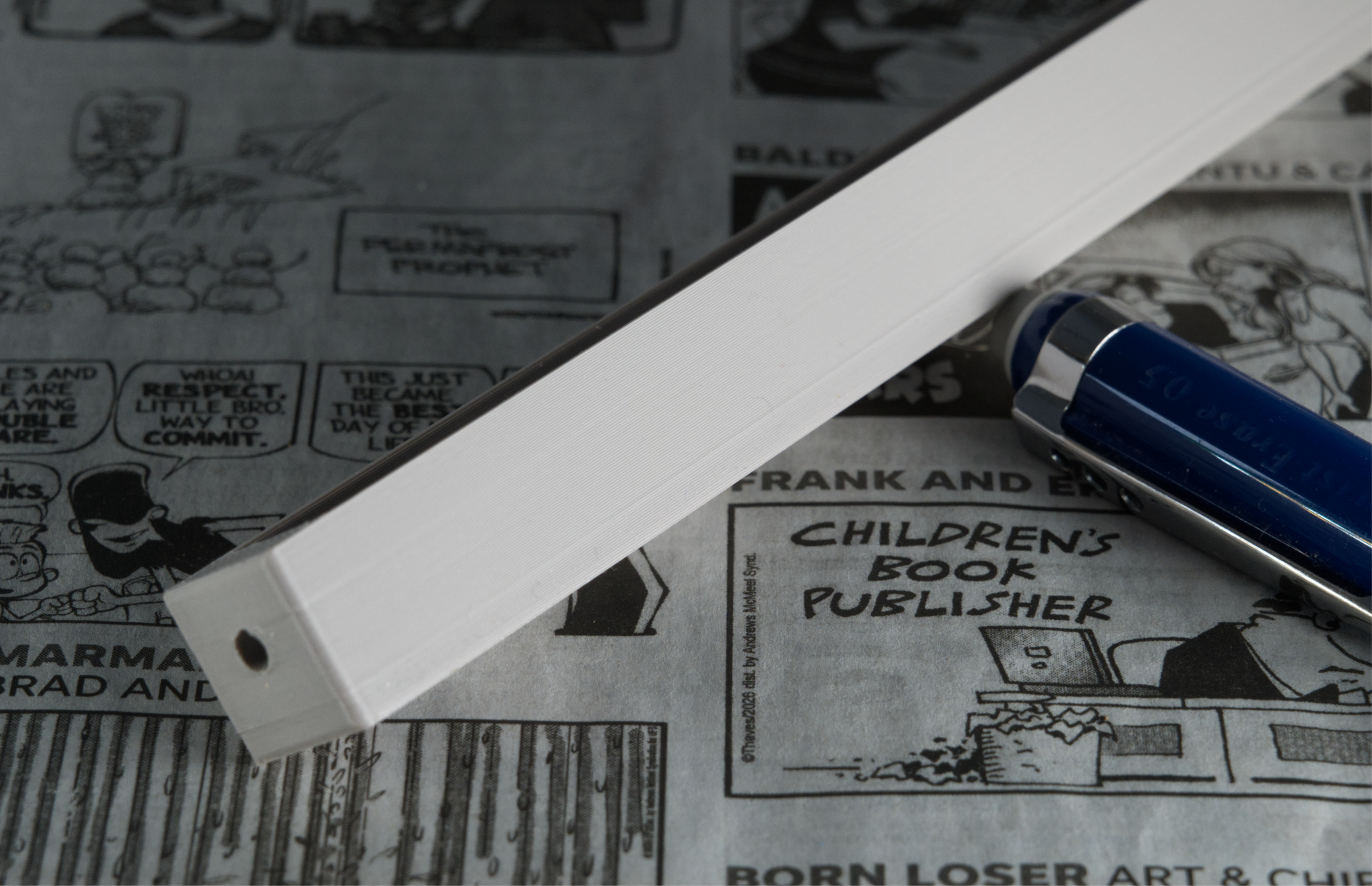

On the original topic of VFAs, I'll throw in yet another complication. One of my main hobbies is photography, so I'm sensitive to lighting of textures. The surface finish of a part has a huge amount to do with the visibility of VFAs. Glossy bad, matte good. I printed a 3X AAA battery holder for charging using Prusament PETG in grey. It's matte, for reasons I'm not entirely sure of. If it gave it to you under any normal room light, you'd say wow, this is nearly perfect. Can't see any VFAs at all. Yet, with the right grazing light from the right size LED panel, it looks as bad as anything. Here's a photo.

And here it is lit a bit differently. So, take all pictures with a grain of salt.

I hadn't thought about it that way before. Very interesting. The pictures speak for themselves.
It's just more noticeable with shiny filament 😉
