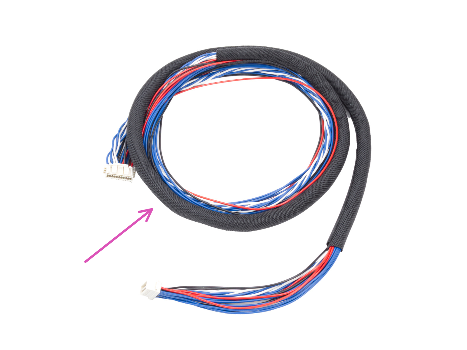

During the installation of the camera, I took the opportunity to disassemble the main cable and inspect it thoroughly. Nothing suspicious was noticed. I made sure to followed all the steps meticulously. Everything has been reassembled now, and just this morning, I performed three tests without encountering the problem again.
I'll be crossing my fingers that it doesn't return, but more importantly - I no longer need to frequently change the G-Code whenever Prusa modifies its configuration in Prusaslicer.

main cable
Do you mean the "Main FE cable" from the assembly manual?
Great to hear that your print was successful!

Oh man.. thanks, my brain was already sleeping, sorry.

The gcode fixed the issue for me also and I did find a spot on the cable that looks sus. Support is sending a new cable and ill test continuity when I receive the new one huge thanks to the guy that posted the gcode im greatful to be able to print while waiting for the permanent fix

Yup, it was only a fluke. Adding the gcode patch worked for me. Starting to make sense that it's a grounding problem which was perhaps solved (mechanically) when support shipped out new love board main cables and (for some) the problem went away.
