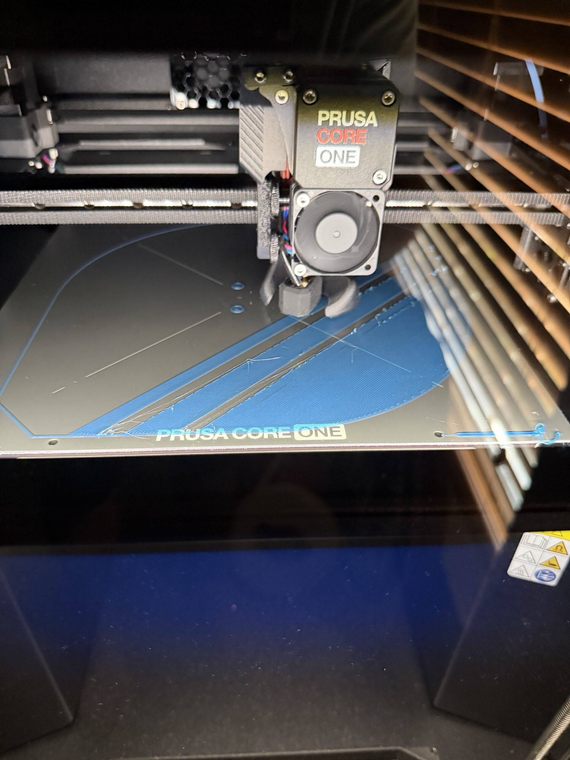

Brand new Prusa Core One (Factory assembled) and Ive had one successful print off of it.  I have attempted to print this part now 6 times.  Different Prusa slicer settings (with supports, without supports, 10mm, 15mm, 20mm, 25mm) All fail.  This is the tool box listed on Printables that goes into the side compartment of the Prusa Core One.  I've run a benchy and the crazy fast benchy from the thumb drive that comes with the printer with minimal issues, but they didn't look as good as I expected.  For a new machine with less than 5 hours print time on it, it's kind of disappointing.  I've reverted to my Mk3S+ for now printing some of the other parts of this build (WITH NO PROBLEMS), but some are too large and need to be printed on the Core One.
Just a note: The first layer prints beautifully, nice adhesion and smooth surface.  Then when the additional layers get added, it starts to sound like crap like it's dragging and then after a couple hours looks like the above.
I have recalibrated the printer as far as I can tell.  It went through the whole process where I had to touch the print head and all that, and reran the print to the same messy outcome.
Any help would be appreciated.

Here is the first layer of the same print above

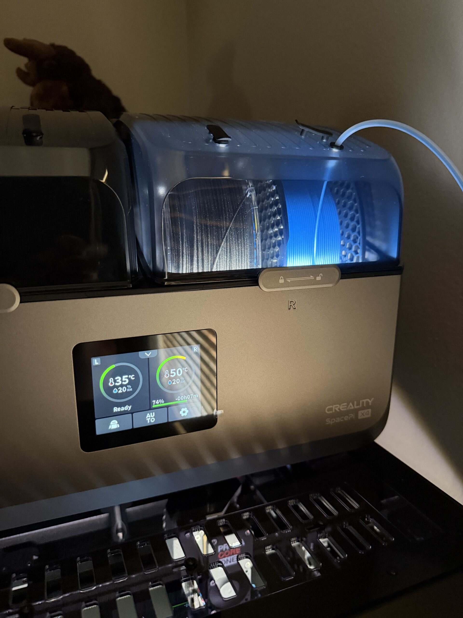

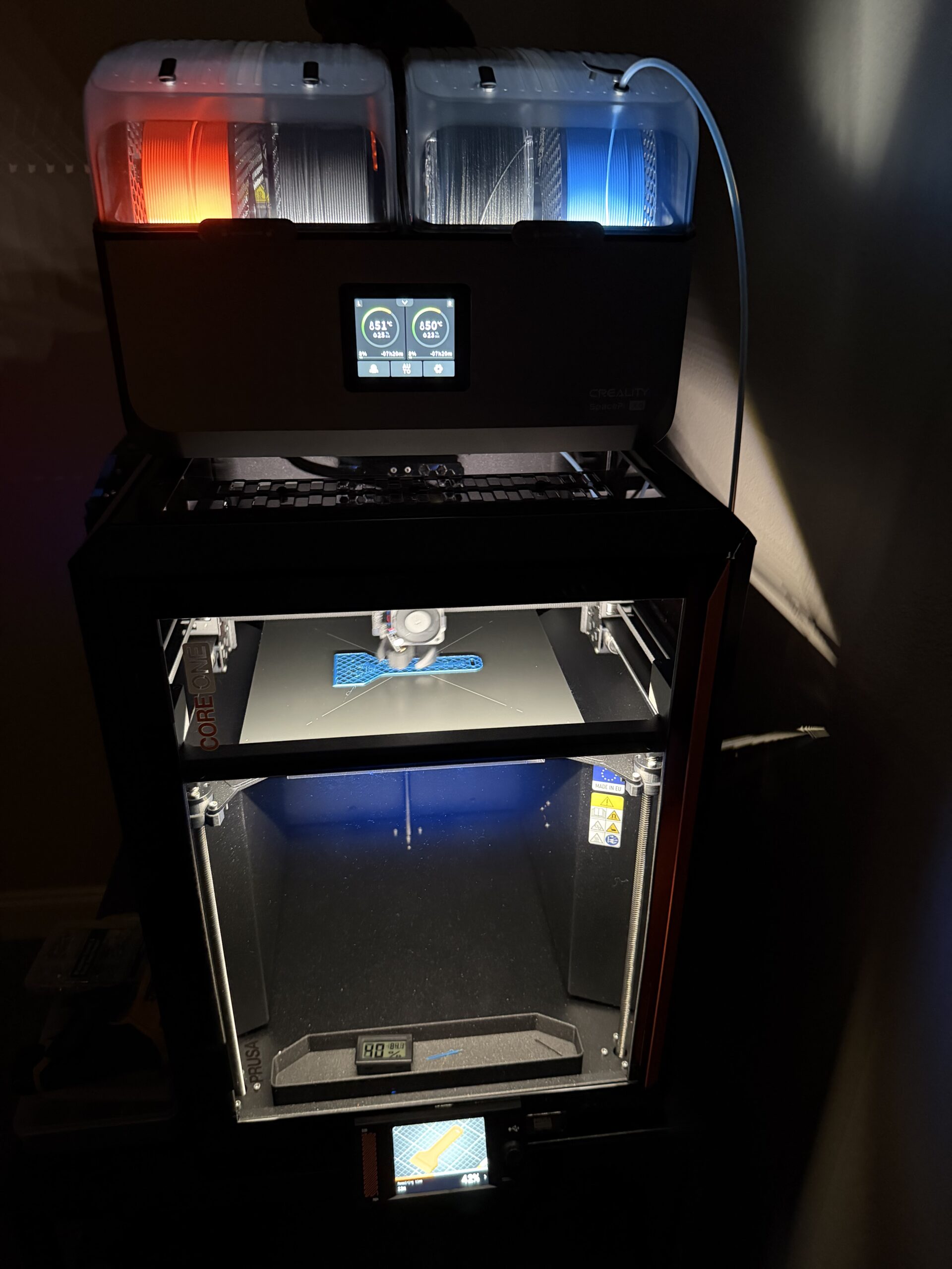

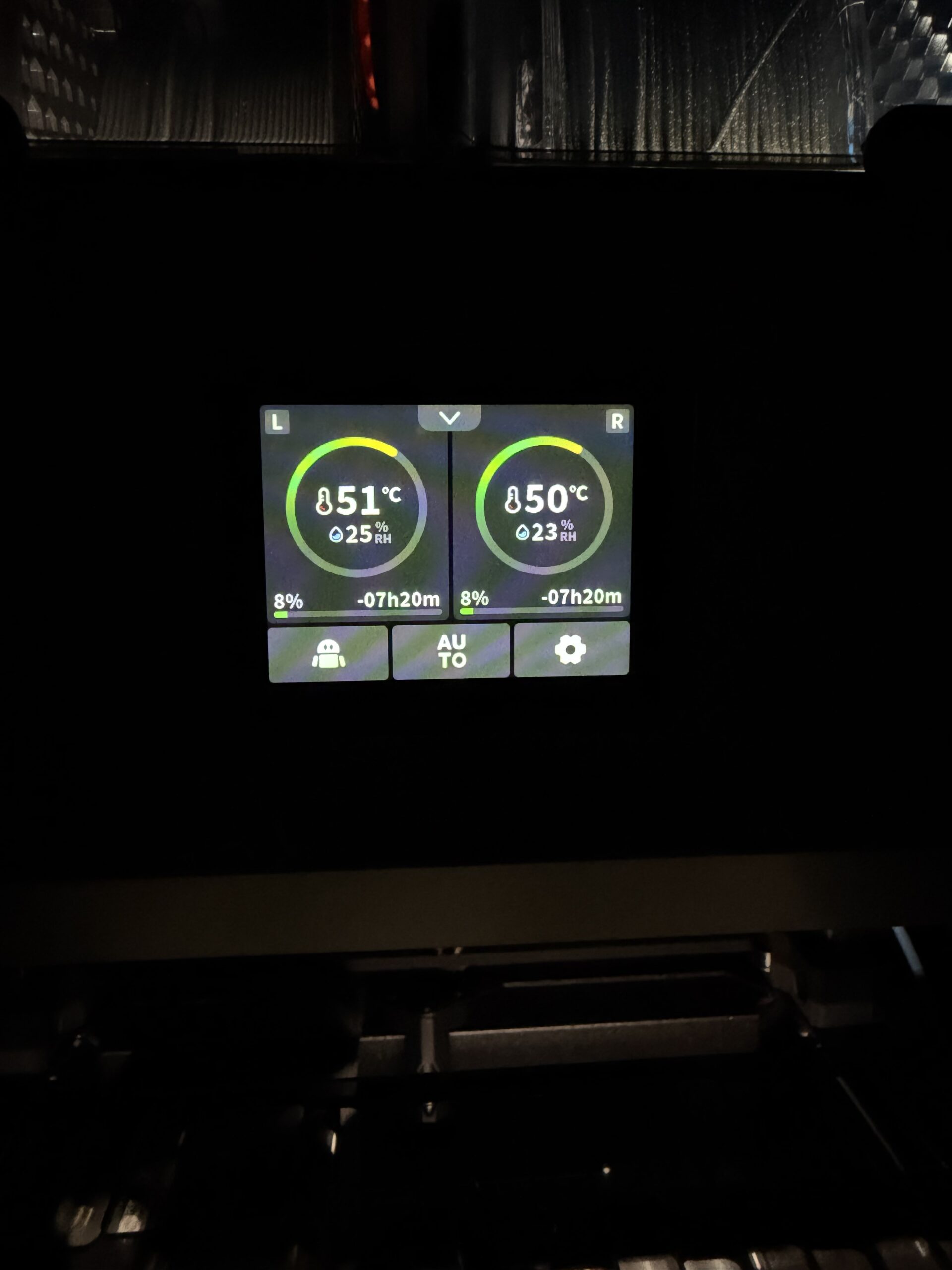

Okay, purchased a dryer.  Had it dry PLA for 8+ hours at 50°C
ran the filament through a tube directly from dryer to Core One…same outcome!!!

Buying the filament dryer regardless was a good decision. You will most definitely need it.
As for the photos it doesn't look like the same outcome. The first photos (at the beginning of the thread) was clearly due to, in part, to damp filament. The last photo to me looks like a clogged nozzle. Sometimes this can happen if (for example) you set your Printer profile to a high flow nozzle but you don't have a high flow nozzle installed.
Also, it would help if you could zip your .3mf project file (exported from PrusaSlicer) and attach it here.
