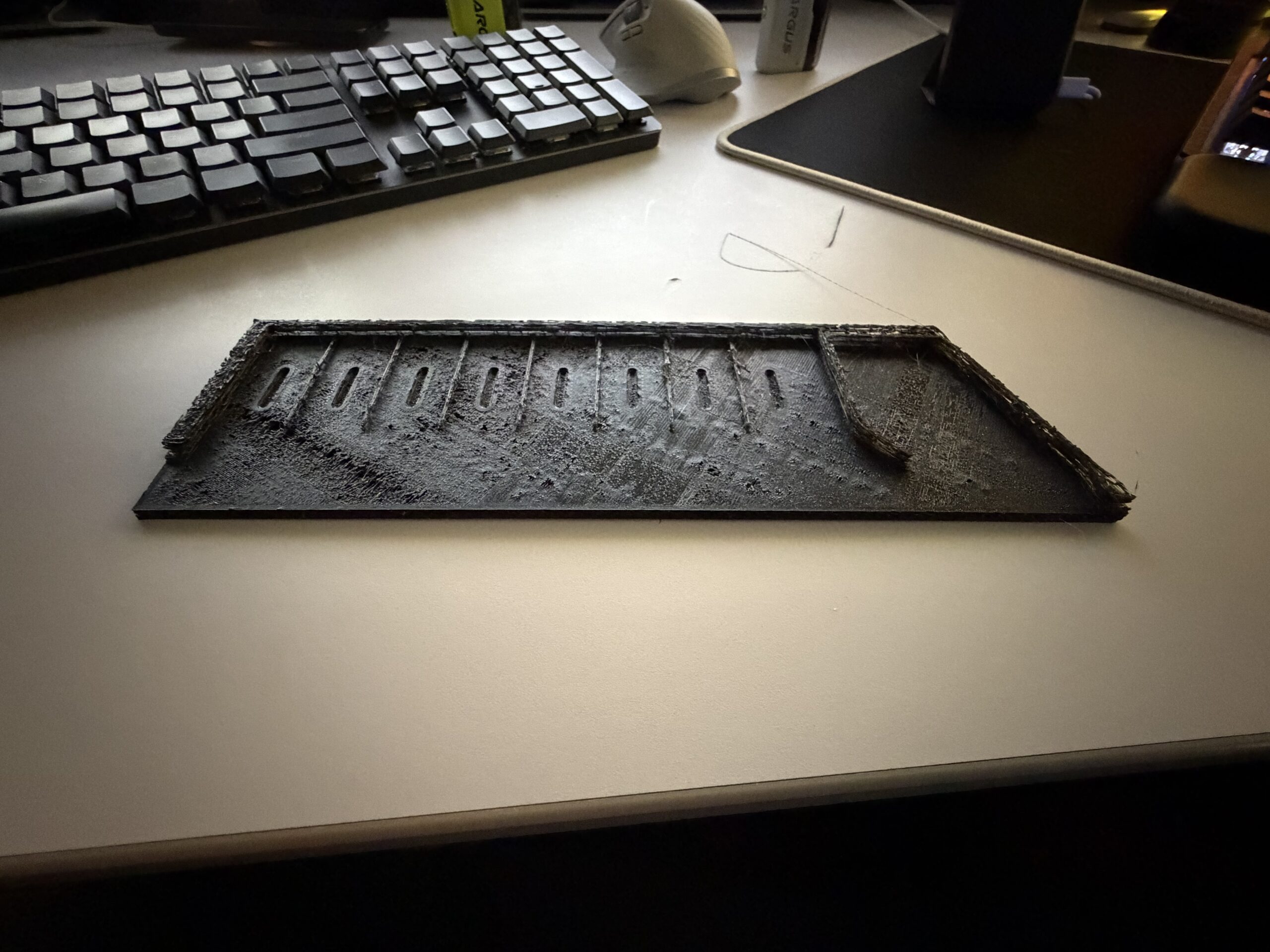

What is happening here?
Brand new Prusa Core One (Factory assembled) and Ive had one successful print off of it.  I have attempted to print this part now 6 times.  Different Prusa slicer settings (with supports, without supports, 10mm, 15mm, 20mm, 25mm) All fail.  This is the tool box listed on Printables that goes into the side compartment of the Prusa Core One.  I've run a benchy and the crazy fast benchy from the thumb drive that comes with the printer with minimal issues, but they didn't look as good as I expected.  For a new machine with less than 5 hours print time on it, it's kind of disappointing.  I've reverted to my Mk3S+ for now printing some of the other parts of this build (WITH NO PROBLEMS), but some are too large and need to be printed on the Core One.
Just a note: The first layer prints beautifully, nice adhesion and smooth surface.  Then when the additional layers get added, it starts to sound like crap like it's dragging and then after a couple hours looks like the above.
I have recalibrated the printer as far as I can tell.  It went through the whole process where I had to touch the print head and all that, and reran the print to the same messy outcome.
Any help would be appreciated.

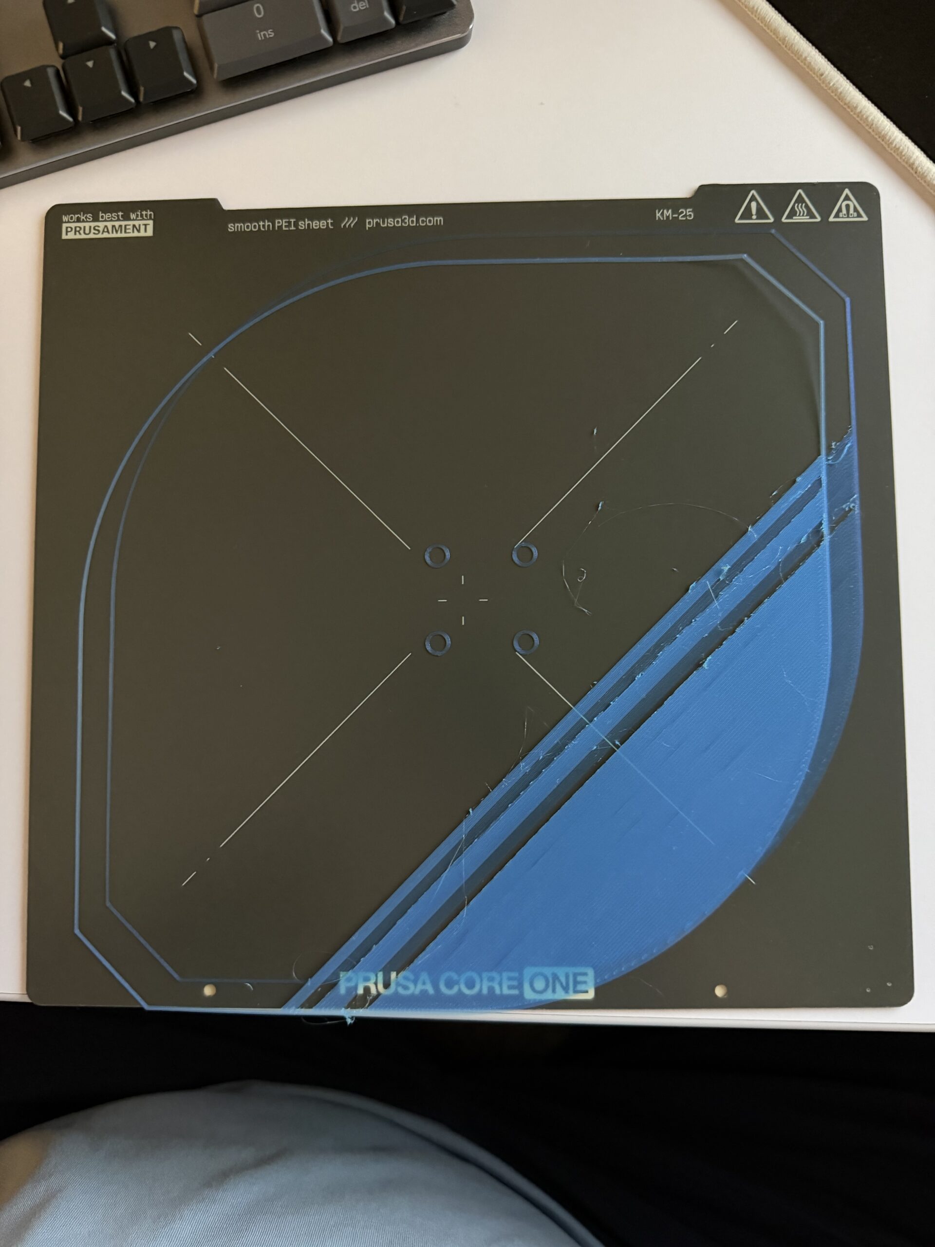

Here is the first layer of the same print above

Wet filament. Needs to go into a filament dryer. If you don't already own one I recommend you do.

Buying the filament dryer regardless was a good decision. You will most definitely need it.
As for the photos it doesn't look like the same outcome. The first photos (at the beginning of the thread) was clearly due to, in part, to damp filament. The last photo to me looks like a clogged nozzle. Sometimes this can happen if (for example) you set your Printer profile to a high flow nozzle but you don't have a high flow nozzle installed.

I'm still thinking the nozzle is clogged. Can happen if you push damp filament through it. Do you have another nozzle you can test with? If not you should because those brass nozzles will eventually wear out. Try doing a cold pull.

This is definitely either caused by: a clogged nozzle, debris in the extruder or perhaps the nozzle is not fully inserted into the nextruder. Either way something is blocking the filament's path through the end of the nozzle.
First, double check the heat block assembly is correctly inserted fully into the nextruder. Next, open the idler and look for debris. Perhaps a bit of plastic is blocking the entrance to the heat break tube. It could just be you have a bad nozzle. It's always important to have a spare nozzle and heat block on hand.
