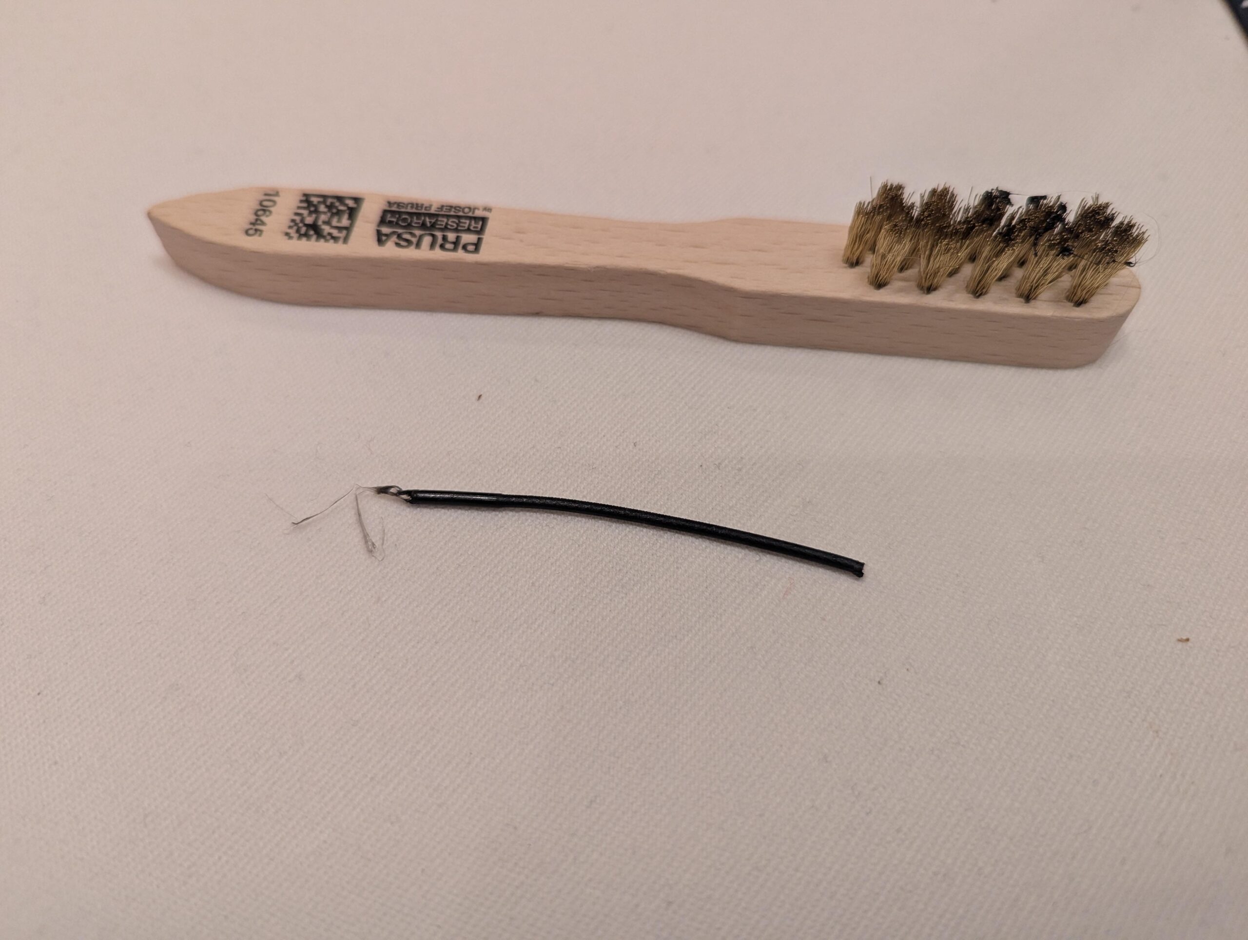

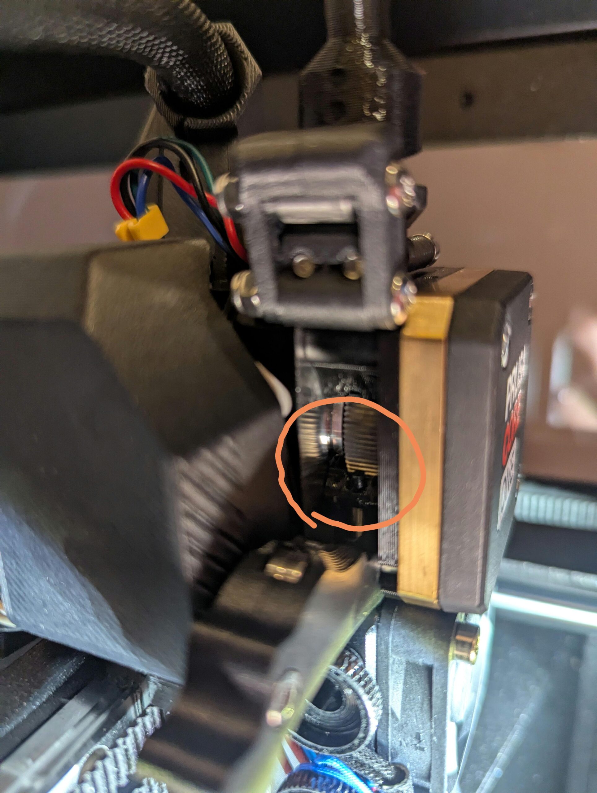

On reddit, someone made the suggestion to clean the nozzle with the provided brush and needle after heating it up. However, when looking at it from the side I also noticed the following:

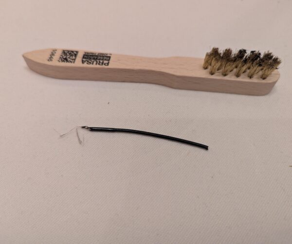

As you can see, there is a filament shaped part visible that I assumed might be the cause of the issue. I assumed I caused the filament to tear when I did unload it beforehand. So, after the whole nozzle cleaning and purging procedure did not produce the desired result, I used the pliers that came with the Core One and removed the filament.
As you can see, there was quite a bit still inside. That being said, I do think that pushing the needle in would have been required to remove the clogged part in the nozzle.
Do you have any idea how I can avoid this in the future? Just leave the heat vent at the top open or also the door? Is something wrong that might require more checks?
