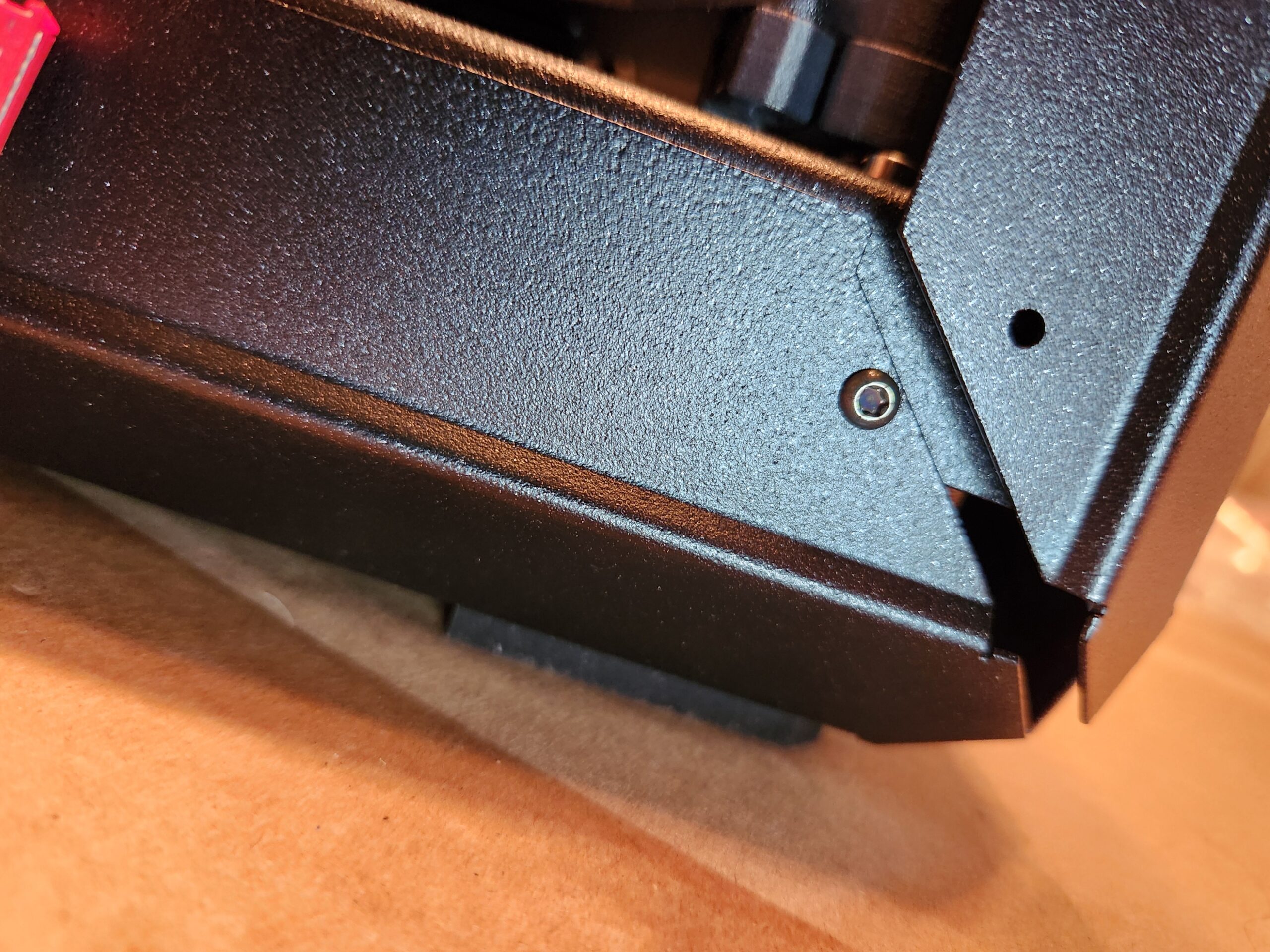

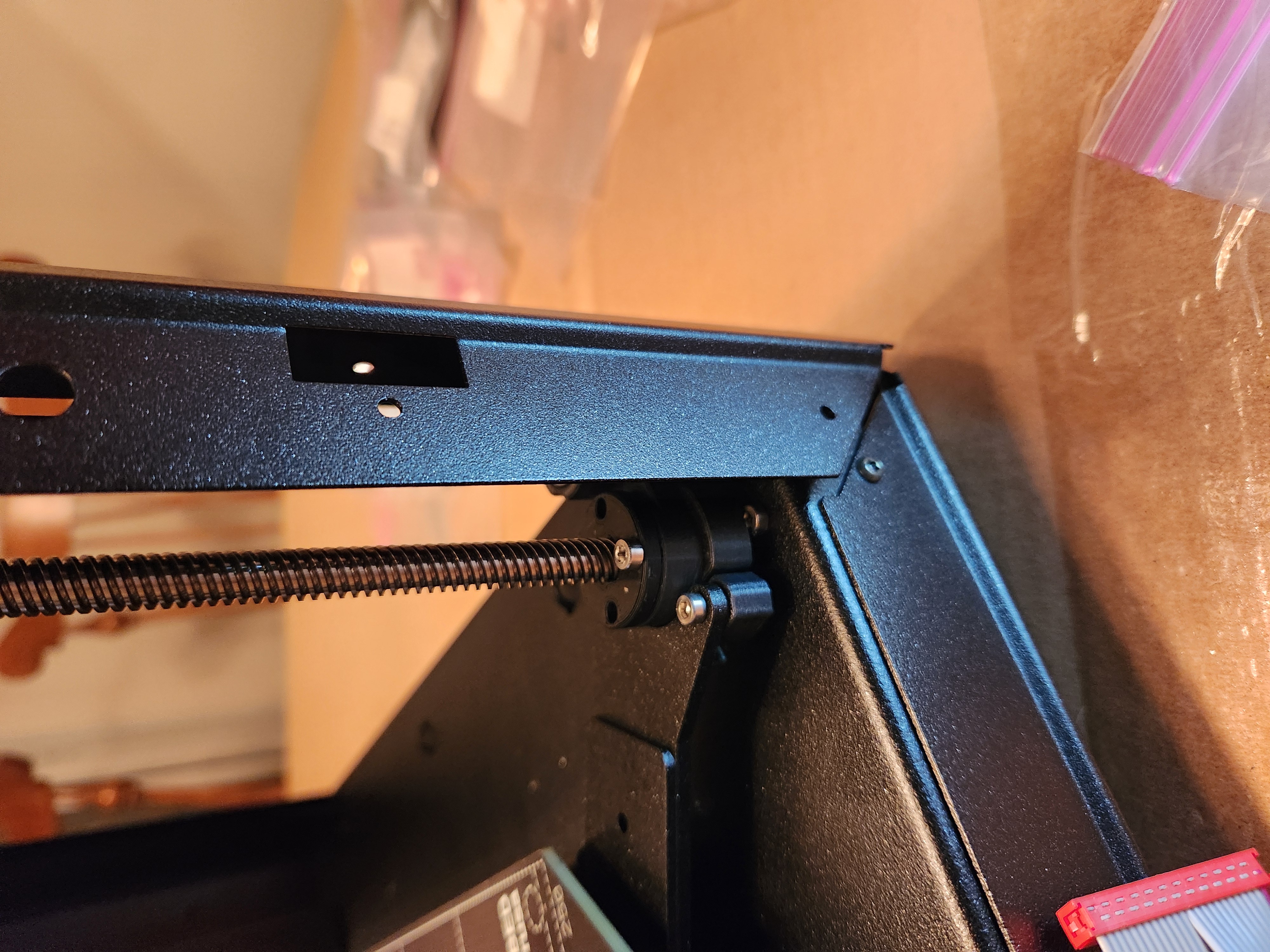

I'm in section 7 of the build (Bodywork and Electronics) In step 3 installing the front right profile that part does not align with the screw holes at the bottom. I thought that the printer was perhaps not level but I put a level on it and it's perfectly level in both directions.  Please tell me how to fix this. I made sure I was using the correct extrusion. the left side extrusion fits great….so odd

Ok I loosened the screws on the support rod…top and bottom and then took a hammer and gently tapped the top of the frame and although it wasn’t a perfect alignment, I was able to get the screws in and continue the build…
