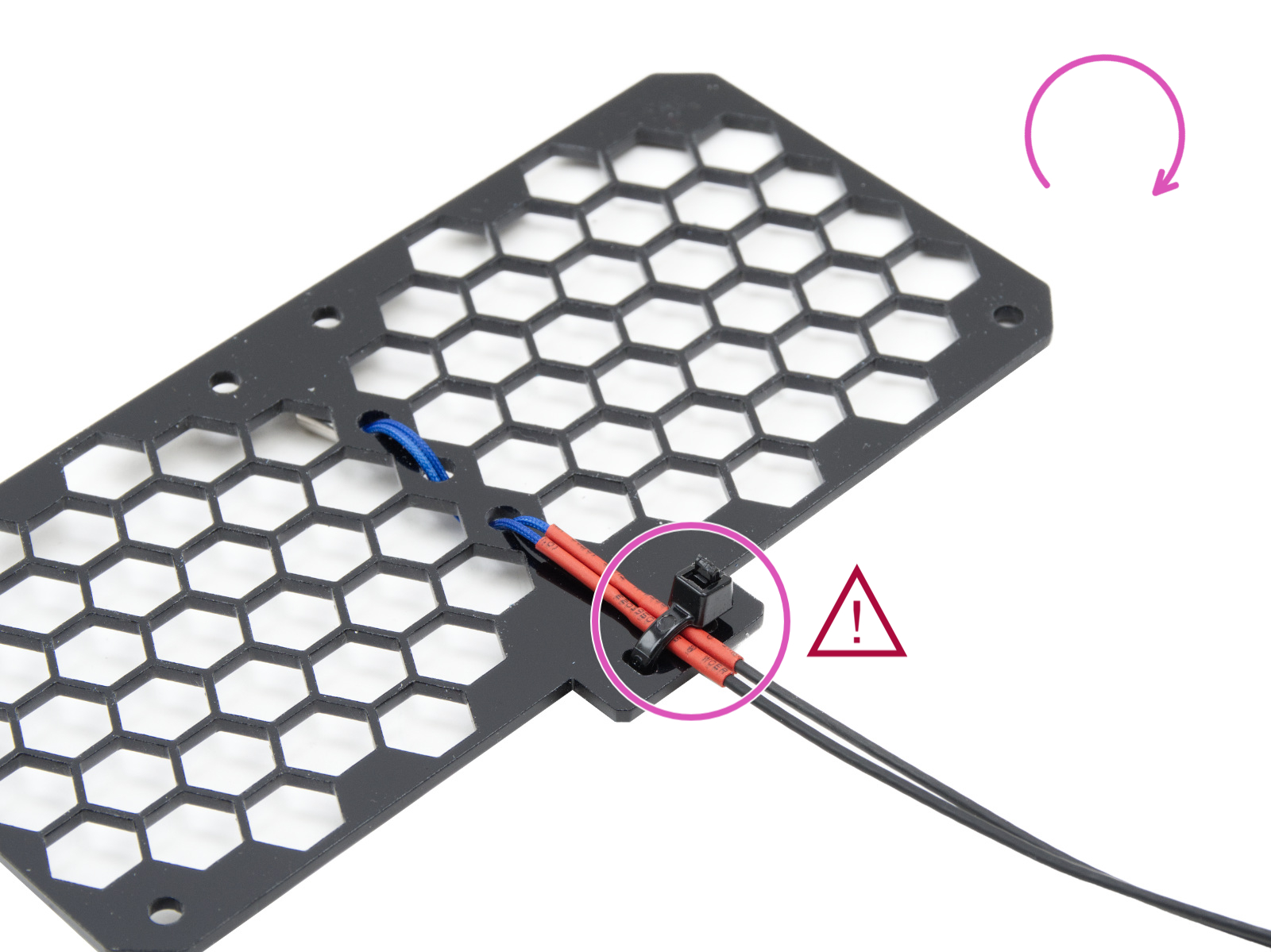

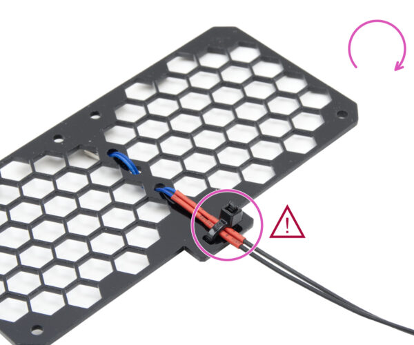

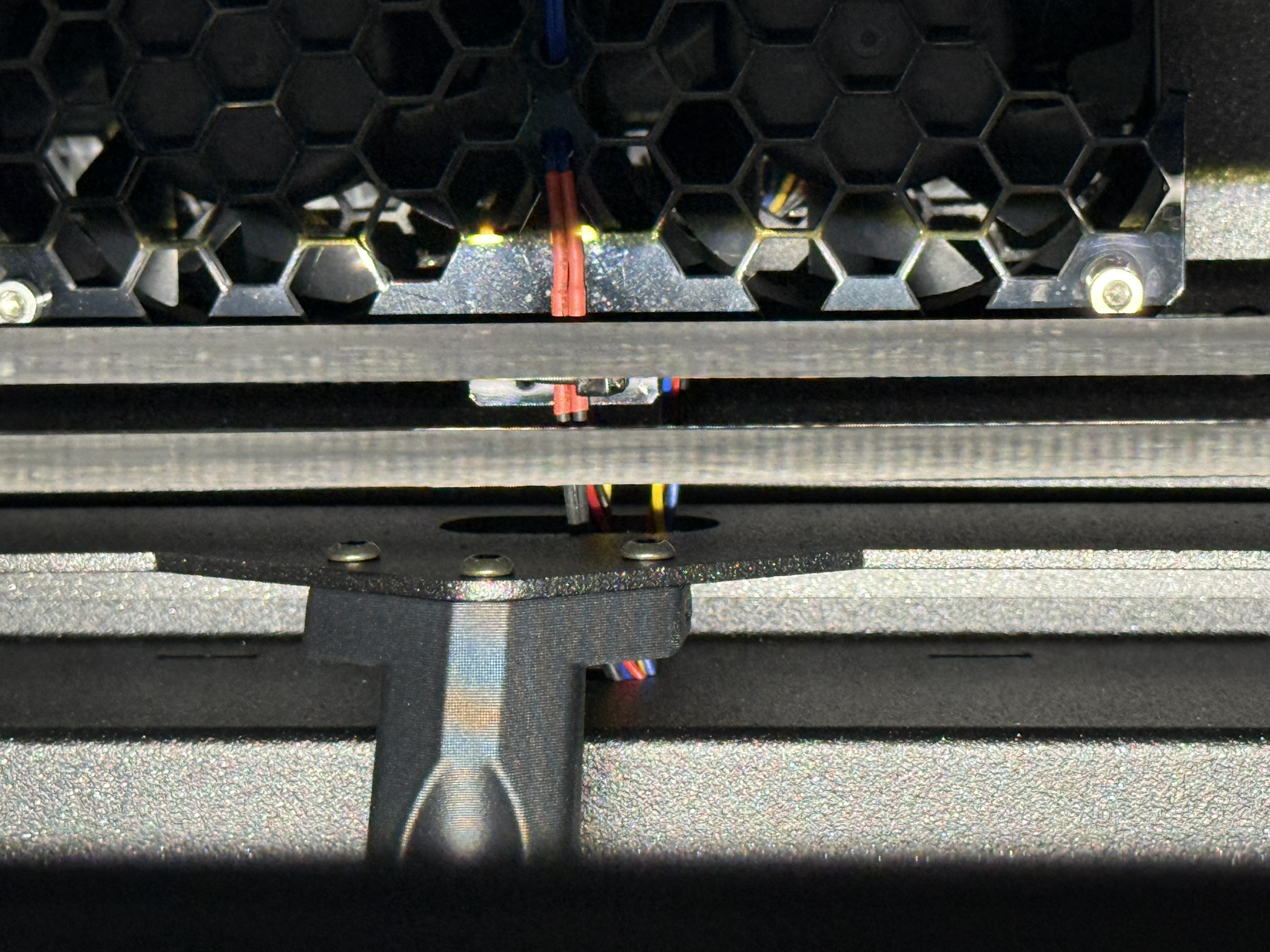

for me the noise was caused by the belt rubbing against a ziptie head holding the cable and chasis temp sensor cable
