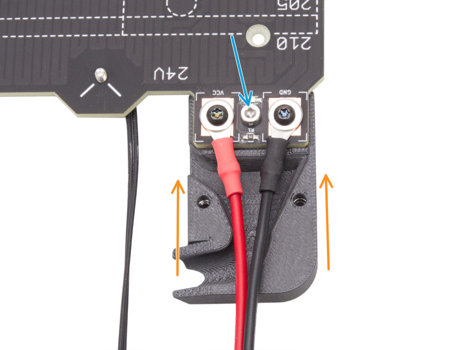

Best Answer by altaic:
The bed cable cover mounting screw (socket head cap screw) is too tall for the cover design and keeps the cover halves from seating properly. In this image it's the screw with the blue arrow. Replace it with a button head screw or a low profile socket head cap screw and it should be good.

No problem. i'm kindaaaa weirdly angry-ish? Because i just replaced the screw like you said, and the cover sits perfect. I haven't actually moved the head around, don't want to turn on the printer and have it do its homing because people have just gone to sleep XD
But the cover now sits flush with the bed screws that bed screws that align the build plate...

Indeed, and thank you for it. It was driving me crazy. I flipped the cover over and saw that indeed there was an imprint of the print head screw on it.

It's apparently a mistake in kit assembly manual. Factory assembled units has button head screw there and no issue.

i changed it for a black torx 3*8 screw. The important part is for the screw to be long enough to reach the nut on the other side and have a smaller head than the silver m3 one.

I swapped the standard M3x10 screw for a M3x10rT screw (black button head). You should have a spare in the package anyways, and it fits perfect.

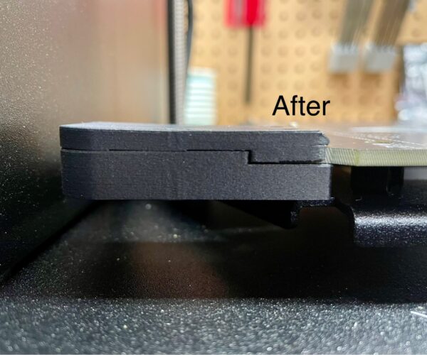

RE: Print fan cooling duct scraping on bed cable cover when using the Satin print sheet.
Posted by: @iftibashir
Will be sure to mention this in my build video (with credit) 😉
Credit should go to @el_hopaness, who first reported this problem and the solution a few weeks ago. 👍

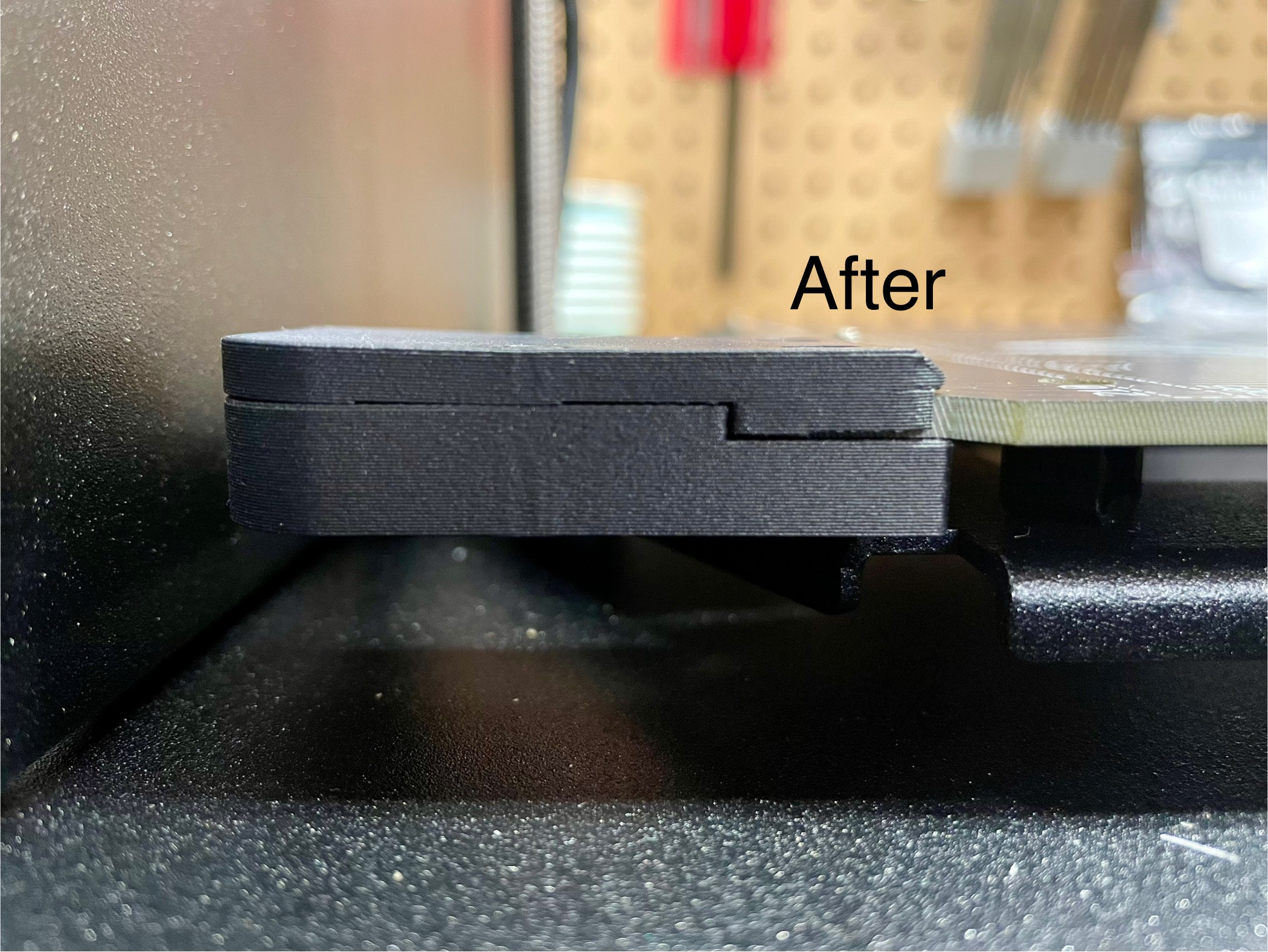

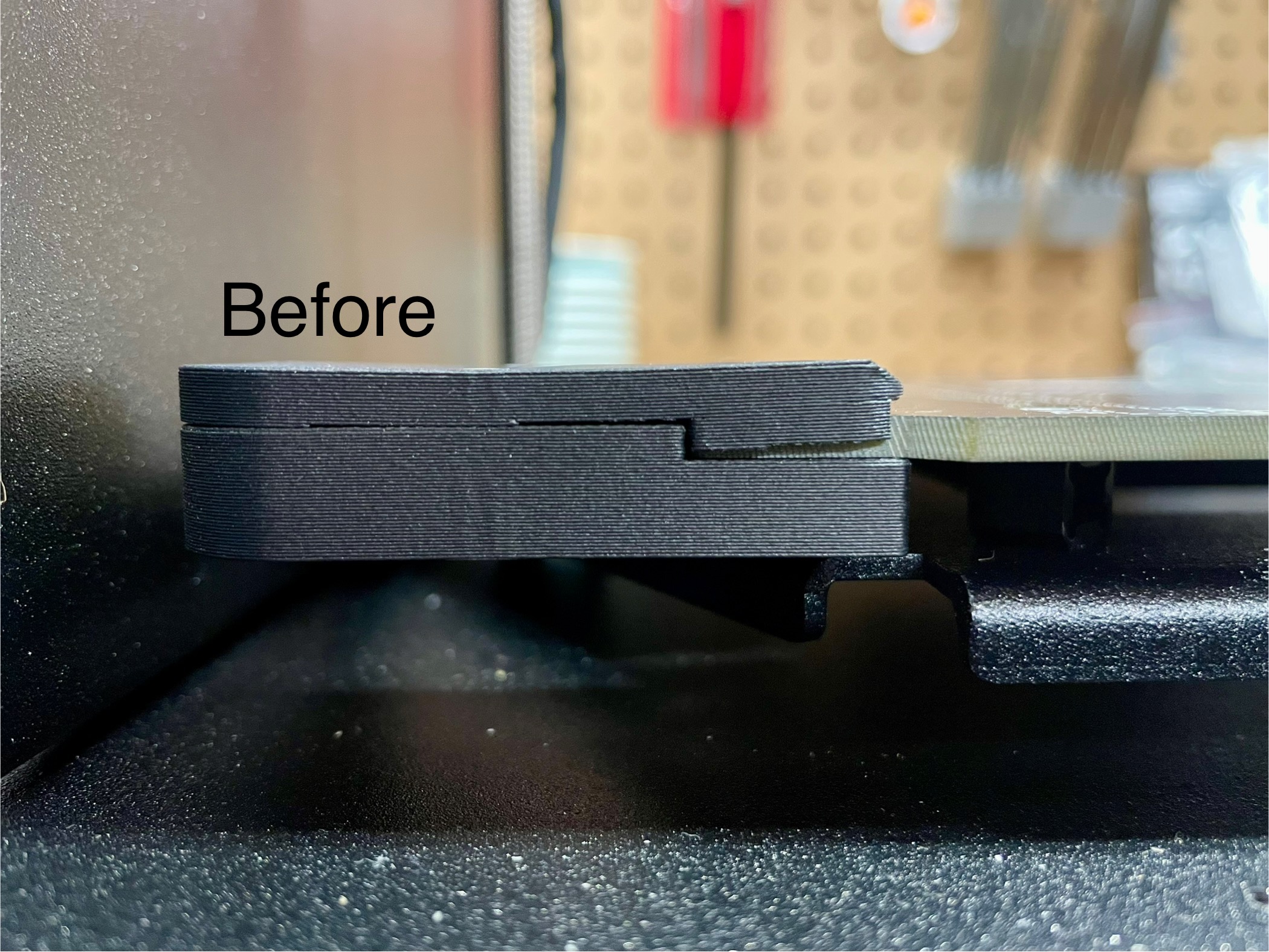

I happened to complete this step last night so I looked at mine to see.  There is a very small gap between the top and bottom covers caused by the cap screw head.  I changed to the smaller rounded head screw and the gap is still there. It is smaller.  Is there a way to tell if this is good enough to avoid the interference?
Posted : 28/04/2025 9:21 pm
gb160
(@gb160)
Posted by: @retrotechy
Could it be that the screw now has clearance, but the PCCF part has warped slightly due to the wrong screw being installed initially?
Posted : 29/04/2025 8:12 am
George
(@george-4)
Check it against the two stopper screws for the print sheet that are at the back of the bed. It should be at max as high at that. Not higher.
Also take a close look at the crimped terminals on the two heater power cables. They are a bit bulky and mine were pre-bent upwards a bit, to they still got in the way of the cable cover.
