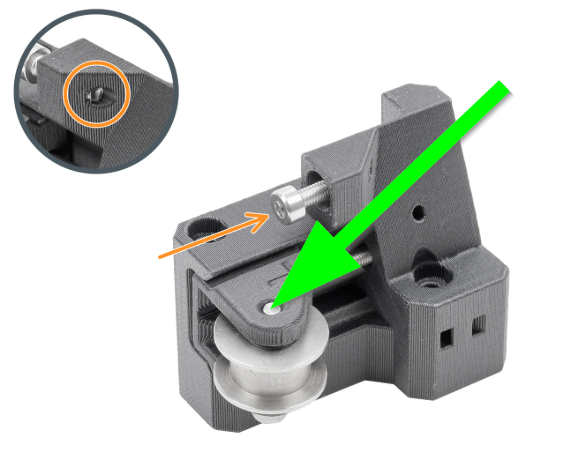

i had problem as many others ... after 2 motnhs of printing i notices increasing of noise during move X/Y axes. I tried many way to fix and at the end i found somth what i wanna share with you - maybe some1 make same mystake during the building of pritnter as i did.
Do doublecheck that you have both screws used in the parts BELT-TENSIONER-PULLEY long as you can see on the picture below. My problem was that I used shorter screws that reached the thread on the other side and therefore the belt was slightly off-center.
I hope this helps someone

SCREW MARKED WITH GREEN ARROW !!!
