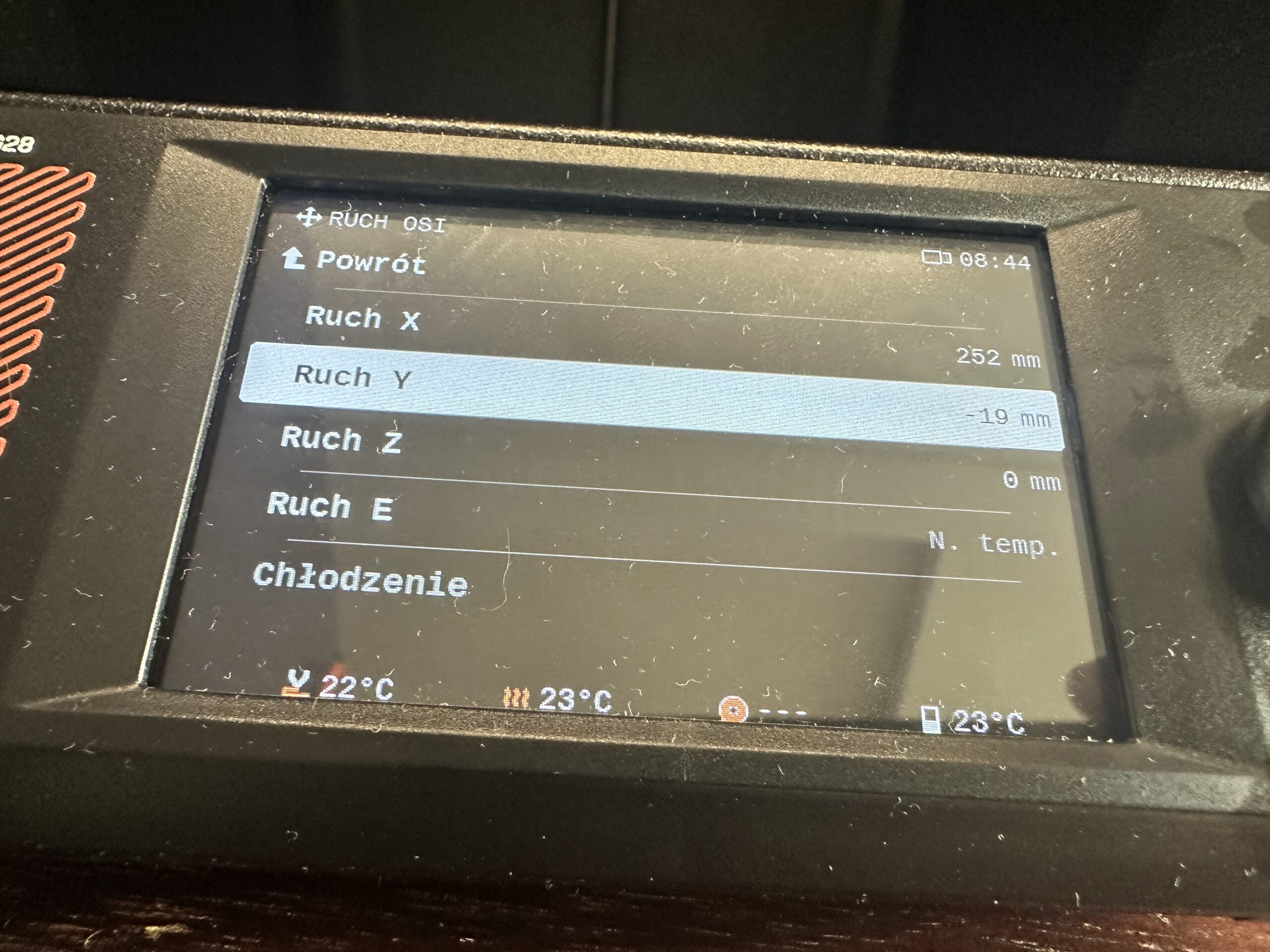

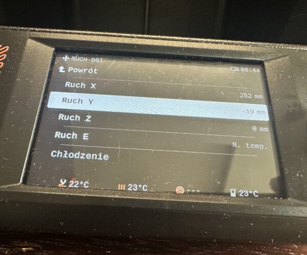

I read the posts about Y axis self test failed. Change the belt tension between 80 - 105 every ~5 Hz rerun the self test and it always failed. Y axis on the Edge position has -19 mm. I'm not able to fix it by any type of factory reset or doing multiple self testing. How I can normalize it so it will not have negative values?

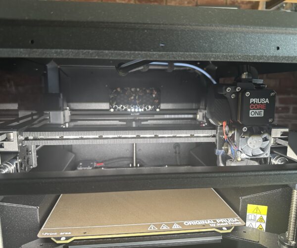

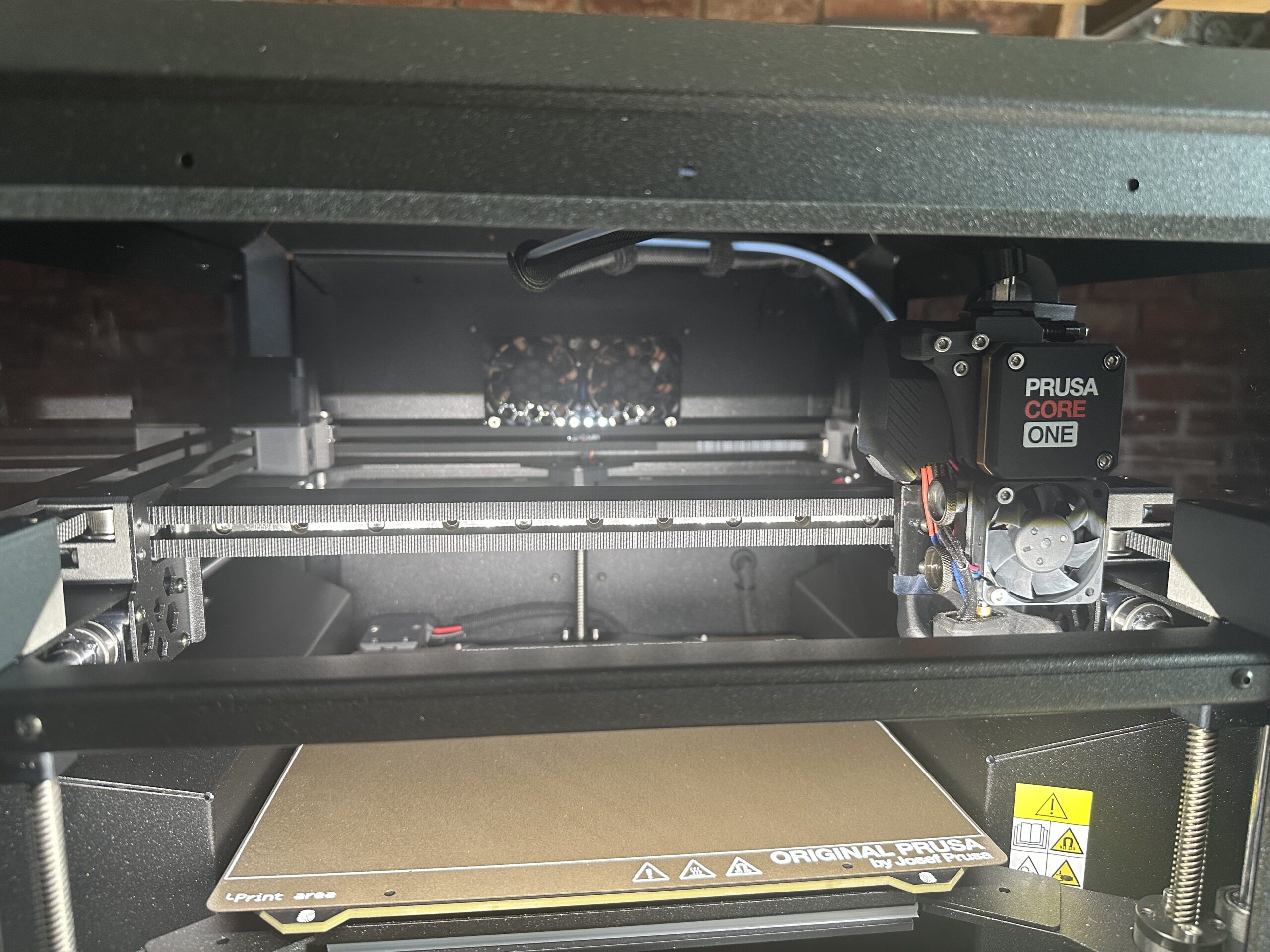

Placing the full steps.
1. I failed to properly mount the belts like on: screen1. The tension was to big and I need to disassembly something.
2. I screw out the left and right mechanism so the belt is loose: screen2.
3. Then I was able to make it right and it solve my problem: screen3
4. I set both belts to 94-95 hz
