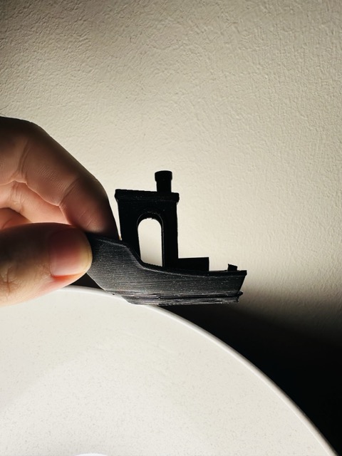

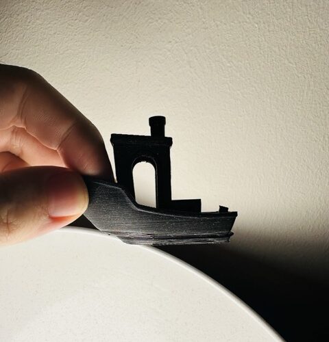

So after about 20 hours I have finally finished building my Core One + from my trusty old MK4S.
And I am starting to regret it.
Here's the symptoms of the problem:
  • Homing calibration consistently fails
  • No noticeable play/gap on either side
  • Belt tension perfect based on in-printer calibration as well as the Prusa app
  • Y Axis calibration mostly fails, sometimes it is succeeding
  • Printer shows -19 when Y Axis is moved all the way to the front of the printer
  • Z Axis calibration sometimes fails because Nozzle is too close to the door so the print bed actually hits the fan outlet at the back of the Nextruder instead of the tip of the nozzle
I am out of ideas at this point. Prusa support said something about rods/bearings not being smooth but I checked them thoroughly before assembly.
Trying to bend the X-Axis as shown here also did not make any difference:
Neither did loosening both belts completely and slowly tightening them again on both sides simultaneously until the tension was in the green range.
Edit: also this is what my first test print looks like:

After a lengthy chat session with support I was able to finally get the homing calibration to work.
Turned out that the belt tensioning measurements from the app and also the in-printer menu were completely wrong for my printer. I had to tighten the belts several screw turns more than what the wizards told me. Now I have already printed a benchy without any layer shifts, and now I am printing a small functional PETG model to see if this works as welll.
