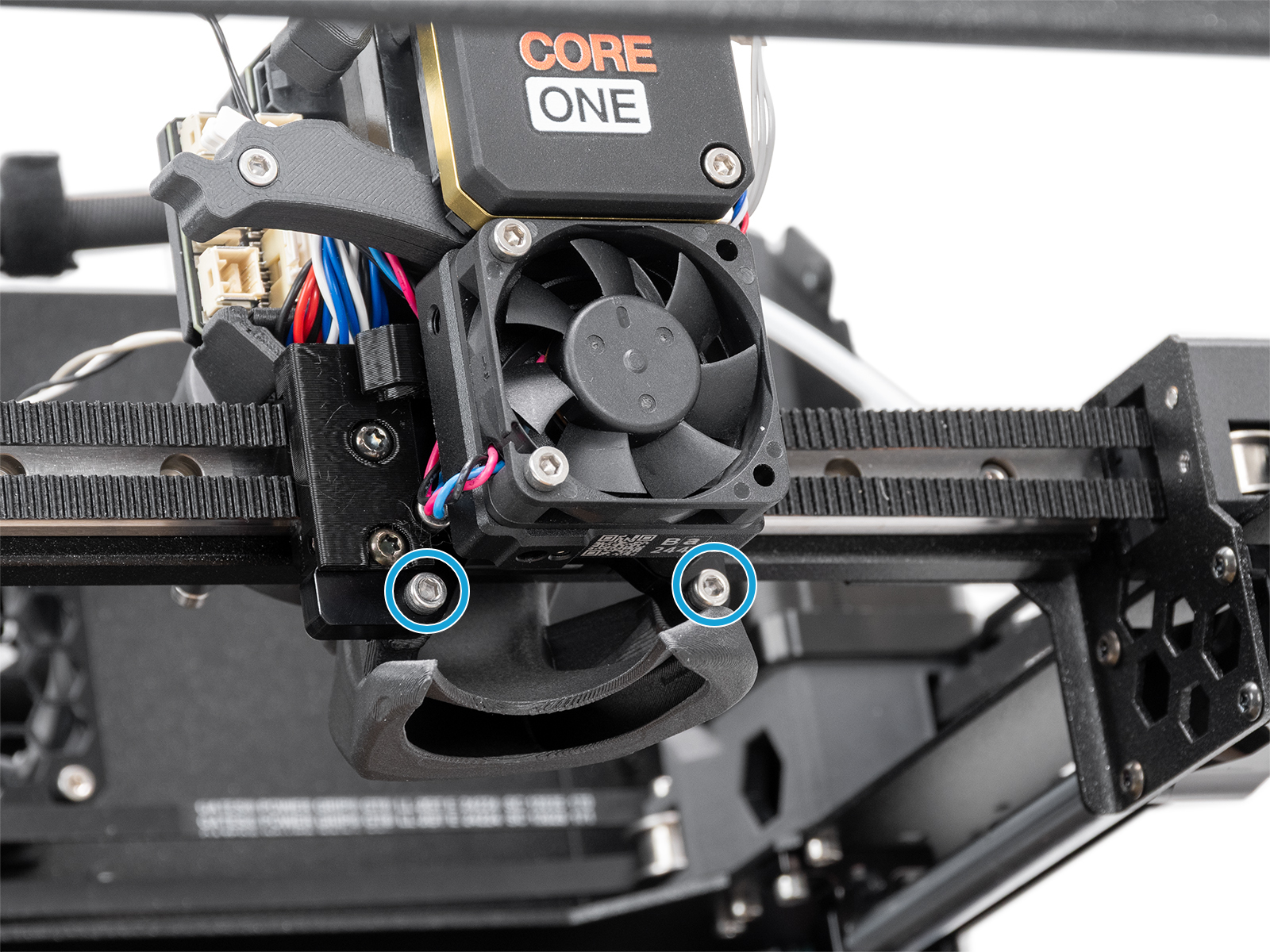

Check the screws holding the fan duct to the nextruder. Mine had a very similar noise caused by the screws rattling loose. I might try applying some low strength threadlocker to stop that from happening again.

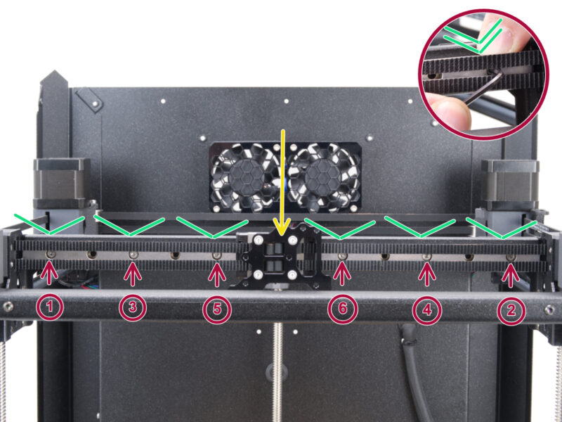

I saw somewhere that you can unscrew a little (by 1-2 turns) every screws from the linear rail, and them retighten them SLIGHTLY in the order showed on the building instructions. To be sure everything is straight, I move the toolhead close to each screw I retightened.
Surprisingly it helped a lot mine.

Posted by: @remix7657
OMG!!! This was the cause of mine. The resonance sounded exactly as shown in the clips too.
Mine started about two weeks after I had built it. I tried cleaning, re-greasing, various different belt tensions, re-aligning the frame. I stripped everything down to check the bearings, but nothing stopped it.
Then it started doing more head-banging during homing, and this was despite the carriage being perfectly "square" and belt tensions exactly 85/85.
Next I got two head-crashes reported during a head-banging sessions, which is when I remembered this post by @remix7657 and sure enough the two screws were very slightly loose (about an 1/8 of a turn).
Since tightening them, the resonance has gone and so has the excessing head-banging!
For reference, it is these two screws...
