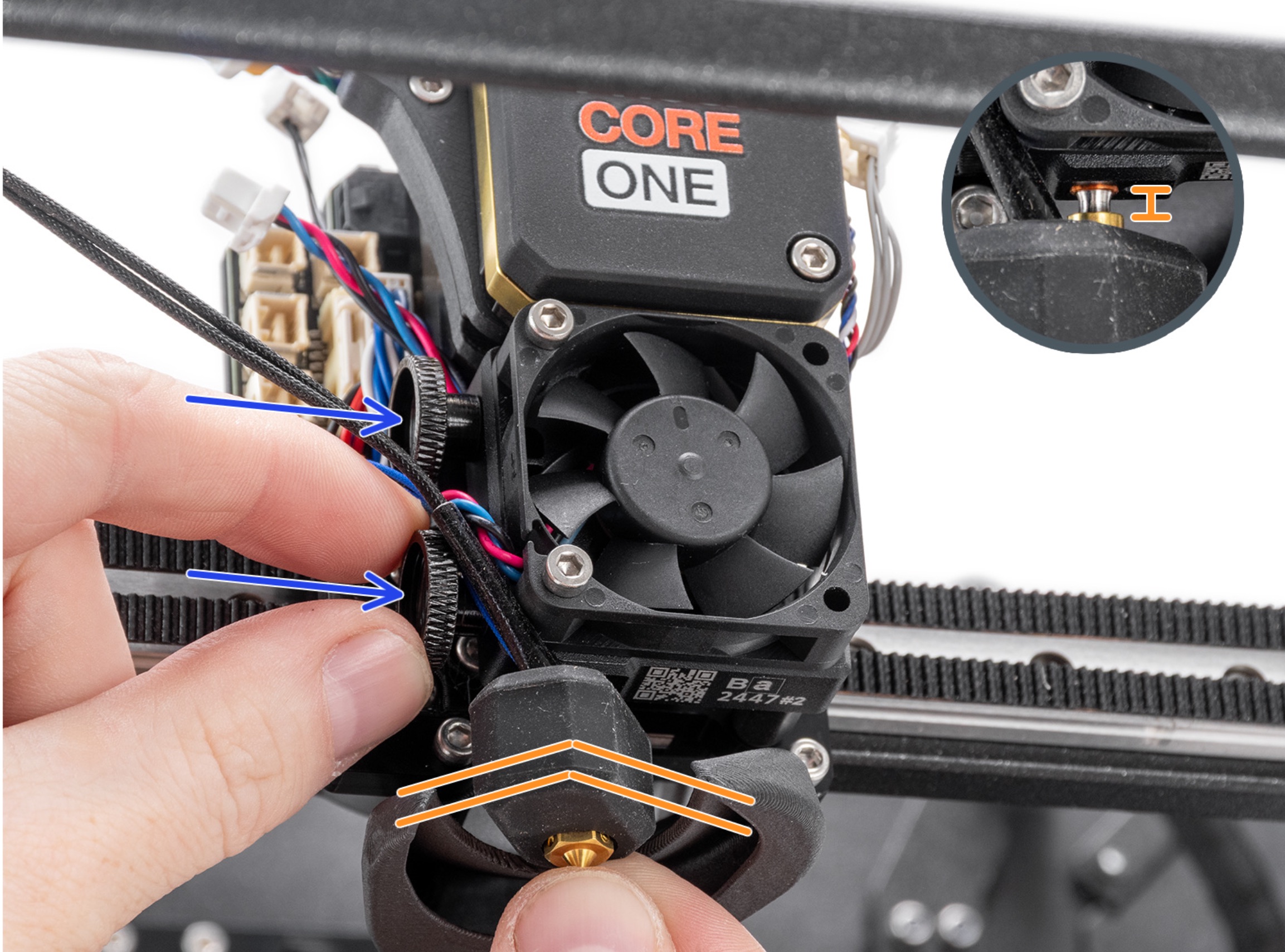

Hello i finished yesterday the assembly of the core one + and i cant find the reason why my Z-Calibration is failing. I tried lubbing the rodes, loosening the m3 screws. IMG_7056
I hope someone has a solution to the problem. Thank you for your help.
Best Answer by hyiger:
Your nozzle and heatblock assembly is not fully inserted. Loosen the two Nextruder thumbscrews, push it up until you see only 1mm of copper then tighten the screws. The heatblock with the silicon sock should never be lower than the fan shroud

Thank you! That was the Problem!
