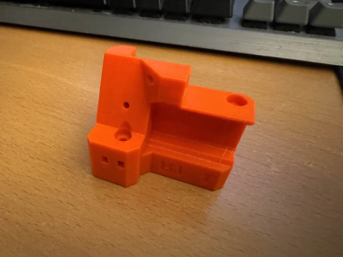

Hello,
I recently completed my Core One conversion and completed a print but it appears mirrored compared to my slicer? What could cause this to happen?
Posted : 05/08/2025 1:04 am
kat
 kat
(@kat-3)
RE: First print mirrored?
I had the X and Y motors mixed up on the mainboard, it should be fixed now that I've fixed that.
