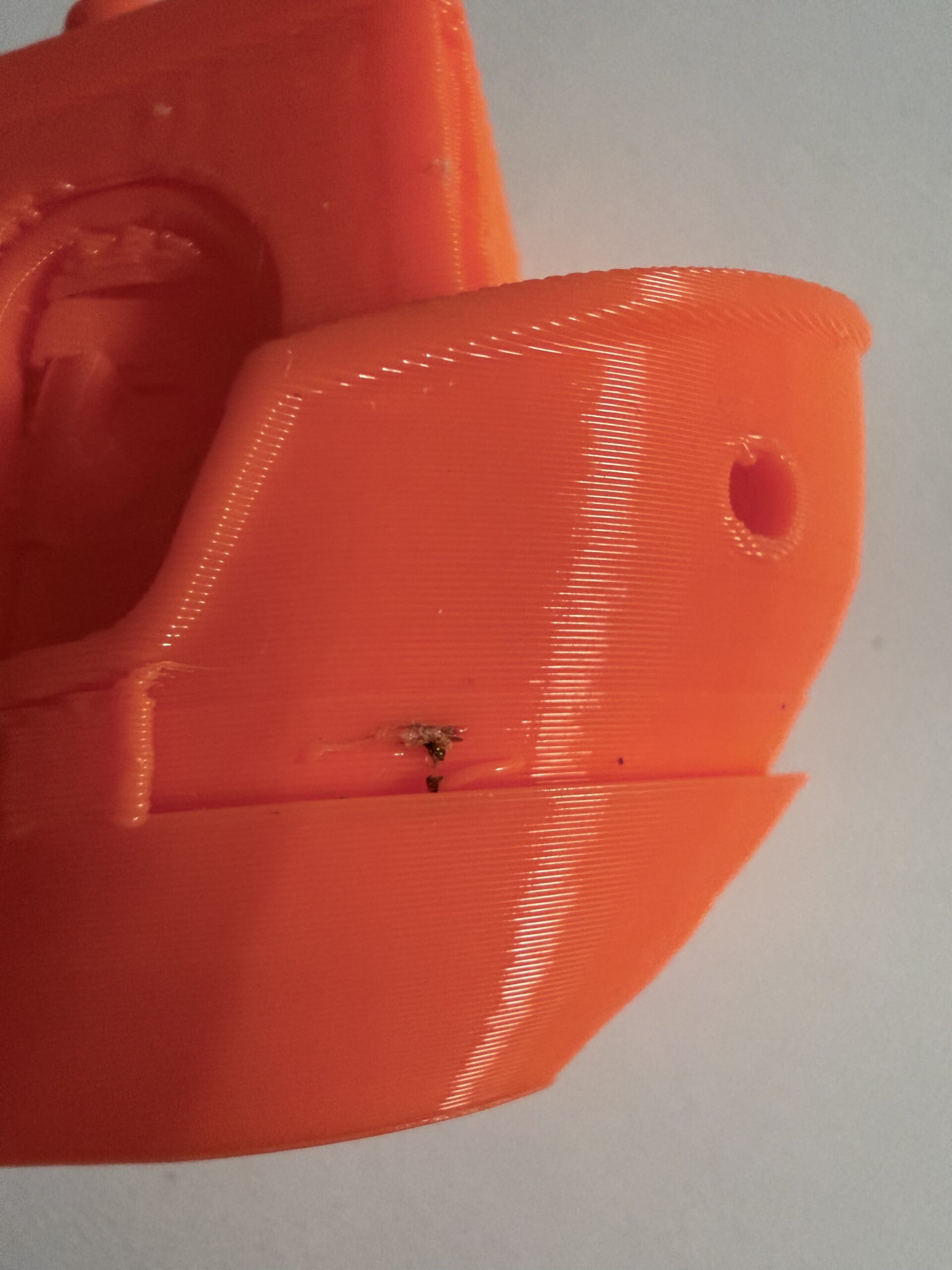

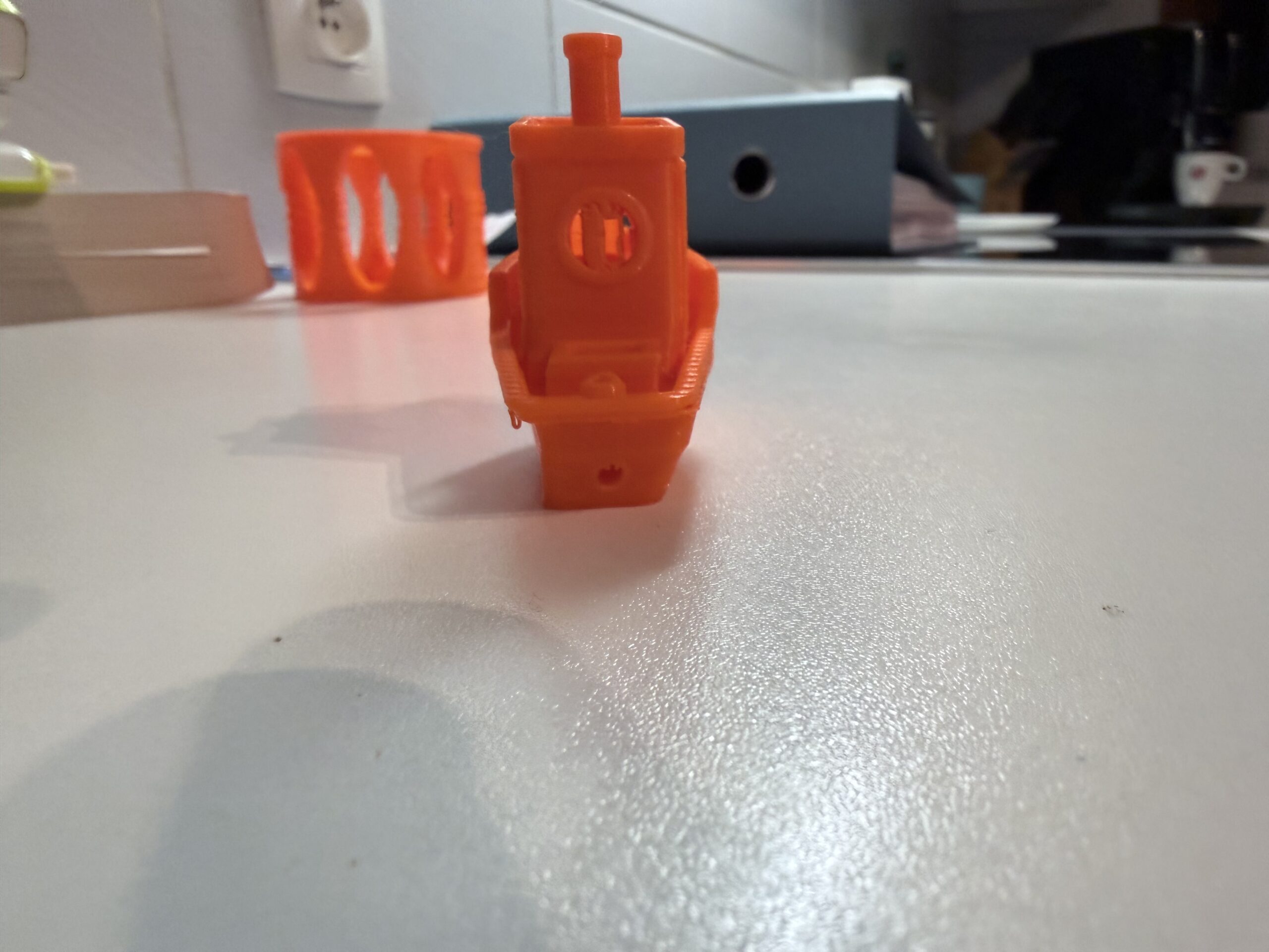

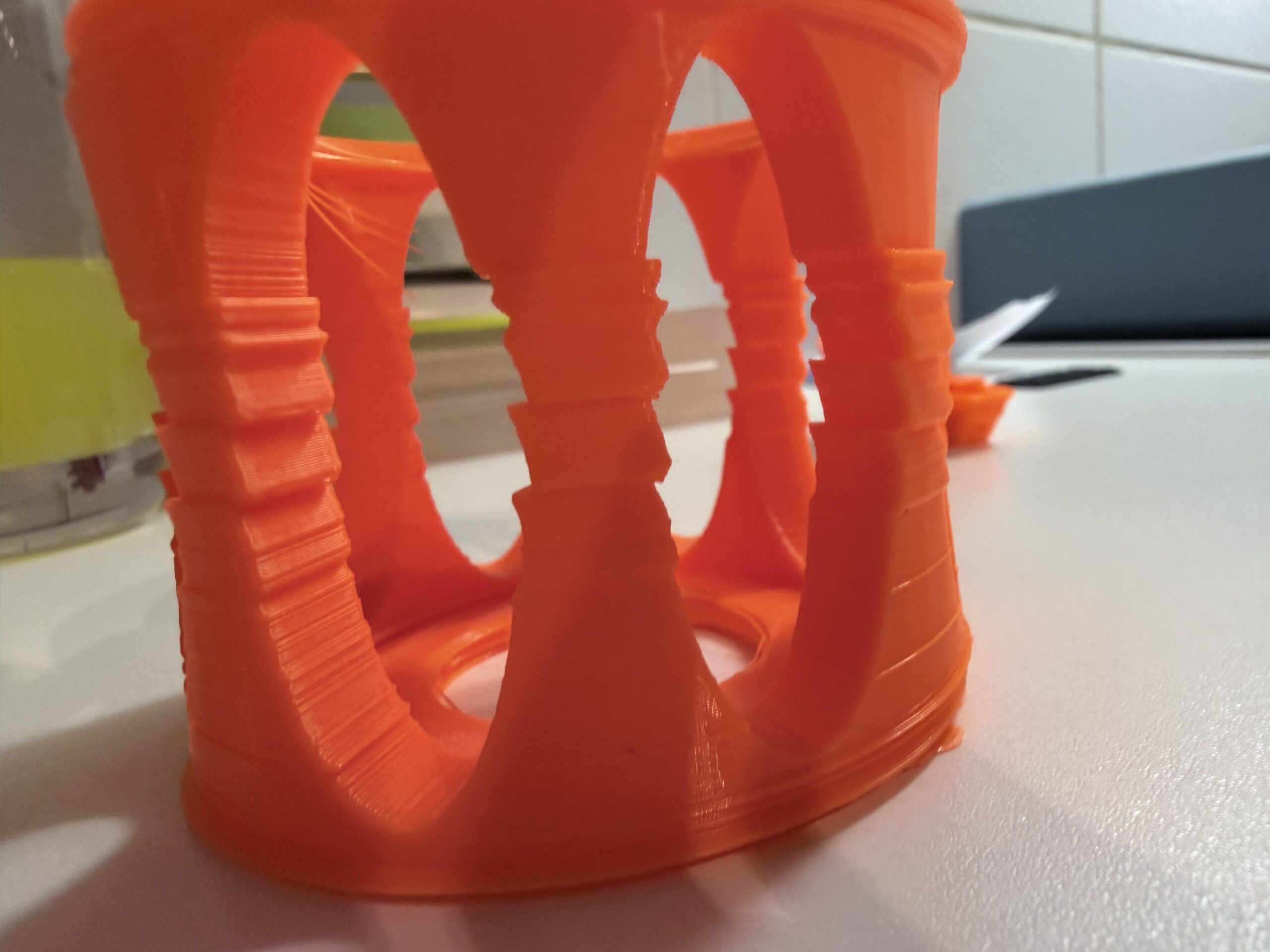

Whatever I try, I can't get a decent print out of my Core One. Had an experienced friend over yesterday, but neither could he. Recalibrated everything. The little boat was printed at a ridiculous slow speed of 10mm/s, the other model was printed faster, but not fast. There is always a shift. Any help would be welcome.

This is a layer shift caused by either belts that are too loose or the umbilical (main cable and PTFE) sagging and getting caught between the print head the an X motor.
First, is your printer a kit or pre-assembled? Regardless, run the manual belt tuning wizard and check the belt tensions.
