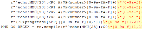

I have an MK3S+ with MMU3 and as of 12/26/2025 no publicly provided updates.  Apparently you can reach out to Prusa support for a download of 0.8.2 which sounds like it fixes this issue.  You can read the details here so much thanks to their research.  https://github.com/prusa3d/Prusa-Link/pull/1009 Here is what worked for me after reading that link.
I have a Pi Zero 2W on MK3S+ and the following worked (after the change and physical power down and up of printer. NOT JUST RESET BUTTON). Edit the file regular_expressions.py located /home/{YOUR USERNAME}/.local/lib/python3.11/site-packages/prusa/link/printer_adapter/structures
Replace:(should find 6 instances of it)
With:
\*[0-9a-f]{1,2}\.$"
Don't forget to power down entire printer not just reset button.  Then power back up.
After this procedure I was able to send print jobs from Slicer to Connect and see my MK3S+ as a valid printer instead of an empty list.
