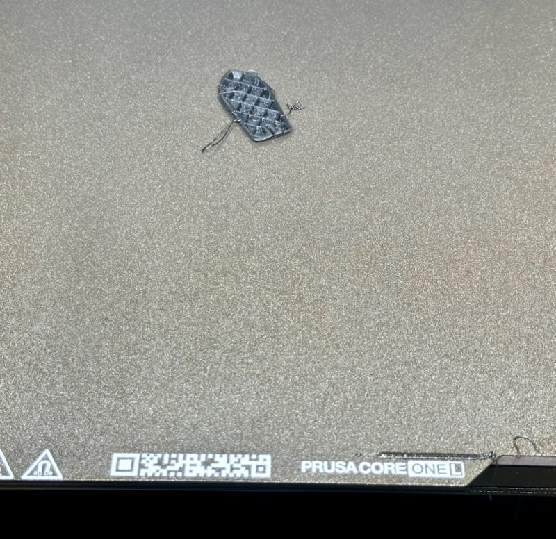

I have a brand new Core One L received less than a week ago and today attempted to do my first ever 3D print - a 3DBenchy in PETG on textured sheet.
Problem: after a couple minutes and a couple layers, the base portion already printed was rotated and moved as the newest layer was being added - the base was no longer fixed in the original position it was laid down in (i.e. bow pointing to the right). I immediately cancelled the print. See included photos.
Fix? Looking for help identifying the cause so I can fix this. I did find one known problem after the fact - in the slicer I had the wrong nozzle (0.4mm, instead of the 0.4mm high-flow nozzle actually shipped with the printer). I'm not sure how big an issue that is - so before I try again with that corrected, I wanted to inquire to see if anyone had any ideas about other possible causes and what I could do to fix.
Details:
  • Filament: Prusament PETG Galaxy Black
  • Sheet: CORE One L Textured Powder-coated Print Sheet - brand new, never used, never handled without latex gloves, cleaned before first use with 99% IPA
  • Model/Settings: 3dbenchy.stl by Prusa downloaded from printables.com into Prusa Slicer 2.9.4 on MacOS, with these being some of the slicer settings:
    • Filament: "Prusa PETG @CoreOne (modified)" (I think the "modified" is because I changed the default orange colour to black)
    • Printer Settings: Layer Height=First Layer Height=0.2mm; Perimeters=2
    • Print Settings: "0.20mm SPEED"; Filament: "Prusa PETG (modified)"; Printer: "Prusa Core One L 0.4 nozzle" <--that SHOULD have been HF0.4 nozzle!
Are there other settings I should check on?
Is my failure to set the nozzle type to HF likely to be a significant issue or not?
Any feedback appreciated.
Failed Print: benchy is rotated! Failed Print: benchy is rotated!
Top view of failed print Top view of failed print
Bottom view of failed print Bottom view of failed print

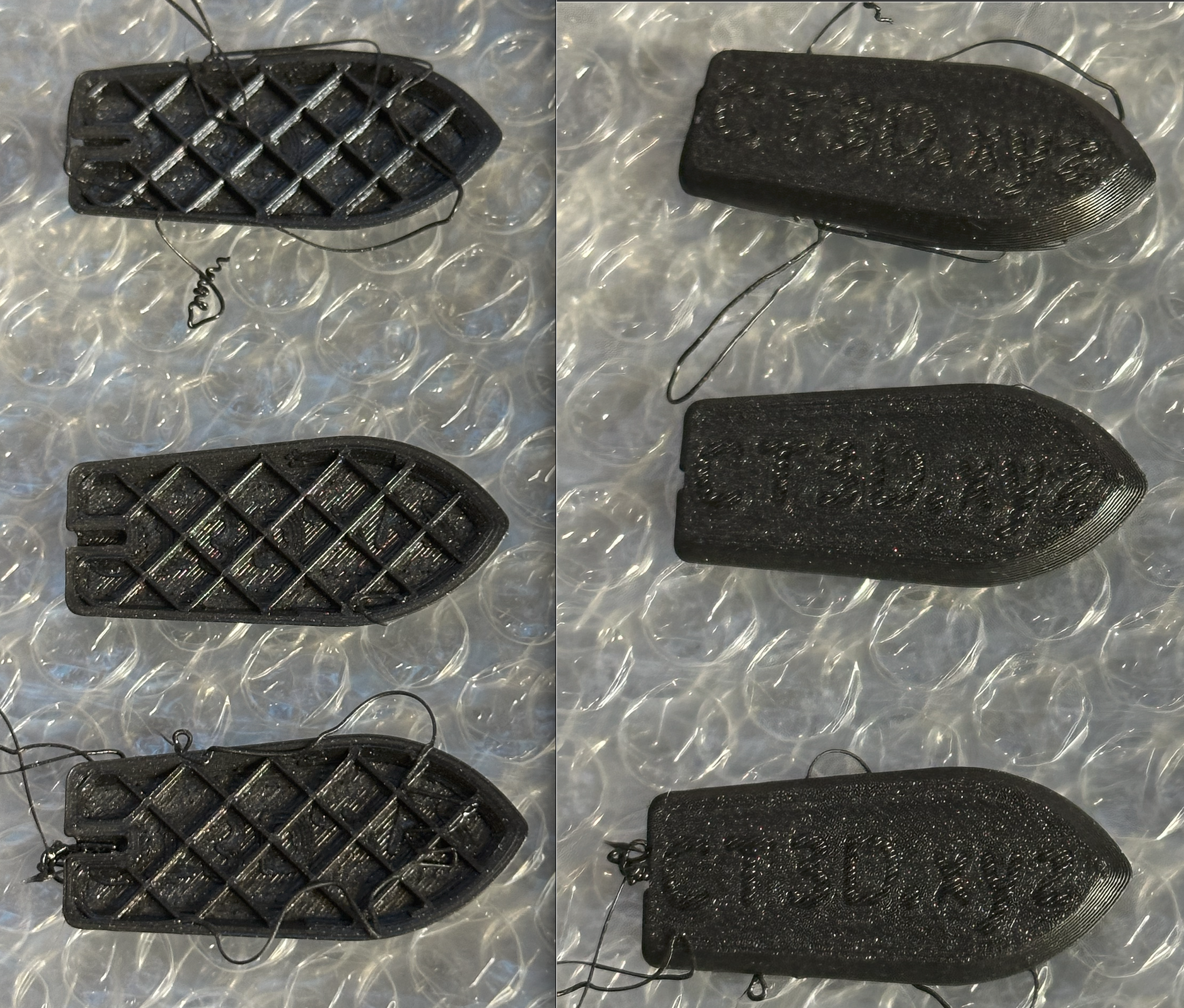

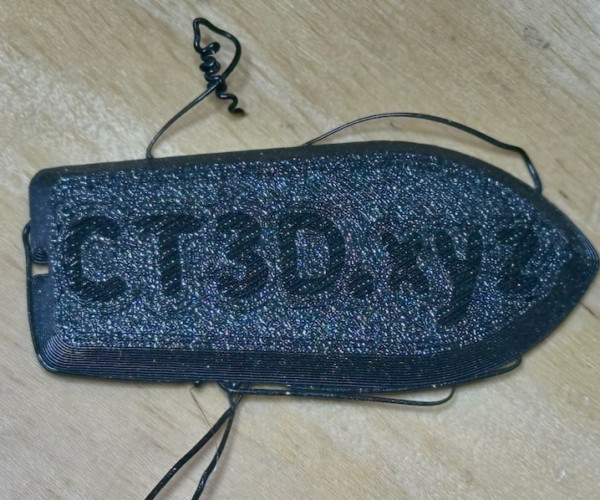

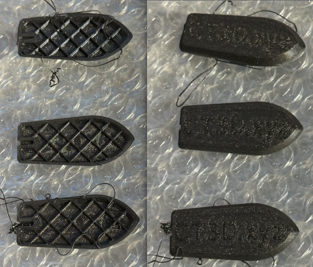

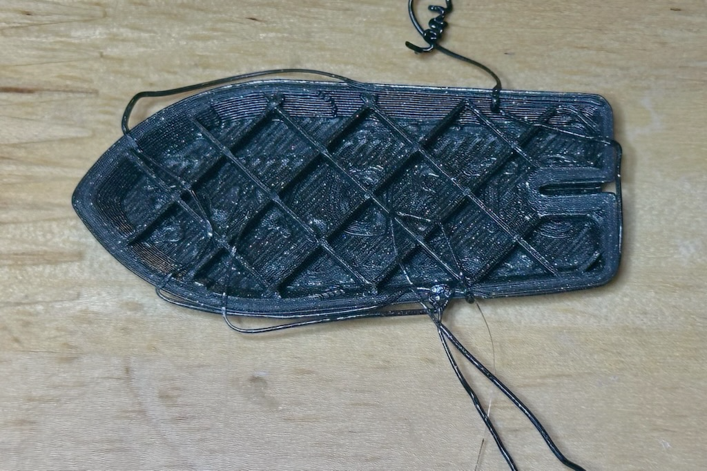

Before seeing the rest of the responses I tried two more times (with same results):
First retry: did this after thoroughly cleaning plate with warm water and Dawn dish soap using a new clean rag (Costco), followed by thorough alcohol cleaning and wipe down with a new microfiber cloth. Maybe I really did not clean it enough? I think I will retry with hotter water and perhaps a synthetic brush? (Don't have sponges handy.)
Second retry: tried with a new profile with z offset of -0.04mm (saw someone else recommending -0.05 elsewhere, so split the difference between that and what Ruebarb mentioned).
Not sure what to do next other than retry the cleaning. Re Ruebarb link for Live Adjust Z: if C1L even supports that (menus not as shown in linked article), it is really just doing the same kind of Z adjustment I did in the slicer: I can probably instead just pause printing after the first layer and examine/photo the result to see how it looks.
Any other ideas?
EDIT TO ADD: I used the Prusa 3D benchy from printables (since the bgcode version on the provided USB was for PLA). Link: https://www.printables.com/model/3161-3d-benchy
Three tries, same results (same failure)

Thanks. Will definitely try something simpler next time: the included keychain is very simple, will try that after another/better plate cleaning. But will also see if anyone has any other ideas!
Posted : 06/01/2026 5:16 am

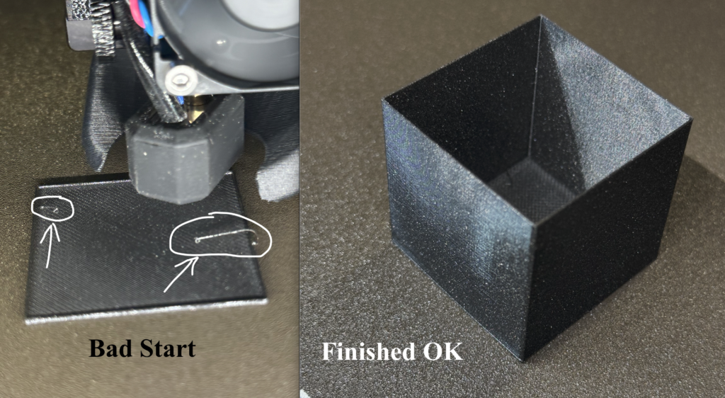

Use the Live Z file I gave you in this post (Bottom), https://forum.prusa3d.com/forum/postid/776776/ It also includes the filament profile this PETG, you'll need to adjust the extrusion based on your cal cube testing.
If you can print this simple file successfull, should come off the bed as one perfect piece, and all the layers are bonded together without gaps (Hold it up to a light) and the surface is also not too rough (too low). Like the Prusa article states. Then you should have solved your adhesion issue, assuming your plate is clean.
You can make adjustments while the print is going, do each corner square at a different setting, give you some idea which offset is correct or you can just print the entire file with different settings in the printer profile. Doing it live may be more than your skill level at this time.
