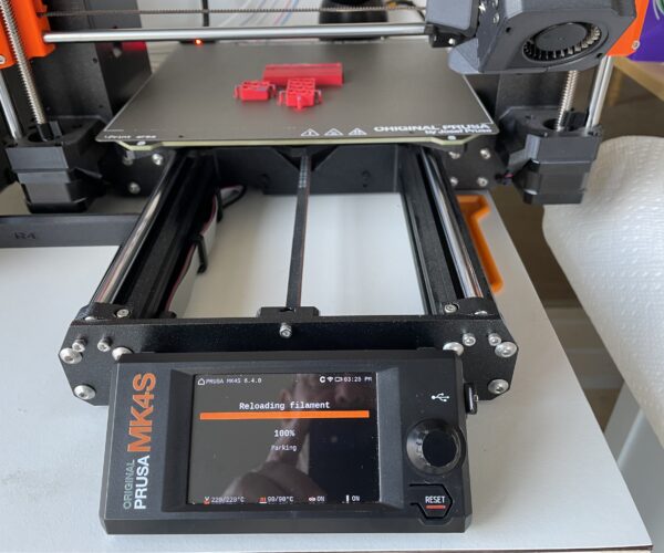

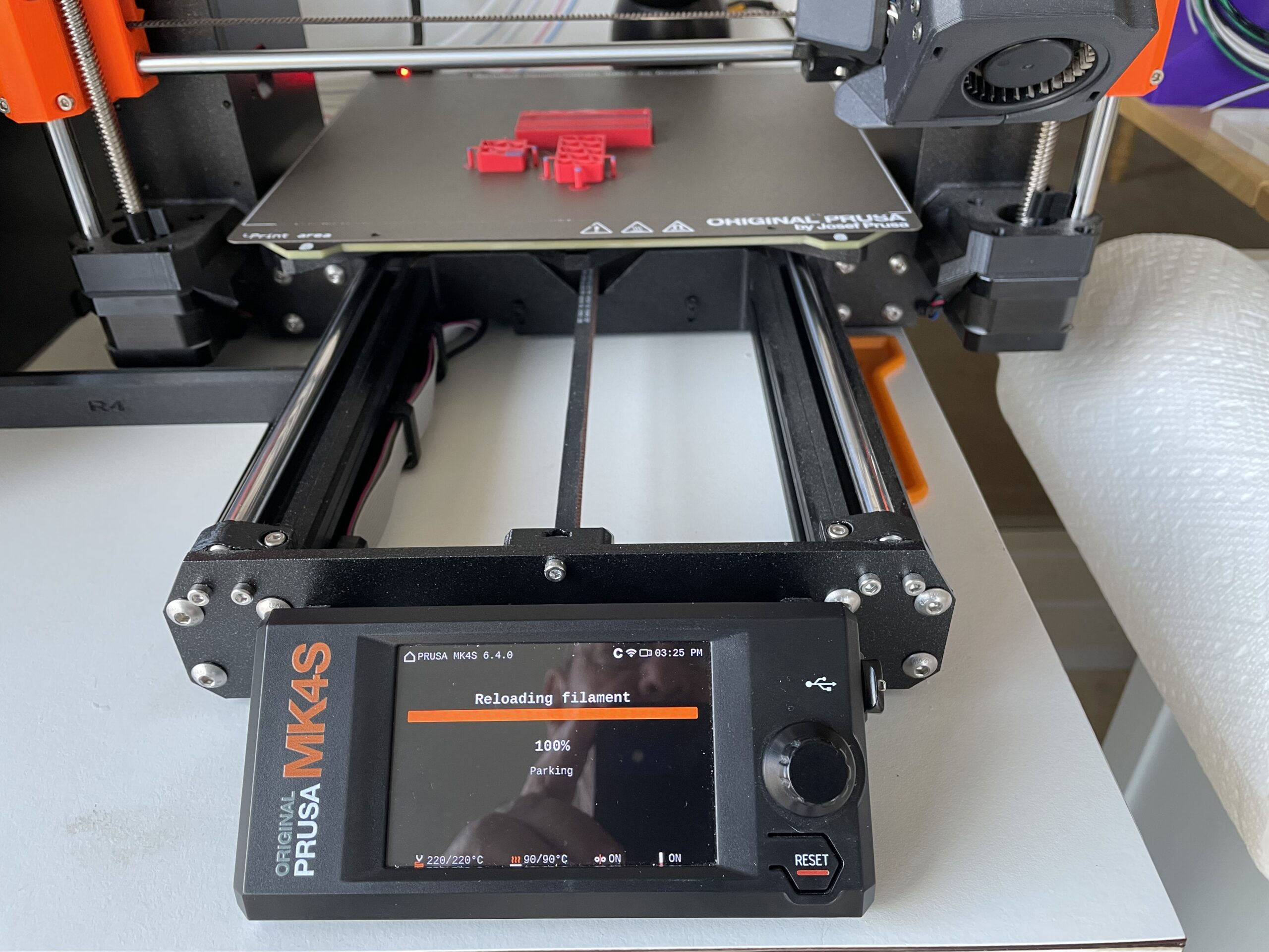

There have been a number of fixes and improvements that I noticed right away with this new firmware. There were however a couple of unexpected issues.
The first couple of "gentle homing" started with what sounded like gears being stripped. This was very loud and quite disconcerting. Thank goodness that no longer happens. Things are quite quiet now.
The second issue is with filament/colour change. Once the filament has been purged and the user selects that the colour is correct the printhead moves to the start point. As previously, there is a small blob of filament extruded before the nozzle starts to print. This blob always deposited in the worst place possible. Nothing new here. What is new is that the once the printing starts there is very little filament laid down for the first 50mm or so. Almost looks like dotted line. After that, everything prints normally.
I have been printing the same type of things recently and this issue only started after I updated the firmware to 6.4.0 yesterday. I hope this is resolved soon.

Here is a picture of the filament colour change issue that I referred above. The top left red circle is my 3mm purge post that I use to catch the blob that you always get with a filament change. Although it is a little out of focus you can see the blob on the side of the port. The lower red circle is the first item printed on the part. You can clearly see how little filament there is in this situation.

thoemmeli
(@thoemmeli)
RE: 6.4.0 Firmware for Prusa MK4S
Today I had my first occurrence of "Filement wiederladen, 99%, Parke" (German for "Reloading Filament, 99%, parking") where the printer (MK4s+MMU3) got stuck. I have preloaded the filament to the print head and answered "No" when I was asked to change the filament.
After a reset and restart the print, the loaded filament was unloaded and reloaded correctly.
