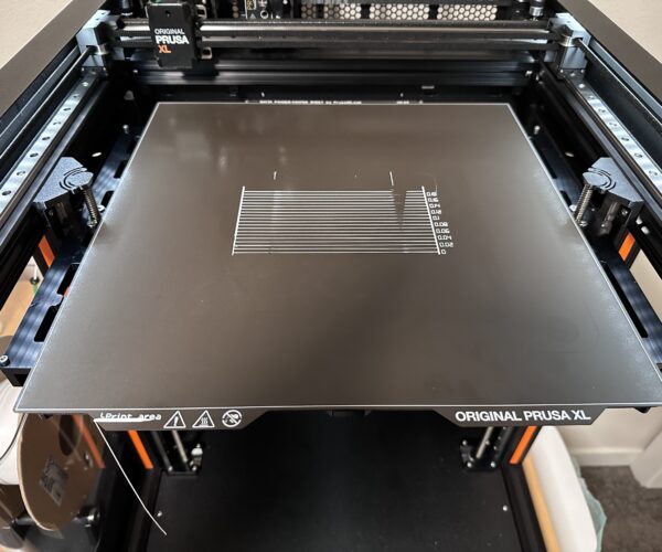

Some results! Here you can see the pressure advance pattern, but with the Prusa specific startup code as indicated by the purge string and wipe in the lower left corner:
Here is a close up:
This is PETG (Printed Solid's, very dry). I did a pass from 0.03 to 0.06 in 0.001 increments. Its looks flawless on camera, I had to use a 3.5x magnifier to see but I get 0.047 - 0.05 looked the best. The value for Prusament PETG in the slicer is 0.32.
I've done a lot of printing on a Voron 2.4 and if I don't get the PA value correct I get messy nozzles. Once its set right I get a very clean printing machine. I've been having the same problem with long single-color prints on my XL. So my suspicion is that I should be tuning this just like my klipper machines.
I would like to release this as a web tool. It understands printer profiles, max volumetric flow rates, filament overrides etc. I've tried it on a friends Prusa Mini and my XL. Preparing a test takes less than a minute.
Would people be interested in trying it out?
Posted : 13/11/2023 4:59 am
