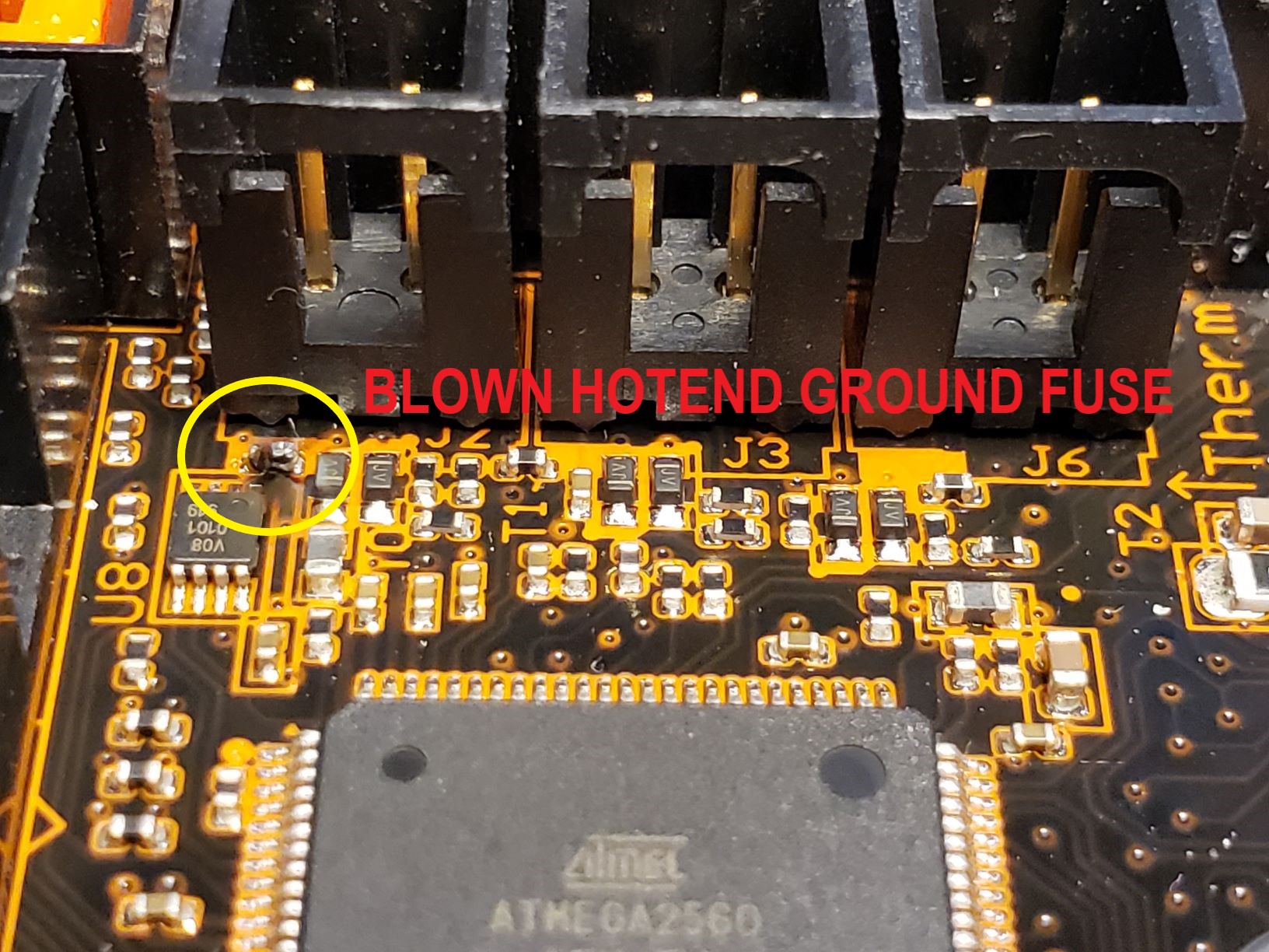

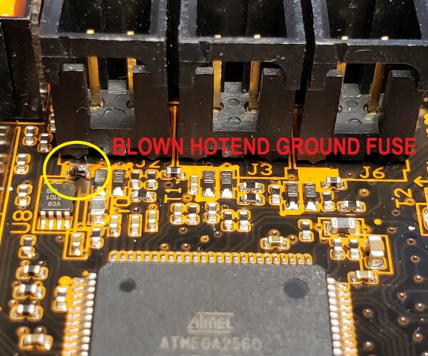

I blew the hotend thermistor port in early January on a 10 month old MK3S. For the price and and possibly a 2 month waiting period to have it mailed to me and be down that long, I decided to see what blew and how to go about fixing it until a more permanent solution could be decided. First, I checked the inputs of the thermistor inputs. I found that a good input will measure 5V across it. For mine, I had this on the bed and spare thermistor inputs, but not on the hotend. A closer look at the board, near the hotend input (J2?), I could see the blown SMD fuse.
With some quick checks, I noticed that the ground pin of each thermistor input appeared to be the same. I placed my multimeter's negative on the spare input negative pin while leaving the positive lead on hotend +5V terminal. I read the +5V!

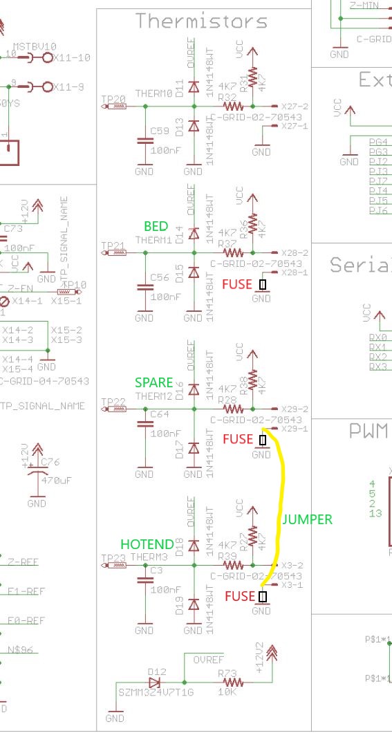

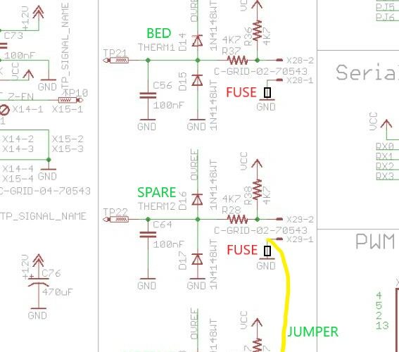

I hunted online for the schematics for this version of RAMBO or REPRAP board. The closest I could find was this one...
It's not quite accurate, as it shows 4 inputs to the RAMBO's 3, and no fuses on the ground side of each input. I added the fuses and arbitrarily labeled 3 inputs for simplicity of explanation.
If you have this problem, blown fuse by the absence of 5V across the hotend thermistor input, outside of buying a new RAMBO, you have the following choices:
1. Reconfigure the firmware to recognize the hotend thermistor on the spare input. Not for me. I wanted to be sure any future firmware updates while still be compatible without having to modify each time.
2. Replace the blown SMD fuse on the board. You have to be good at soldering. I tried to remove the old fuse, but it melted the electrical traces so no chance of soldering a new one in its place.

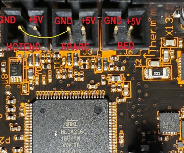

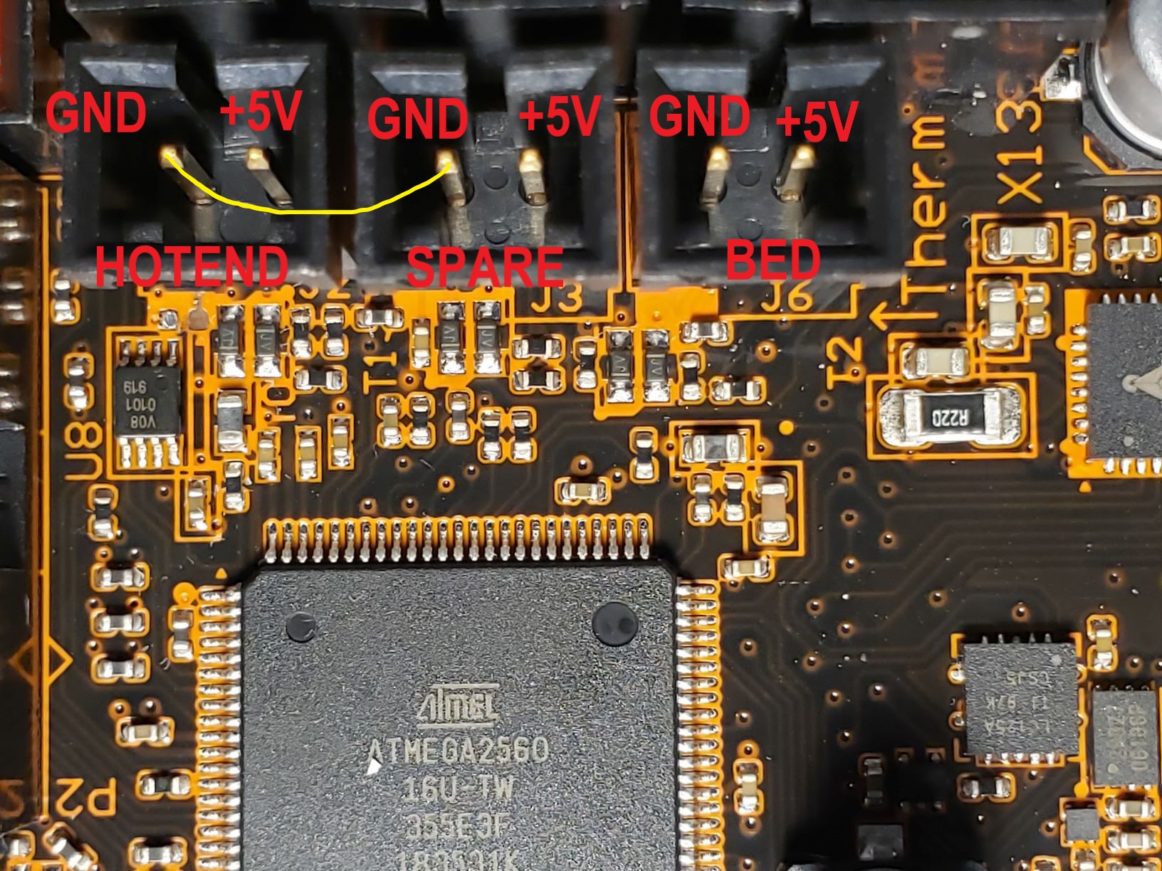

3. Use the fused ground on the spare since it's not being used anyways. To do this, you can either solder a jumper wire on the back side of the RAMBO from the GND pin of the hotend to the GND pin on the spare input. I did this BTW. If you are not good at this level of soldering, you can use a jumper wire with a female Dupont connector on it and plug it into the spare GND terminal, and somehow tie it into the thermistor wire of the hotend thermistor GND wire. Soldering might be best for this.
Since I chose option 3, my printer has been running fine since then. I feel like this is my permanent solution. I've warned myself that I shall observe care and attention when cleaning my hotend the next time. Ultimately, I think I might get some 63mA picofuses and solder a fuse from the hotend GND terminal to a ground point on the board. Mostly likely when I blow the fuse on the spare input.

Yes you can do that. More simply, if you do have an extra connector, if you can pop the wire and pins off it so you now have a spare connector, then pop the GND wire off your thermistor connector and plug it into the left position on the spare connector and plug that one into the spare port, no soldering at all. Just confirm that you cannot see +5V on the hotend port, but when you move the negative multimeter probe to the negative pin on the spare port, you can now see the 5V. If so, you should be able to physically see the blown fuse on the Rambo.

You my friend are a genius. I couldn't see any burn out signs on the board front or back. Through the back of the Einsy board box I tested the voltage across the hot end thermistor and got no voltage. I then connected the tester from the +ve terminal to the gnd on the spare (again by poking the tester leads through the back of the casing) and got 5v. I disconnected the connector plug from the defunct thermistor. Easier than I thought it would be, but was now on a roll. I disconnected the gnd wire from the new thermistor and put it in this spare connector. You know where I'm going, I'm sure. I then put the connector from the new thermistor, with only the red cable in it, into the proper position on the board. I then put the other connector which now has only the gnd cable in it into the spare thermistor spot. Switched on, with fingers crossed and after a few seconds as it did its start up procedure the LCD panel lit up with no error message and showed the thermistor temperature. All this indicating an effective repair has been done 👍 👍 🤩 Brilliant and thanks very much.

If you can get a thermistor connector you don't have to solder anything. You are trying in effect to connect the black earth wire from your existing thermistor to the neg connectir in the spare thermistor port. So you take the neg wire out of the existing thermistor connector refit the thermistor connector into its place on the board. Then you have to connect the negative cable to the negative position on the spare thermistor port. Either by soldering wire the the negative cable and using like as suggested a Dupont connector to make the other connection to the spare thermistor port.
