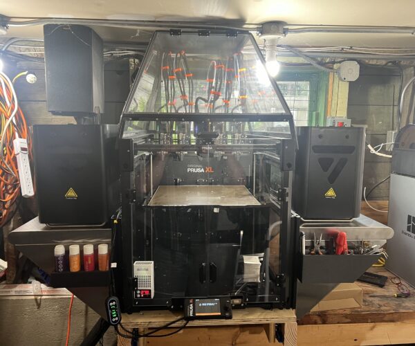

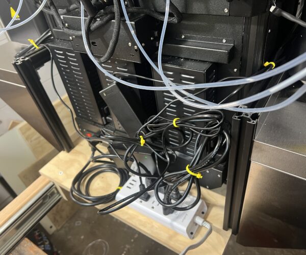

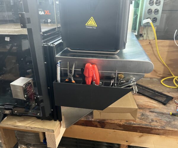

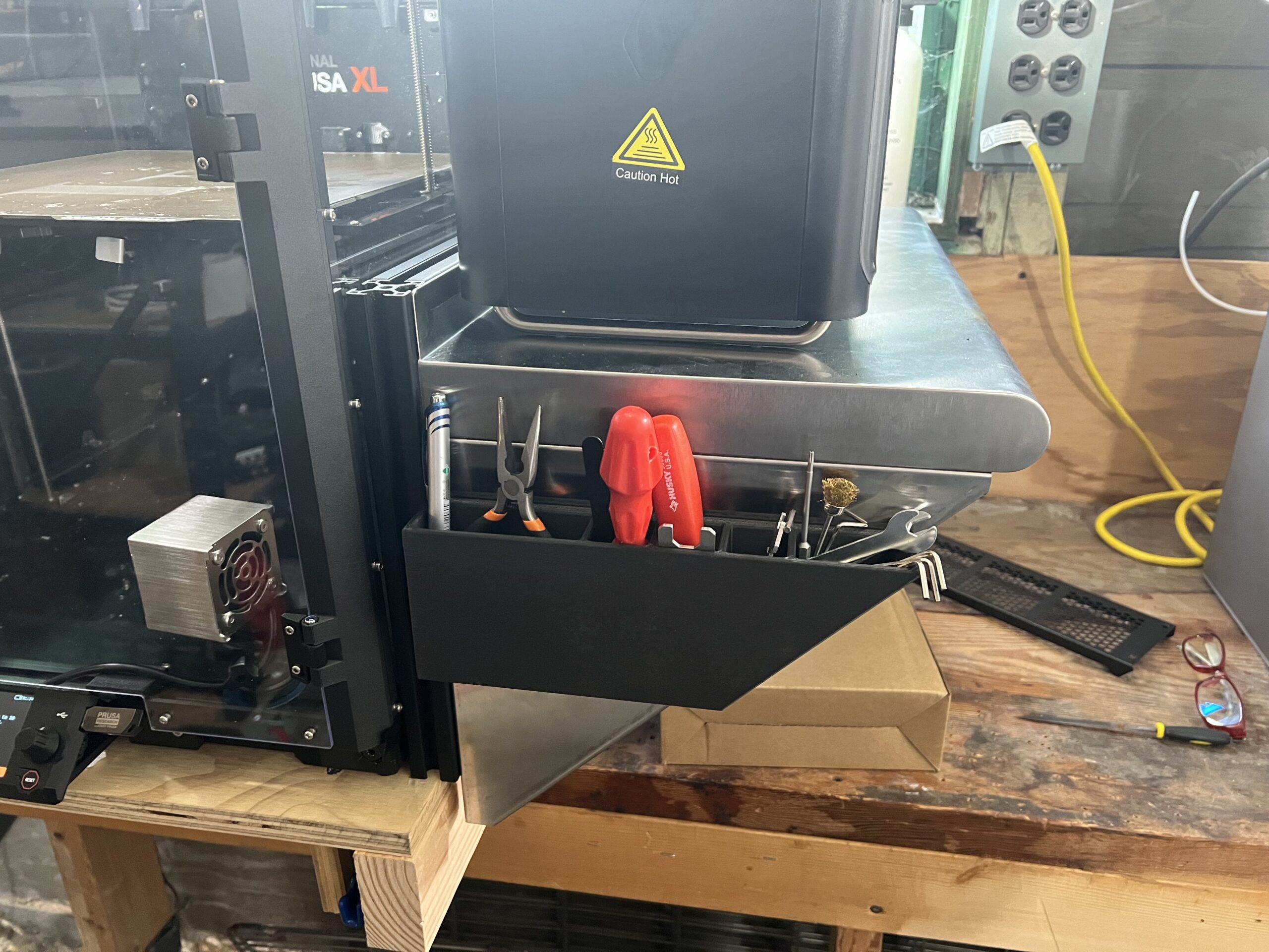

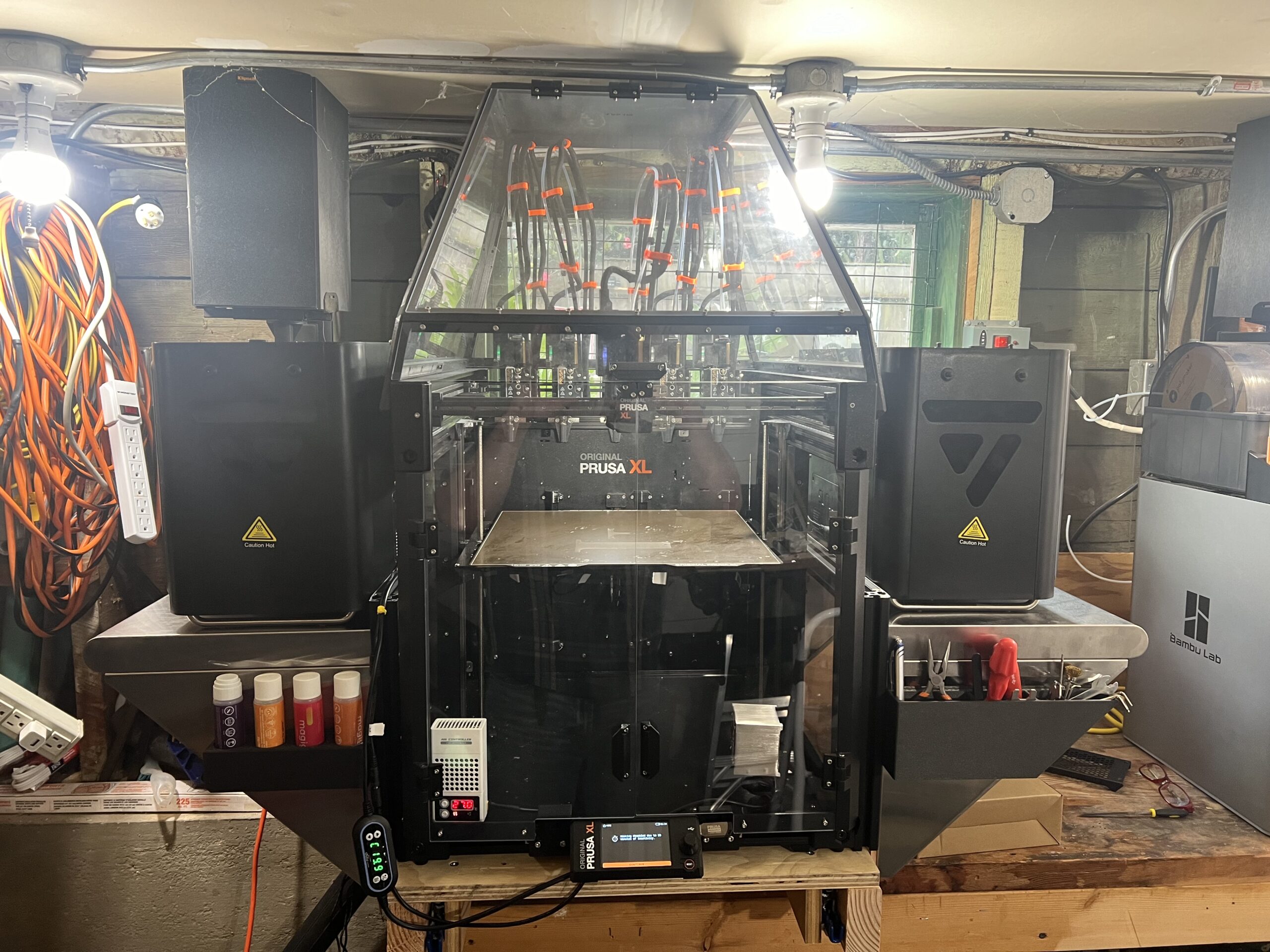

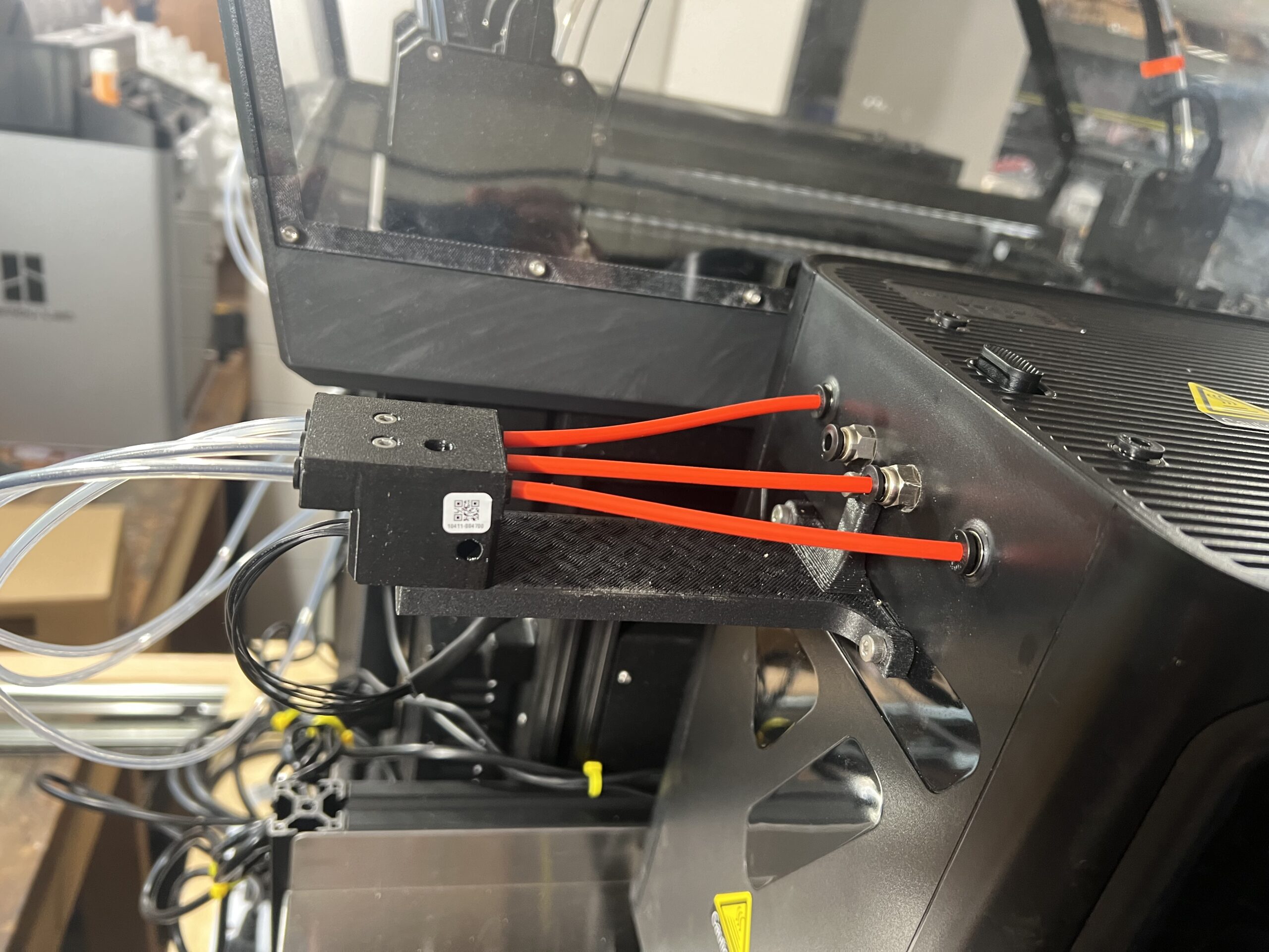

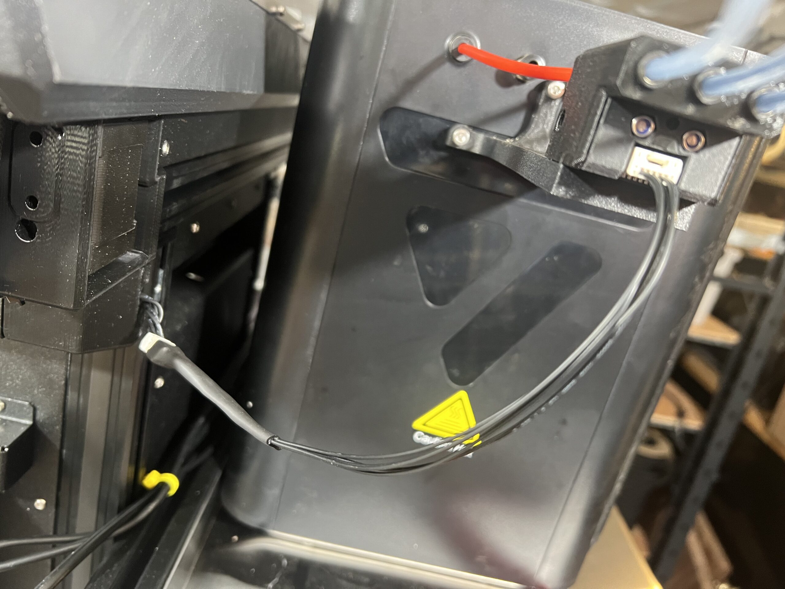

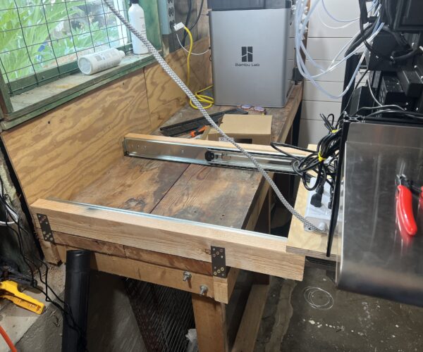

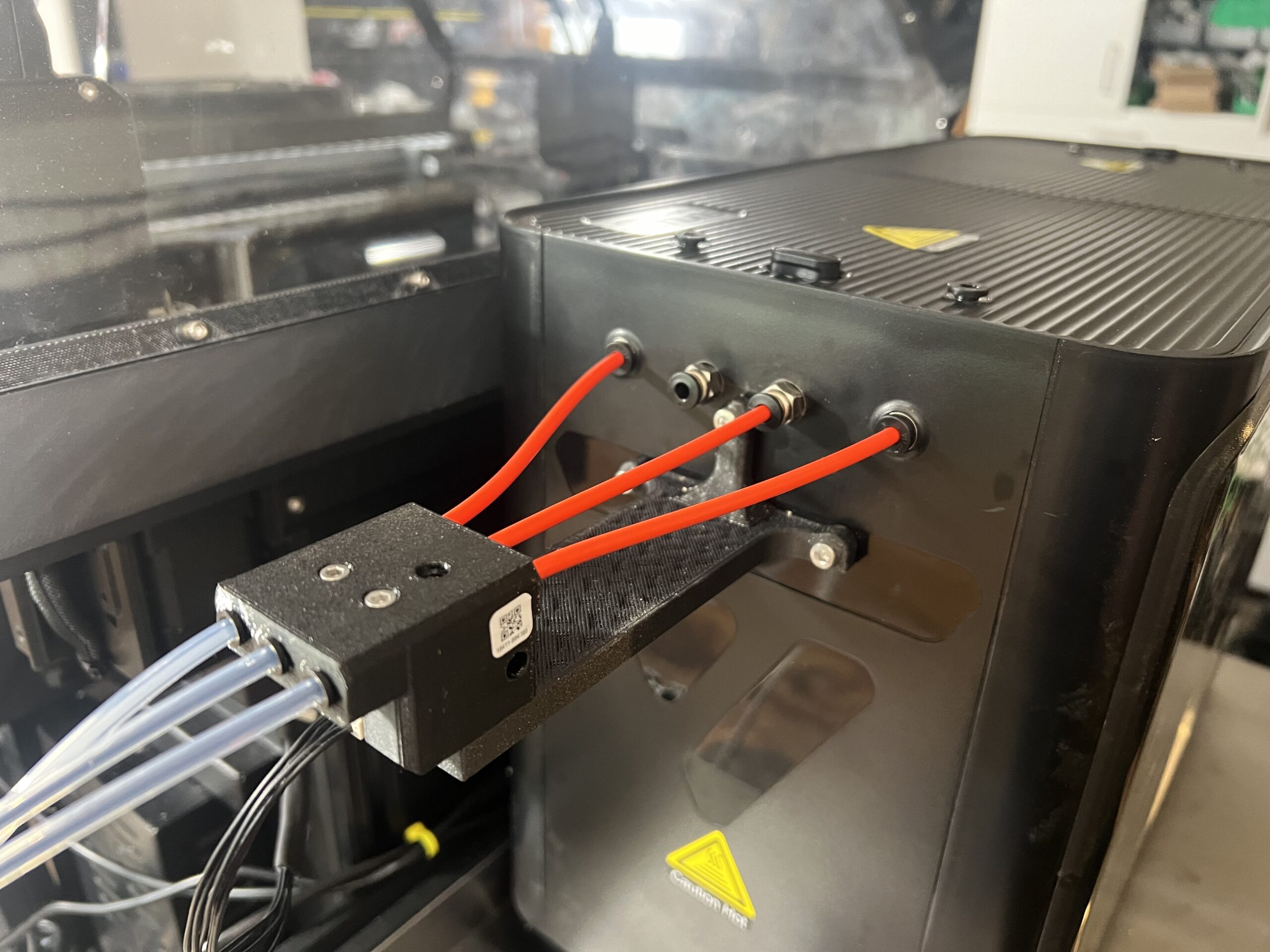

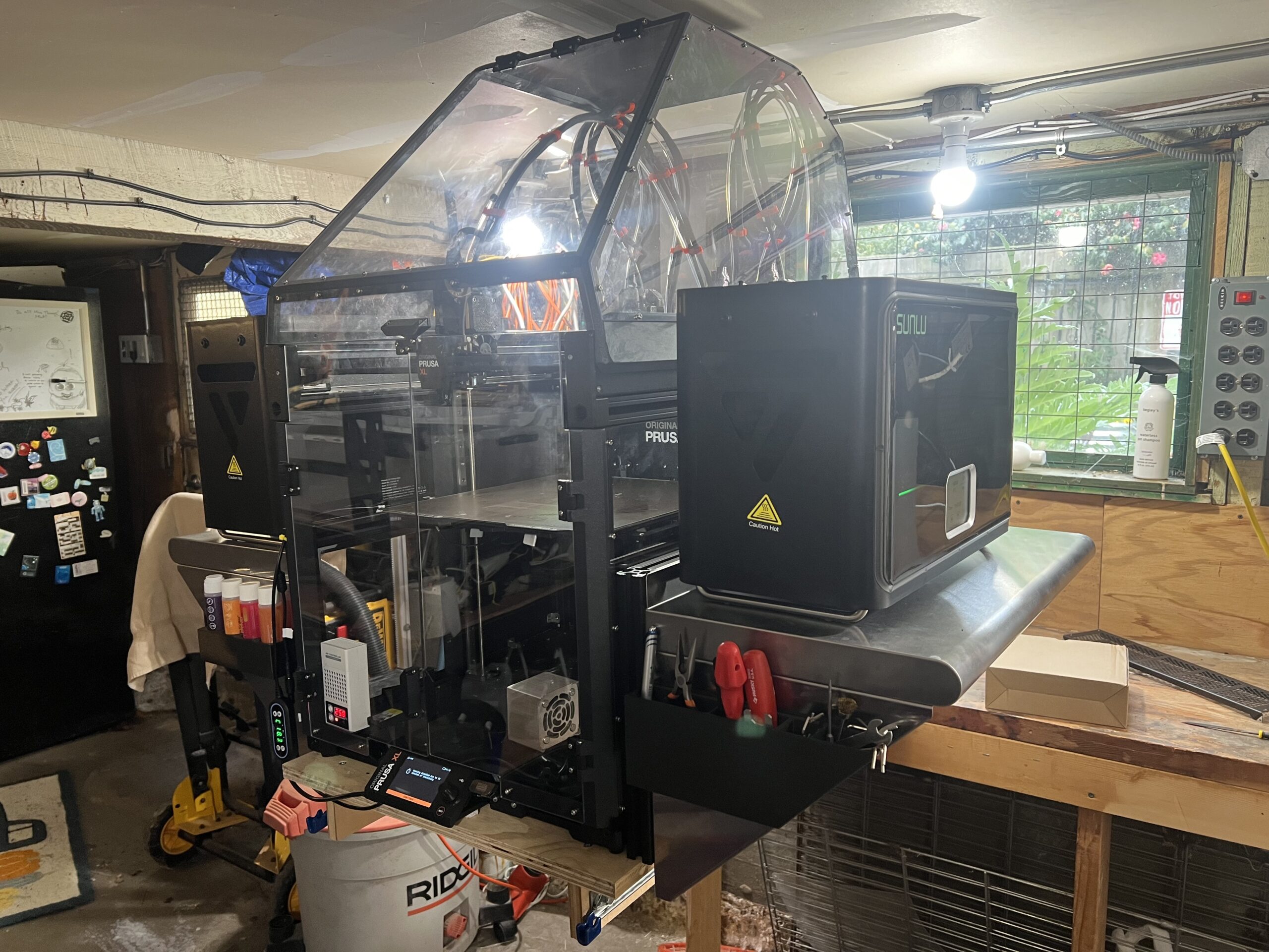

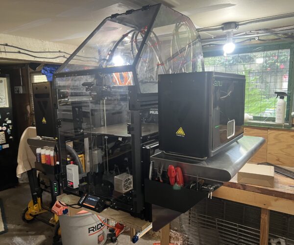

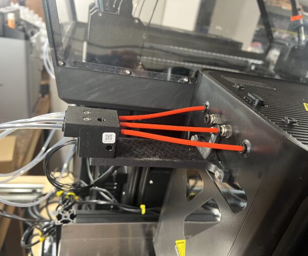

Hi all,
I thought you might like to see my Sunlu S4 setup.  It's a very useful dryer for the Prusa XL.  I added shelves to the sides of the XL for the two S4s.  I also printed new mounts for the filament sensors, made extensions for the filament sensor cable, and had to use longer Bowden tubes for tools 2 and 3.  The whole setup rides on a sliding shelf since it's very useful to have access to the sides and back of the XL and it's sort of a beast to move around!  The S4s are just the right size for the XL and so far everything is working very well.

1st and 2nd photos make me think of this 😁

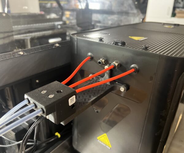

Looks interesting. Do you have a picture of your filament's path inside the Filament dryer?

Chris
(@chris-2)
RE: Sunlu S4 setup
Hi @peter-larsen,
Sorry for the delay.  Here are a couple photos.  It's not complicated.  The spools at the back feed a fitting that I added at the front.  The spools in front feed into the original S4 fittings.  From there they go to a new filament sensor attached to a simple bracket that I added.

Fisherman
(@fisherman)
RE: Sunlu S4 setup
Could you please post a picture of the inside of your Sunlu's with the extra PFTE holes, was thinking of doing the same to have all filament coming out on one side.

He allready did that in his answer to Peter Larsen from the 5th of june! 😉
