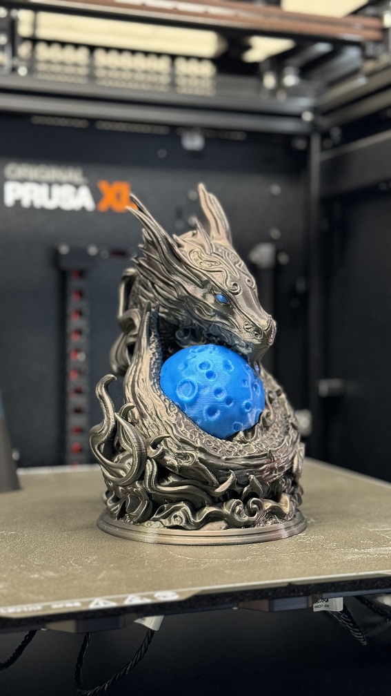

Over the course of the last few months i have posted more than my fair share of bad XL Multi tool experiences. I had been working back and forth with a couple of different prusa support support agents . We have been ongoing with everything from dock mounting, pre-installed nozzle sets , belt adjustments , Z-RODs , custom g-codes and even YGK3D custom bump block . All this was to resolve the extremely bad very random layer lines, layer shifts and overall poor quality in general .... but ONLY when using the multi tool function . Using the machine with single extruder only worked perfectly . Well about 2 months ago i had gotten to the point of frustration cancelled my other 2 pre-orders for other XL units and purchased a Bambu X1C with AMS for my multi color options. It is a great machine for sure within its capabilities but like anything else it does have its pros and cons but that's not what this is about is it ......... 😀
There was one tech who i was working with at Prusa support , his name was Rodolfo . I had stopped even trying to contact them anymore because i wasn't getting the results i had expected and readjusted to use the machine in a different projects . Out of nowhere ( 2 months after the last communication ) i get an email from him asking how the machine was and if i had any progress with it . I have sent a long winded email about my overall dissatisfaction with this particular machine . The next day i got a follow up email with a very apologetic response with a link to an updated firmware and a link to the added procedure of lubricating the coupler pins (link here) So with that i updated the firmware , greased the 3 couplers on both extruders with the Prusa Grease tubes and performed the calibrations again on the machine docks , Z and extruders position settings .
Well im 4 prints in so far ....... I started small then did this one at about 11" tall . Prints damn near perfect now .
I can honestly say I'm shocked by not only the machine working like this but also that after almost 2 months Rodolfo had reached out to me ( unprovoked ) to follow up and helped me get thing finally resolved. With that he gets a big thank you for one of best support agents i've ever dealt with . Things like this is what i believe the biggest reason is most people stay true to companies with their loyalty when they show support like this. Theres alot of manufacturers out there that don't have the ease of use communication, care or have agents that just don't care and never reply .
