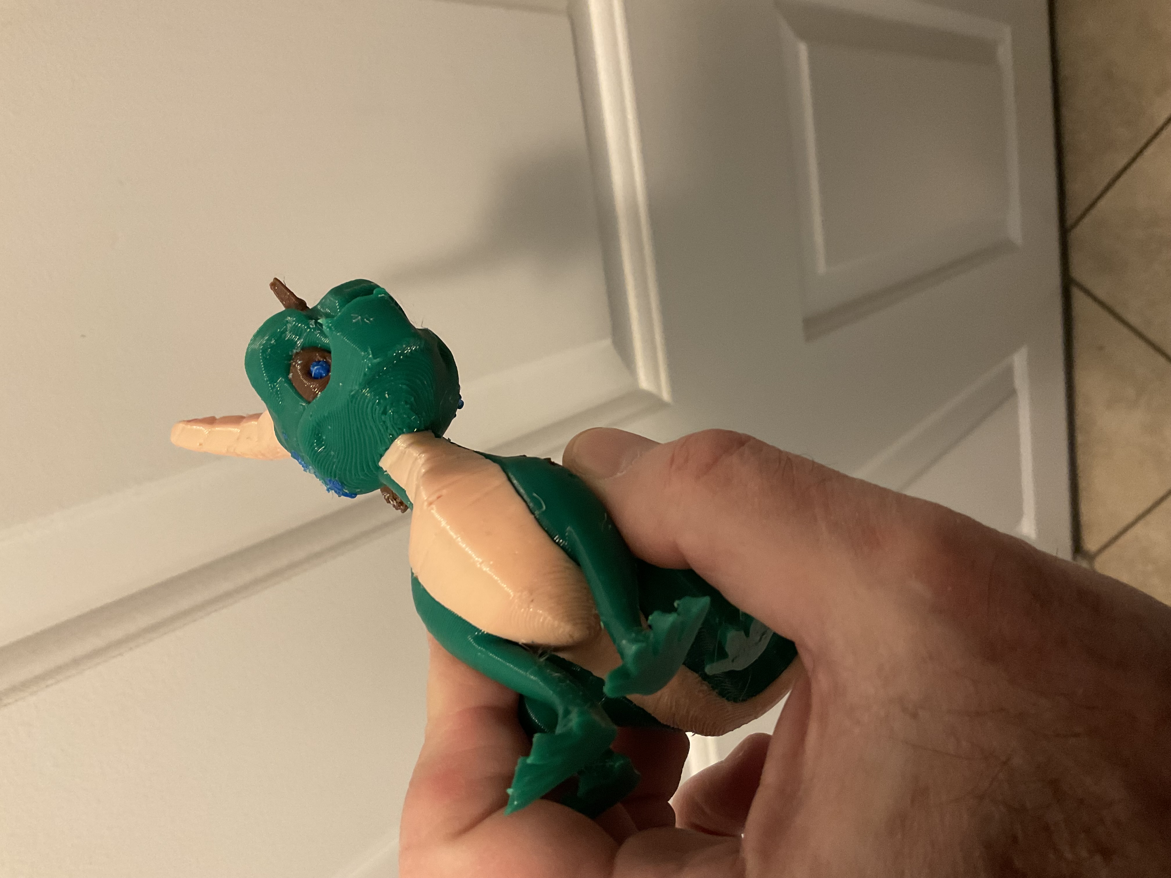

RE: Using PLA for support PETG prints
Here’s another example of full contact support. Spyro is printed in 4 colors of PETG and pla support. The pla cost about $12 a spool. Printing this using break away support is unacceptable.
yep, that looks pretty good!  Spools of BVOH and A120 certainly aren't cheap for sure, but if you're only printing the interfaces in soluble, there's really not that much used.   This is why I was looking at using PLA is the primary support structure since you can get spools of it for cheap and then just using the A120 as an interface.   I'm doing some tests with  PLA + A120 interface + PLA support today in preparation for a vader helm print I've been wanting to do but had to wait on the XL to show up lol   I think I might play some custom support stuff like you were talking about but print that custom support in A120 but as part of the model, touching it.

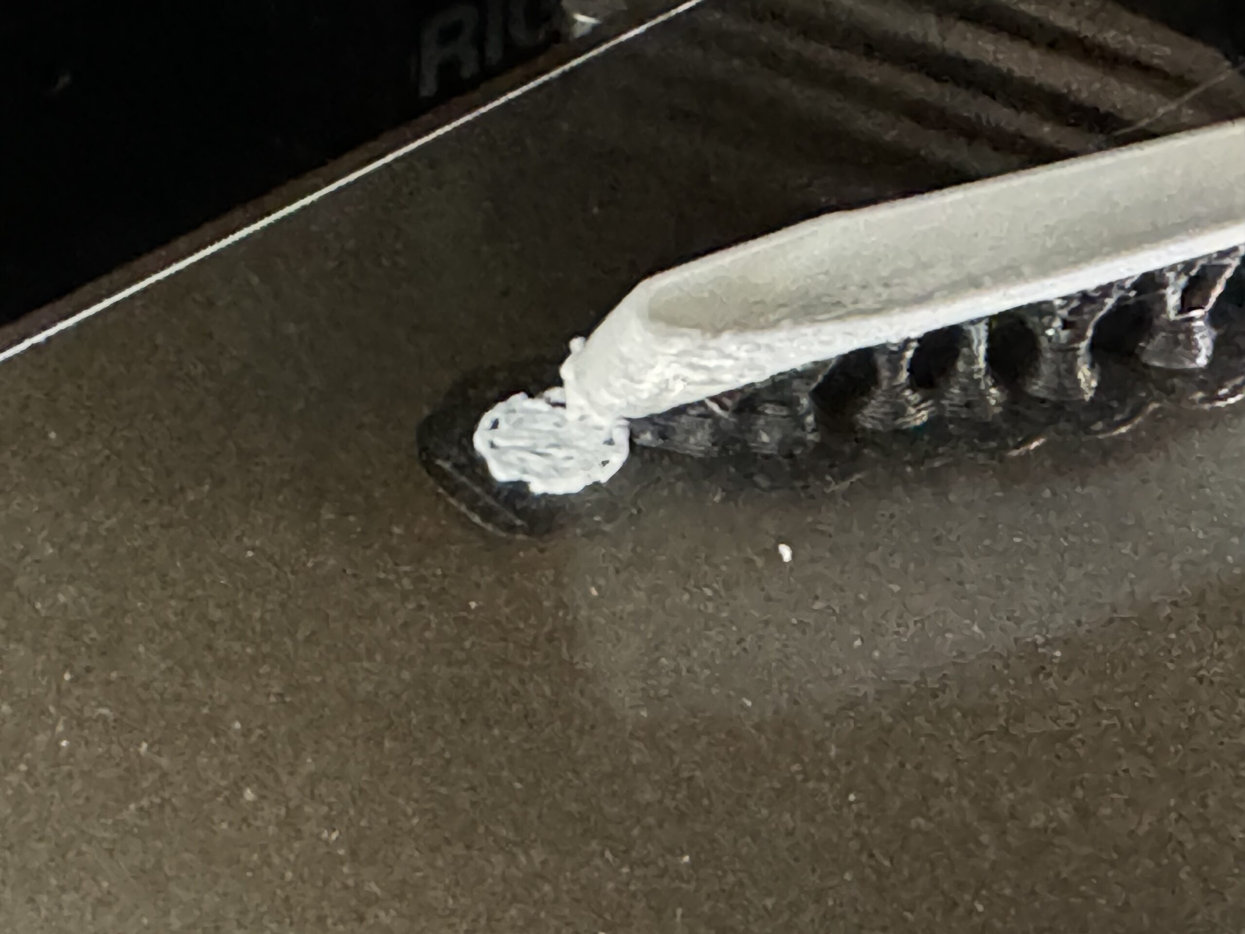

Tim Kukulski
(@tim-kukulski)
I just figured out how to keep local minima from getting swept away: "mouse ears"!
10mm mouse ear placed at local minimum where the model geometry would not have enough contact to stick to the underlying PLA
