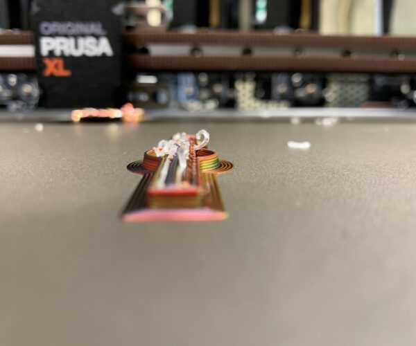

DO NOT USE PVA ULTRA.
I need to change my recommendation to the community about this material and this company. I recently purchased 4 spools of PVA Ultra from this company, and it is not the same material that I have used in the past. When printing, it solidifies and clogs nozzles beyond repair in about the first 15 minutes or so (2nd to 3rd layer usually). This is using the same recipe that I have used successfully in the past. All material is properly dried in a dedicated oven.
Attached is a picture of an attempted test print that is not even using extruder changes. The test print using the exact same gcode runs flawlessly with 3DX-Tech Aguatek PVA also shown.
The company refuses to acknowledge my request for a return/refund, and I had to initiate a case.
